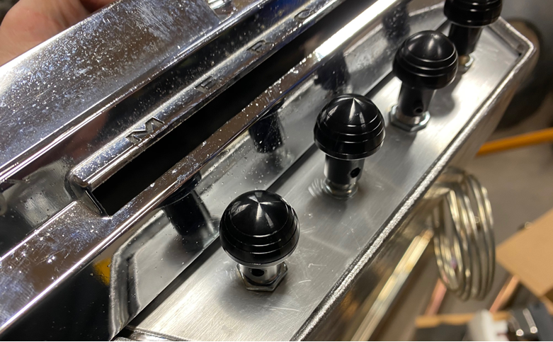

    "Cool" thread :cool: and timely since I just had my system charged yesterday in the wife's PU.
    I installed Vintage Air Heat/Cool/Defrost and tucked it way up under the dash so I didn't have to look at it. Rather than plastic vents that look out of place, I used a Mercury under-dash AC, well actually just the chrome facia. I built a steel box to hold it,
    ran the VA hoses in through the back and welded up a control panel on the bottom that looks like it would have had as add on AC.
    I textured powder coated the steel, re-chromed the grille and everyone thinks it is an old Merc dealer installed AC. Baby blows cold!

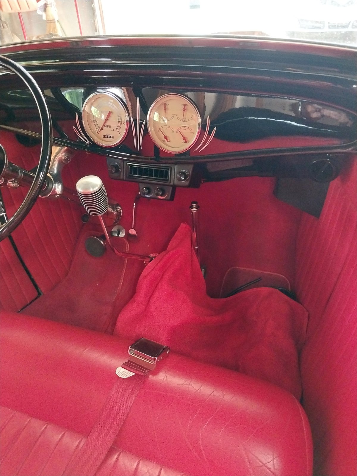

    I have the black highboy with Red interior. Yes, the air blows on us for maximum comfort. I used everything in black, so as not to draw the eye to the A/C.
    If you look closely at the photo, you can see the center vent and controls and the p***enger vent. There is, of course a black vent on the driver side, also.

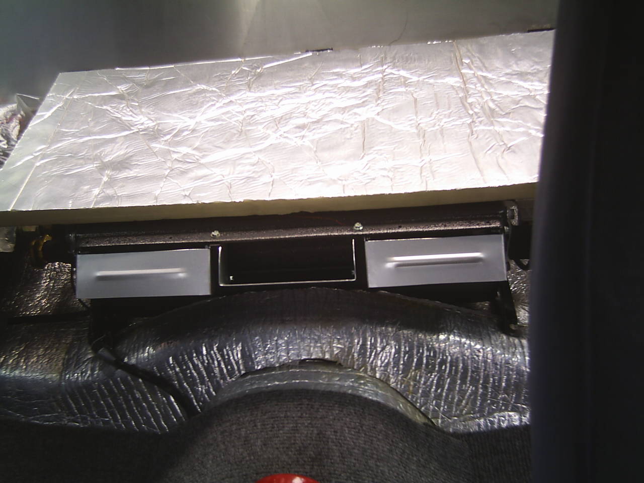

    seb fontana
    from ct

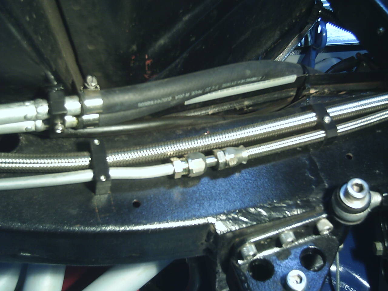

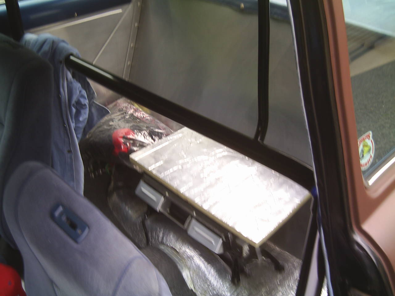

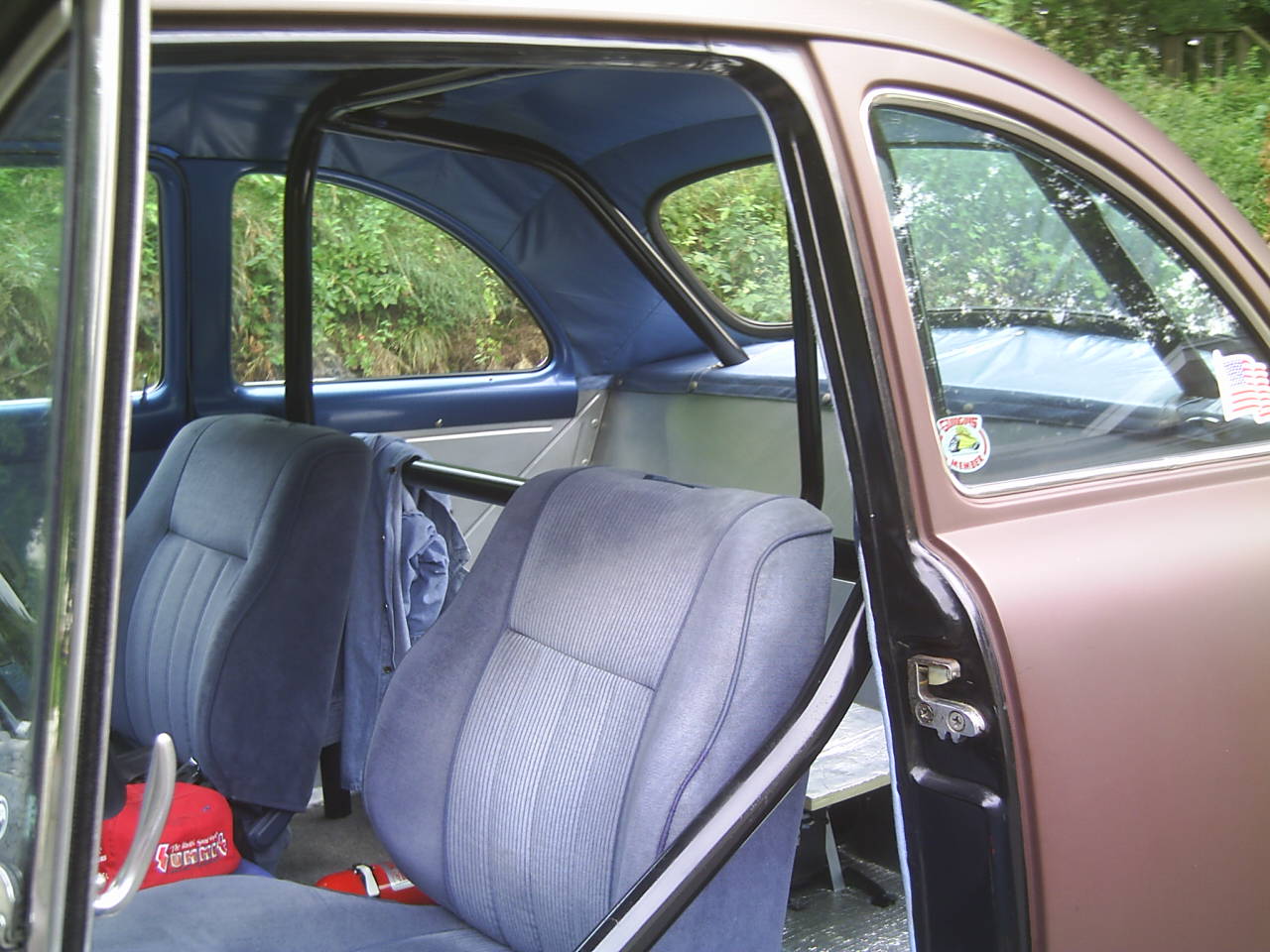

    I mounted a Vintage Air under dash air/heat on the floor behind the seats. Only vents are at the unit aimed forward no ducting. Air comes out at 42° last I checked. End vents adjusted to aim air into/under seats and center between seats, upwards for about shoulder height. Heat works well too, not much windshield fogging, if any appears cracking a window clears it. car pic 012.jpg 51 New Pics 008.jpg 51 New Pics 009.jpg 51 New Pics 007.jpg car pic 005.jpg

    Roll cage and AC? I think we could be friends.

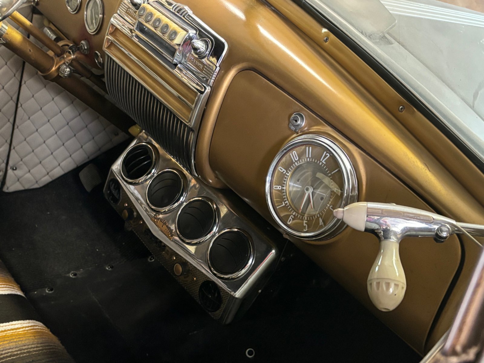

    miker98038

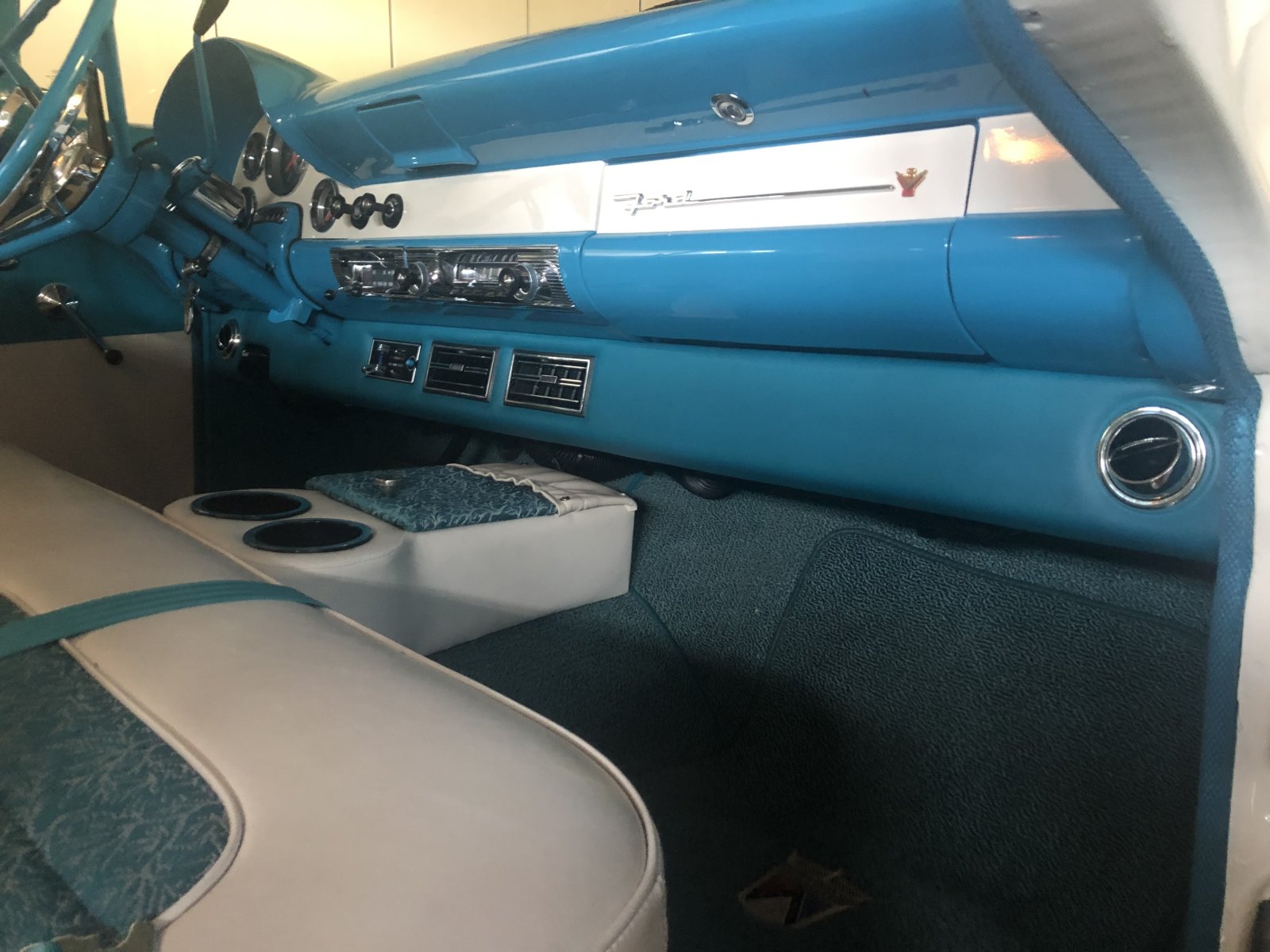

    Space being tight, I had Ace Custom Equipment in NZ cast a little waterfall panel for my dash. The old Haneline did the engine turning that matched the dash panels they did for me. The unit in the p***age side is tucked up tight. The drivers side folds up so I don’t have to deal with it getting in and out. Sitting in the car, the side units aren’t so obvious, and the waterfall paint does match the dash. IMG_0674.jpeg IMG_0670.jpeg IMG_0015.jpeg
    41 GMC K-18, y'sguy, skooch and 4 others like this.
  9. Hard to see, 4 round vents, center ones just outside the 3 guage panel 20240528_140242.jpg

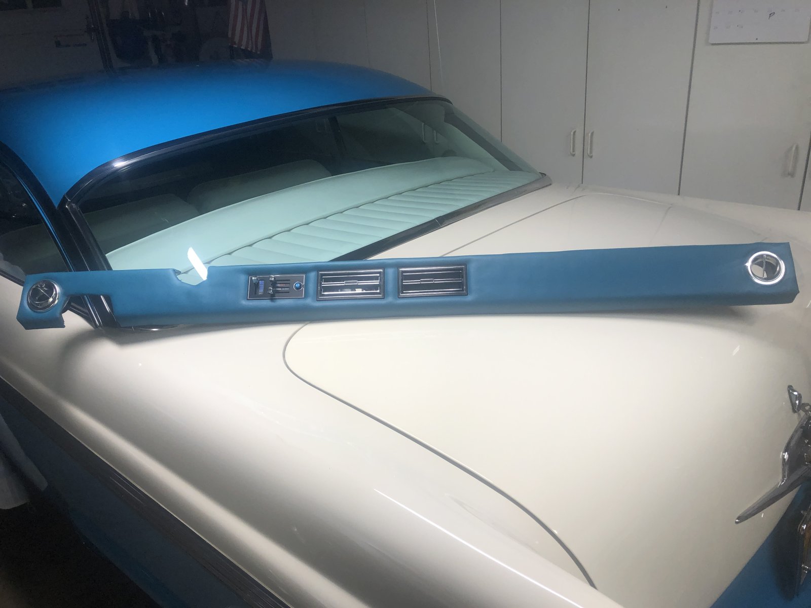

    jimmy six

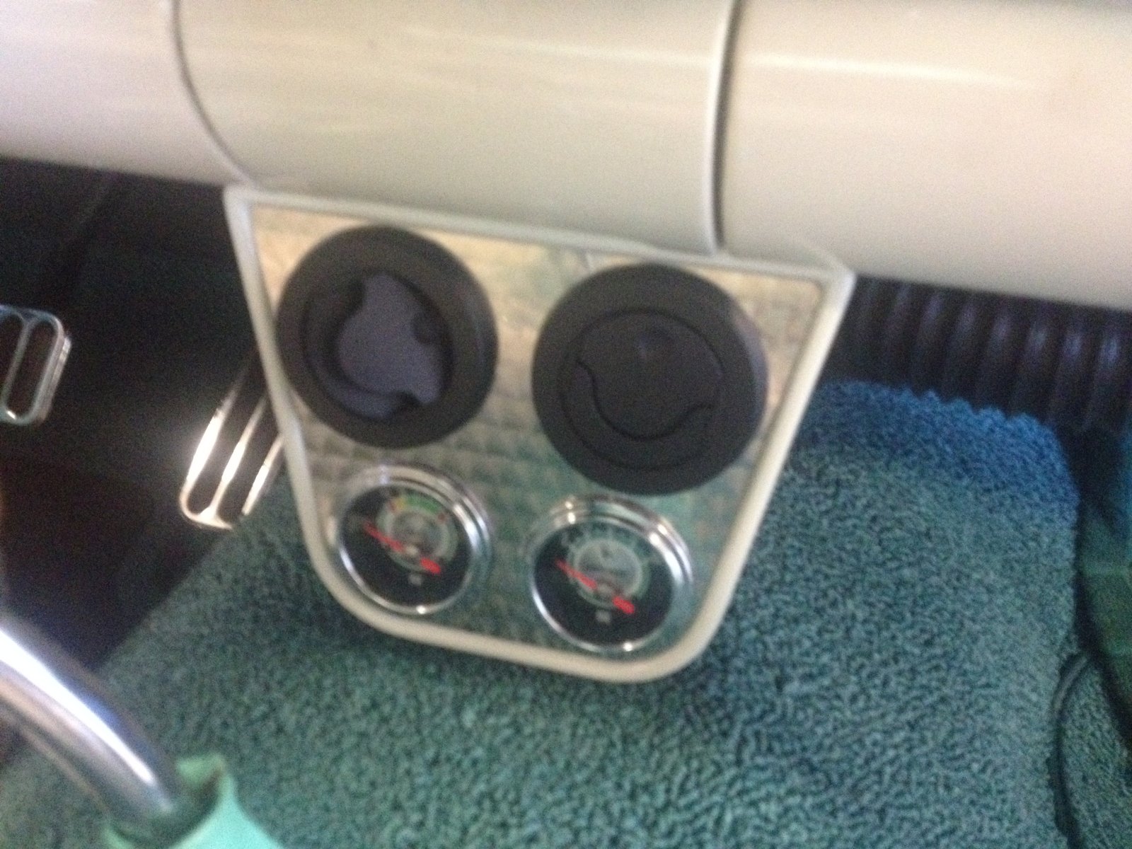

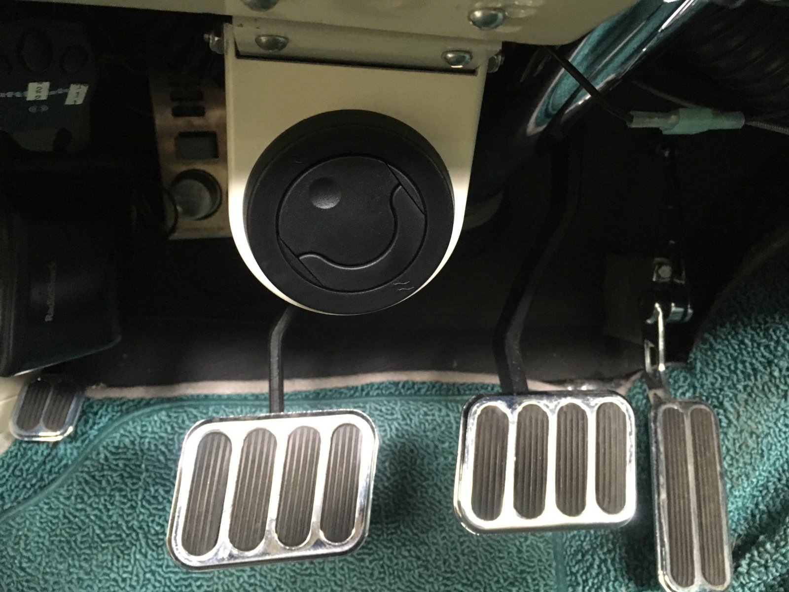

    Made mine. The shop doing the under hood work gave me the electronic controller and the vents I wanted. Aluminum plate has a 90* bend on top and a 45* on the bottom for strength. 1/4” foam under the vinyl trim. Made a cardboard template first. Two 1/4” studs hold it up…. IMG_5560.jpeg IMG_3882.jpeg
  11. 57JoeFoMoPar
    Joined: Sep 14, 2004
    Posts: 6,503
    57JoeFoMoPar
    Super clean install. Looks great and functional

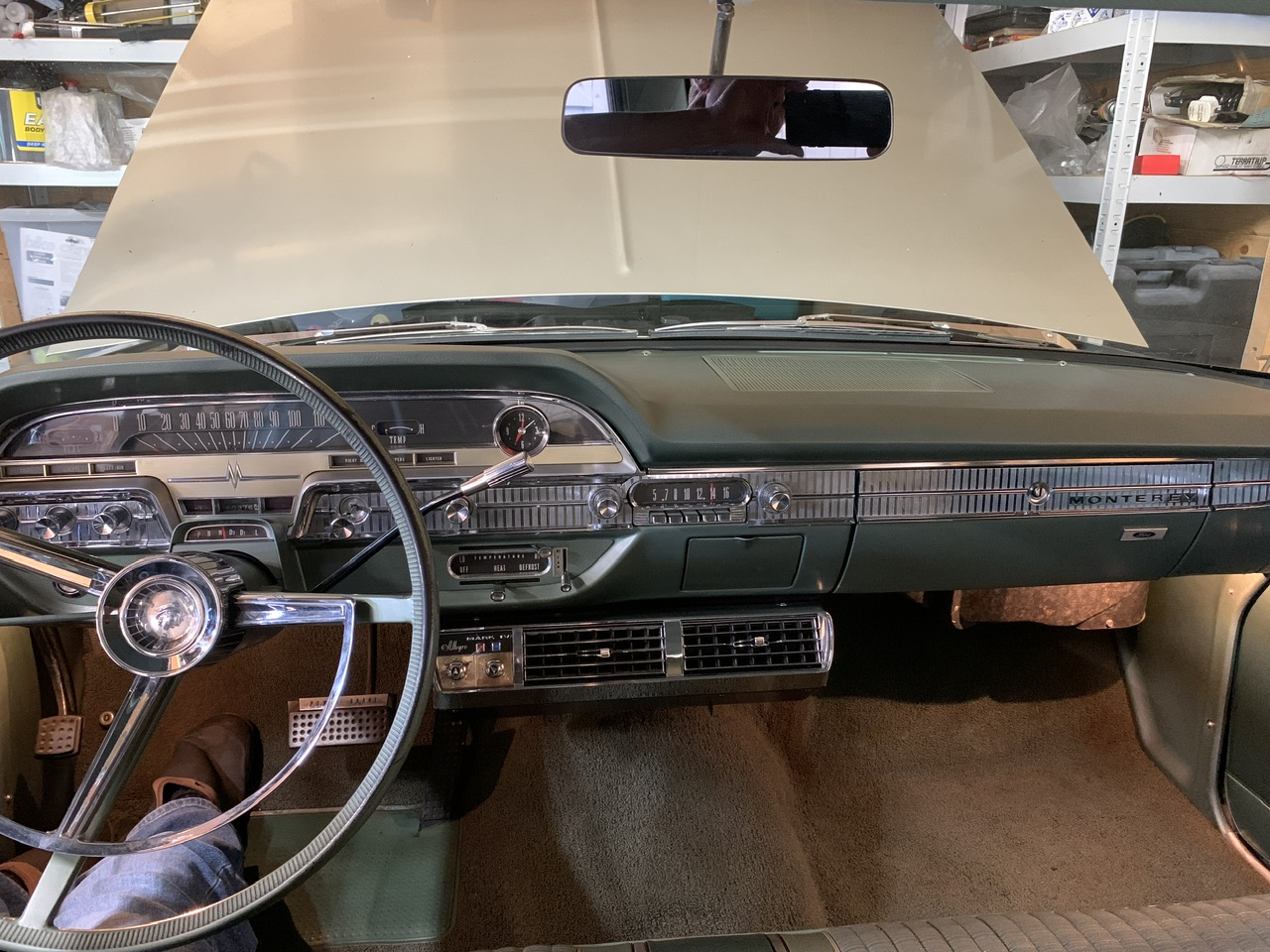

    I didn’t do it, this is how it came, original mkiv under dash unit in my 62 Merc, I think it works well as it’s of the period, the under dash units don’t look so good in a 32 Ford for example

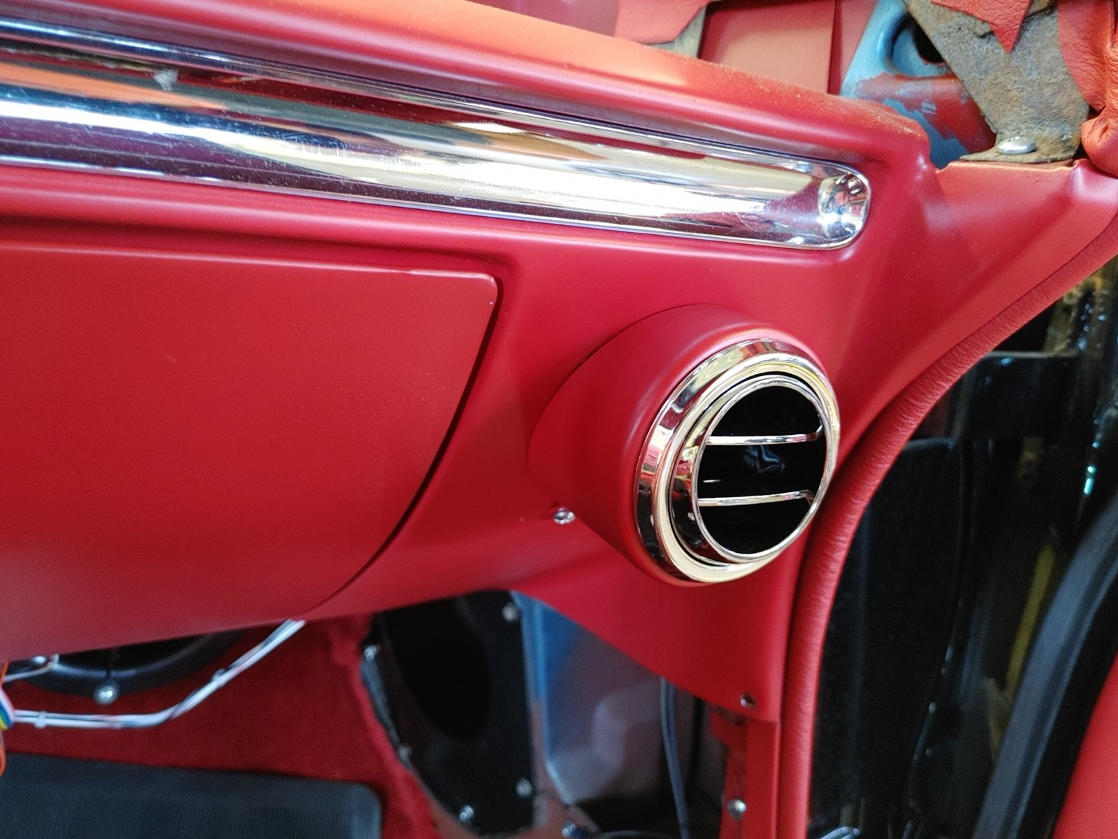

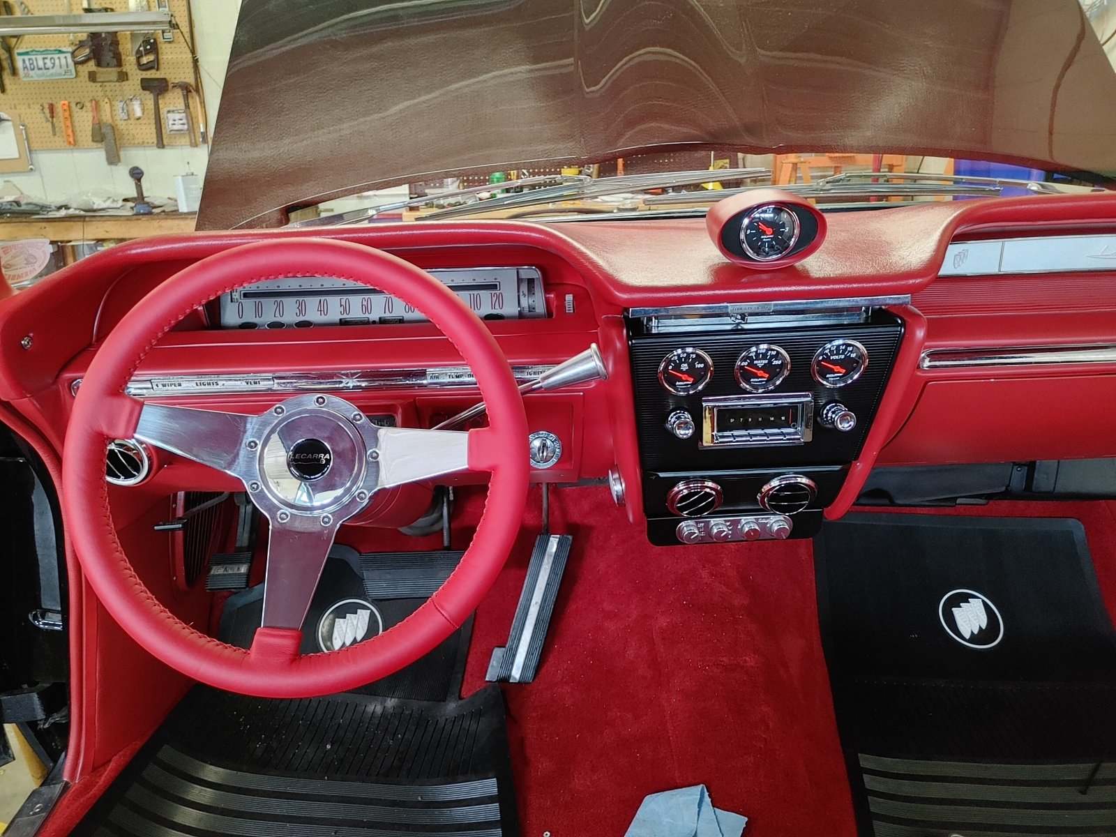

    Joe, I've done several installs and I've bought cars that tried to blow through the speaker grill. This never works well. That grill was designed to flow music, not air. I've used the under dash pods and they work well but aren't esthetically as nice as I would like.
    On my 61 Buick, I decided to do a better job. I installed a VintageAir Super that just barely fit behind my dash. After looking at and pricing the OE Buick AC vents, I decided I could do better for less. I custom made the side vents from 3" exhaust tubing and installed VintageAir louvers.
    In the center, I installed VintageAir louvers in the door that used to hide the ash tray. I also installed gauges and a stereo in the center "console", made a panel for the controls and had it all powder coated semi gloss black. Here are a couple of pictures. I will see if I have more and post them later.

    That reworked dash center looks great and is much more practical. I like the side pods, too.

    The Mark IV really is a cl***ic look and it's outrageously effective.
