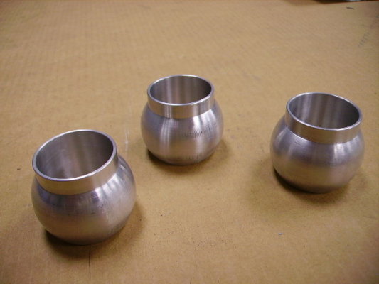

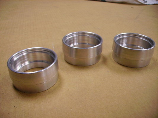

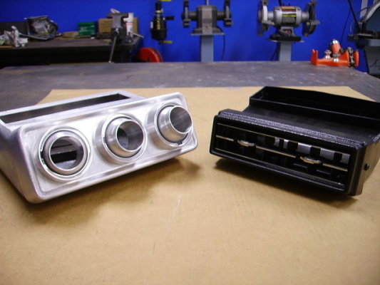

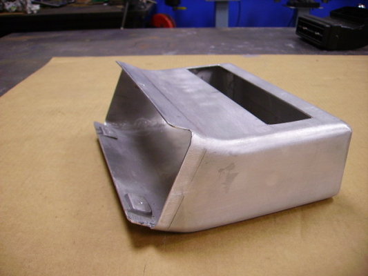

    I couldn't live with the plastic center vent that came with the Vintage Air kit for my 55 Chevy, so I made a new center plenum and machined three swivel outlets that matched the factory style vents on the dash.
    393694821.jpg 393694822.jpg 393694825.jpg 393694827.jpg View attachment 6104135

  10. williebill
    Joined: Mar 1, 2004
    Posts: 3,482
    williebill
    Looks great!
    seb fontana and Algoma56 like this.
  11. 57JoeFoMoPar
    Joined: Sep 14, 2004
    Posts: 6,502
    57JoeFoMoPar
    That's a huge improvement. The one that came in the kit looks like ***.
    I think this post is especially representative of what I was trying to accomplish with this thread. We can get these aftermarket air conditioning set ups and units, but there is seemingly no consideration by these companies about how these products are going to look in the car once installed. Here, a cheap and modern looking part was replaced by something much richer looking and more era appropriate. Great work.

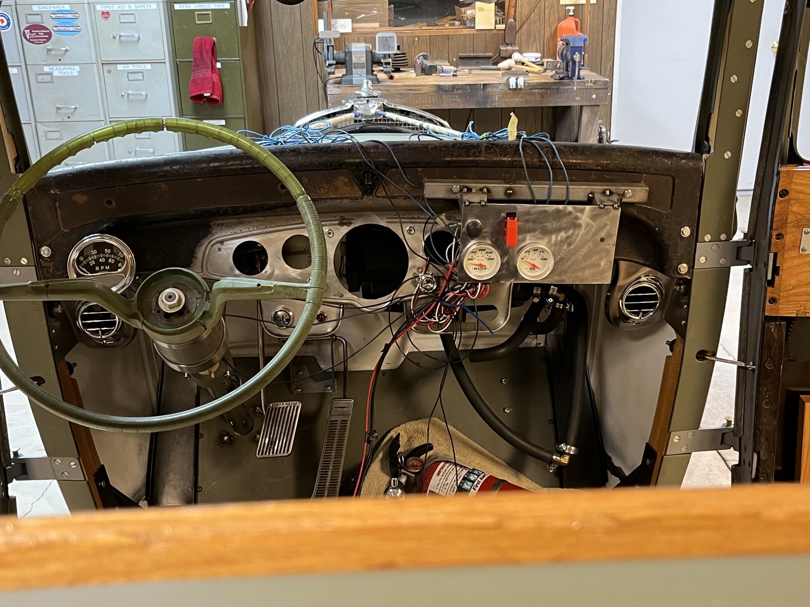

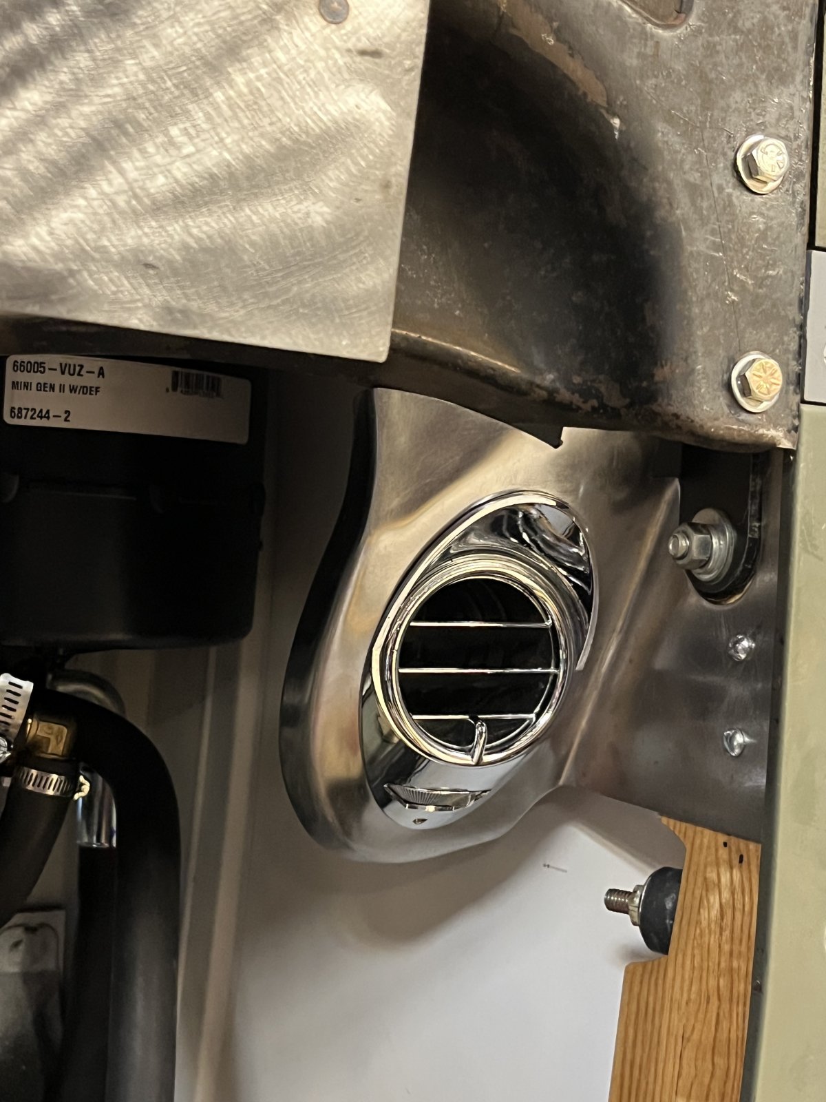

    After a year on the road, I decided it was too hot in my '33 coupe. Naturally, I ripped everything apart and went backwards to move forward. Bought a Vintage Air Gen II (I think) compact unit. Not wanting to destroy the look of the dash, I hid the controls in the glovebox; vents are really hidden; you don't see them when sitting in the car, much less from the outside. Tucked back from the face of the dash (one on each corner). If you didn't notice the condenser, you'd never even know it had A/C. Cools things off just enough.

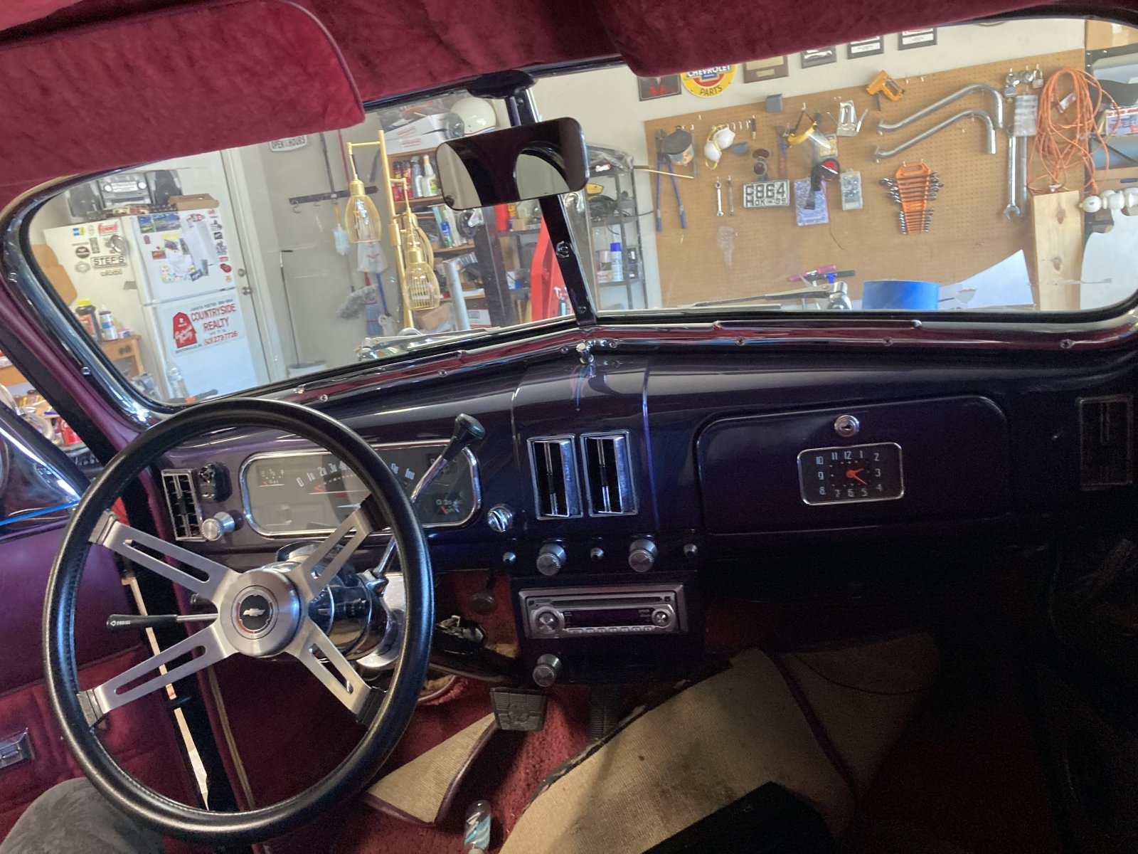

    Here’s what dad cooked up ca. 1980. I’m pretty sure the vents are from a production vehicle.
    38 Chevys had a radio and ashtray stock where the center vents are located. At some point I’ll delete the CD player for something hidden or a Bluetooth receiver
