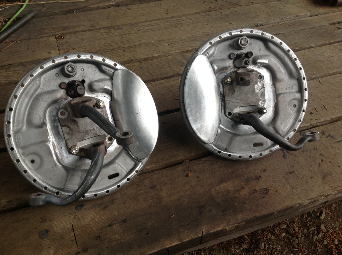

    I added some aluminum scoops and made them functional(there are a lot of holes under the scoops). An old friend told me to skip the holes In the back and make sure to add them around the rim. In the rain the brake dust and water drains out better. IMG_0894.JPG

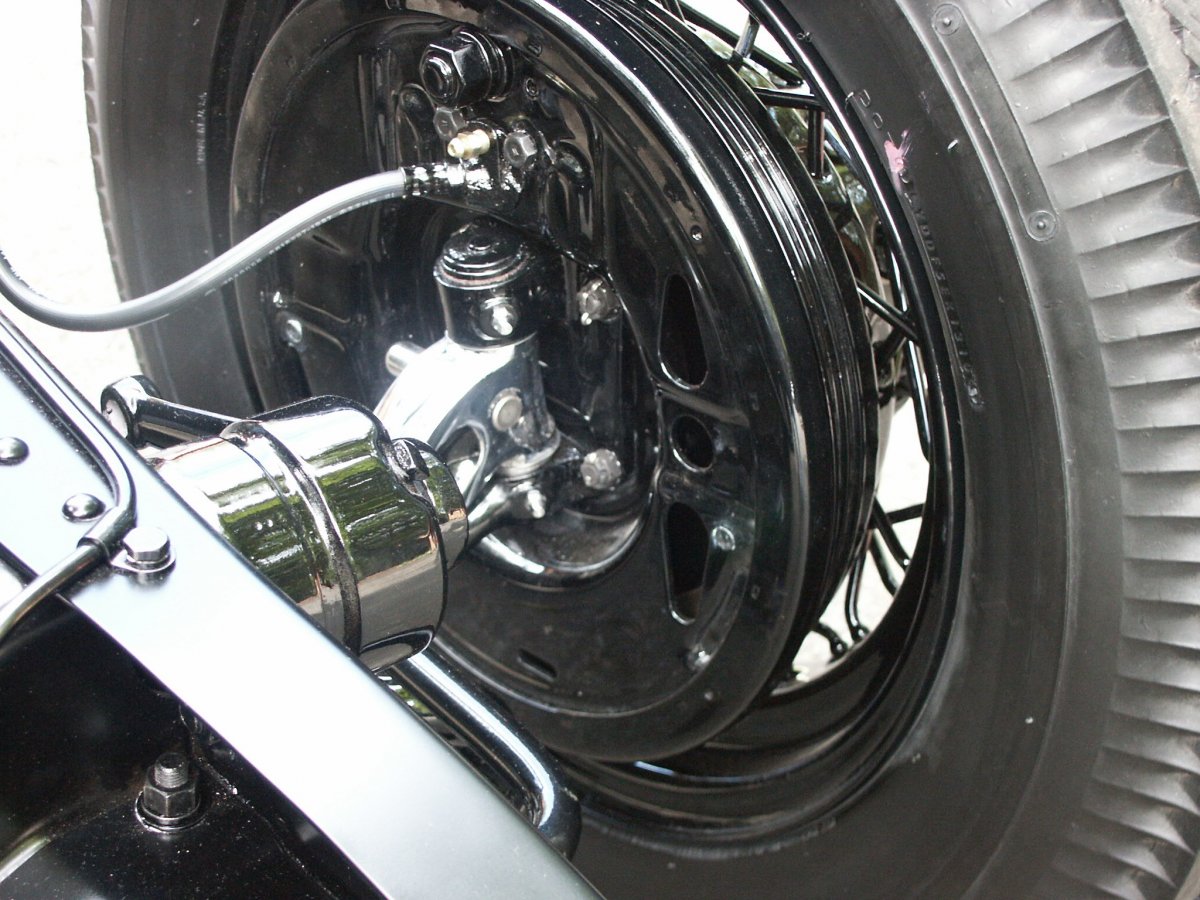

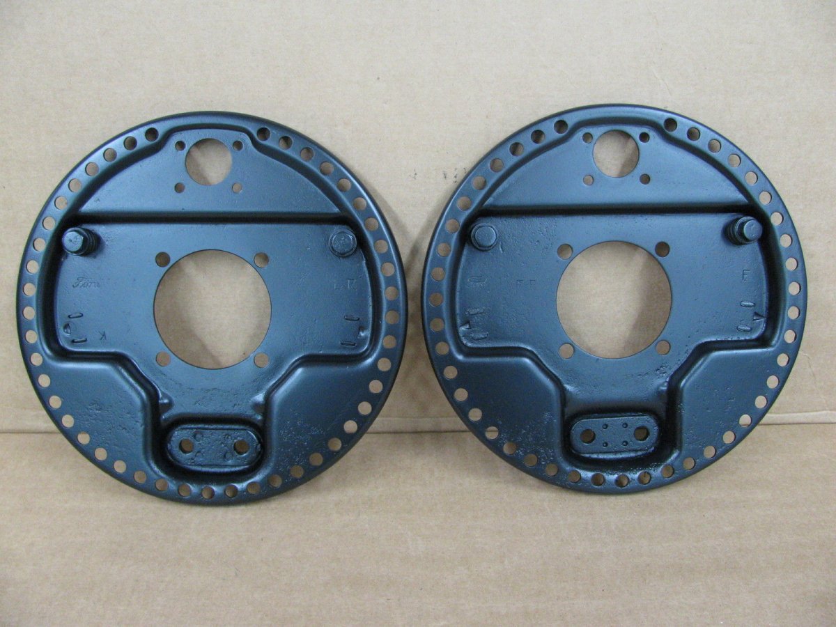

    Heres my backing plates, drilled and I like to paint the inside so I can see whats going on with the brakes stuff. 019.JPG 032.JPG
    I'll probably add a set of those scoops at some point, i think they're the tits.

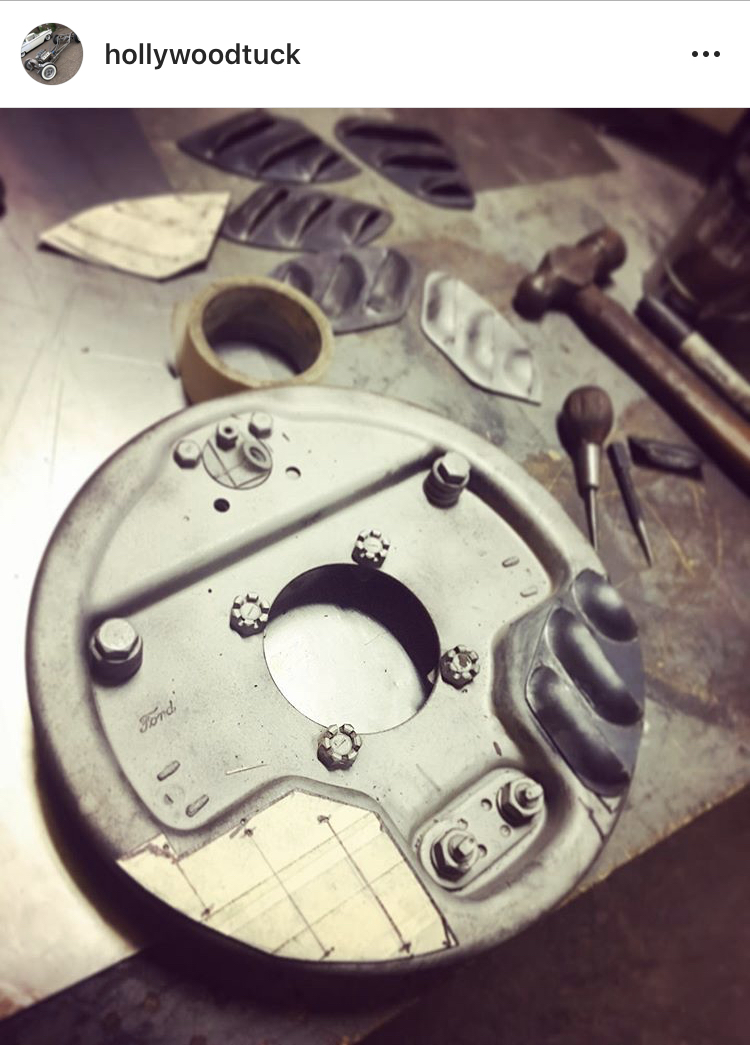

    @Tuck put some louvers in some recently and they look awesome! I’ll try to find a photo I. A little bit

    Ed Cardoza from Merced, CA made those using a cold chisel and a hammer! No press.

    I wondered how someone could press those in there without some serious distortion. Looks great.

    also I think @Tuck used a pull max to make the louvers for his

    Dumprat those Aluminium scoops look great, absolutely period for a 30s car. Where they something you made?

  17. Clever idea blowing the inside a lighter colour, I may have to follow suit. And I'm with you, those scoops are the tits.

  20. Looking good, I notice all the louvered patches in the background, were these being sold as weld ins or are they test pieces?

    As for pressing the louvers I imagine distortion's not such an issue with how thick the steel is.

    I bought the scoops at a swap meet about 15 years ago. Not sure who made them. They were made for 40's self adjusting brakes but fit the 55 bending with a few little cuts.

    Looks to me they were cut from the ends of an alloy valve cover, maybe with 3 tabs welded inside for attachment. You see useable damaged or "one missing" covers at swap meets for a few dollars all the time. I'm going to start buying these up! Great idea, I don't know if it's mine or somebody elses!

    I have a set like the ones Dumprat used, they have a name on the inside, I’ll check when I go out to the shop. I thought I bought them from Moon years ago for $90. I remember thinking that they were too pricey for what they are. Moon only sells the smaller ones like in Post #6 now I guess.
