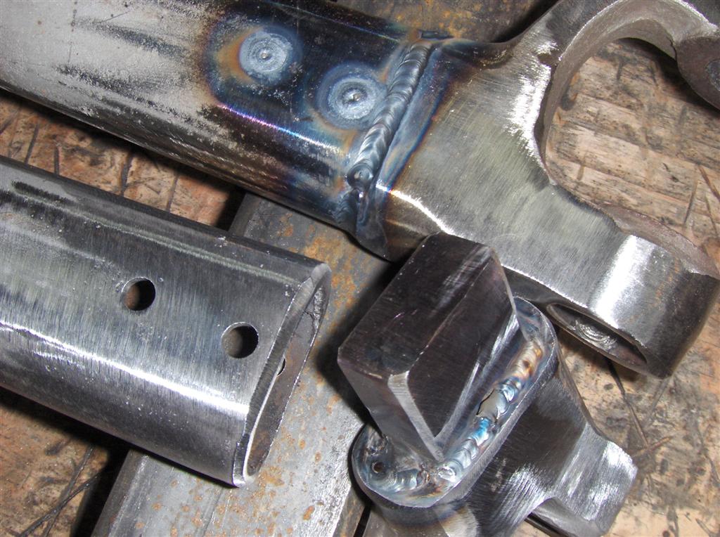

    This is a pair of wishbone clevises that i removed from some junk bones and mated to some 36 rear bones, pie cut and weld is fine as long as they are still attached. If they are detached i think this would the prefered method. The clevis is solid but does have a small cavity to recess the solid slug into just gind the clevis and bone to the same angle to get the desired degree/caster and weld all three pieces together and grind smooth.

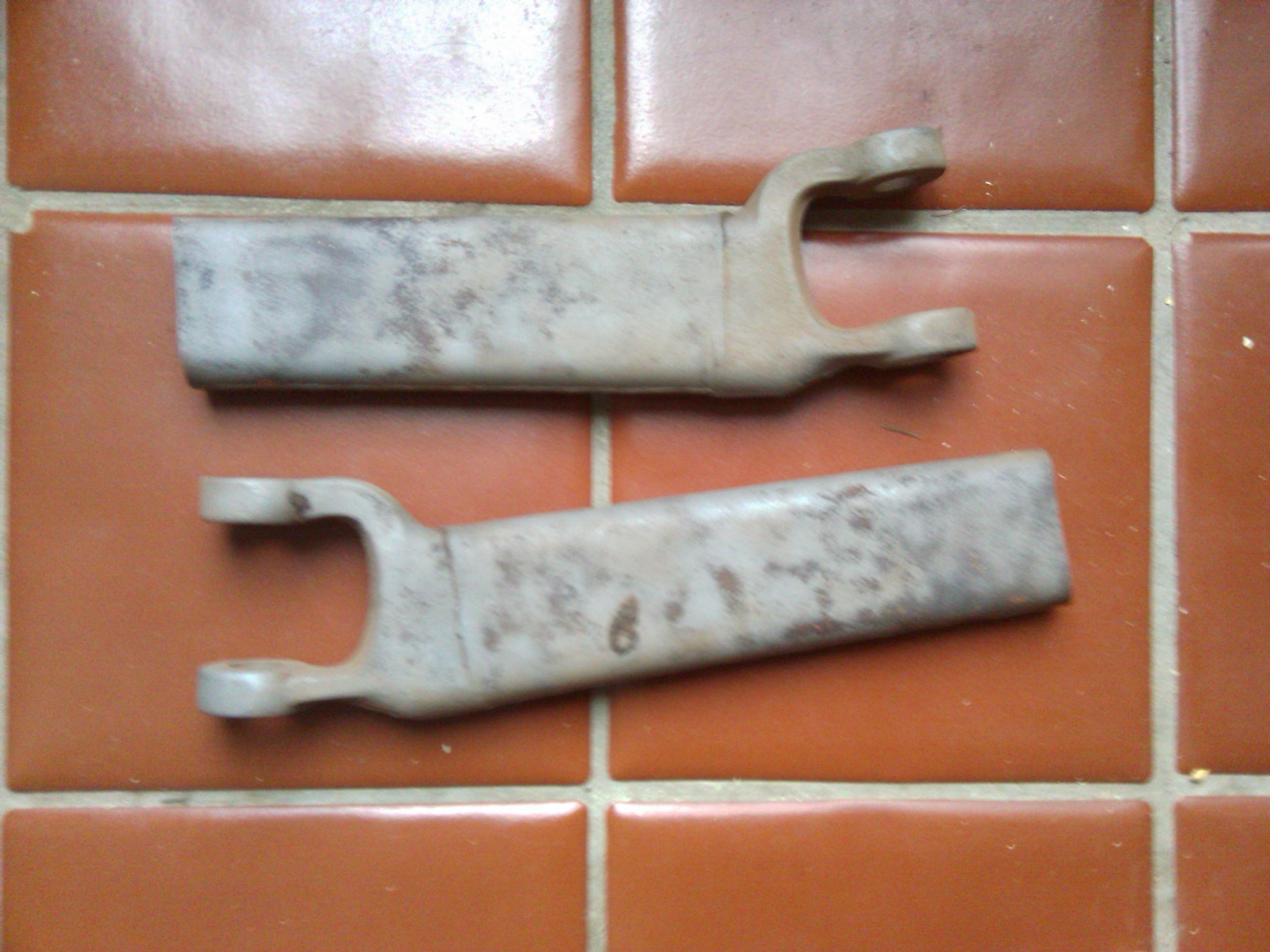

    Here you go... Three photos of JMON77's Model A.

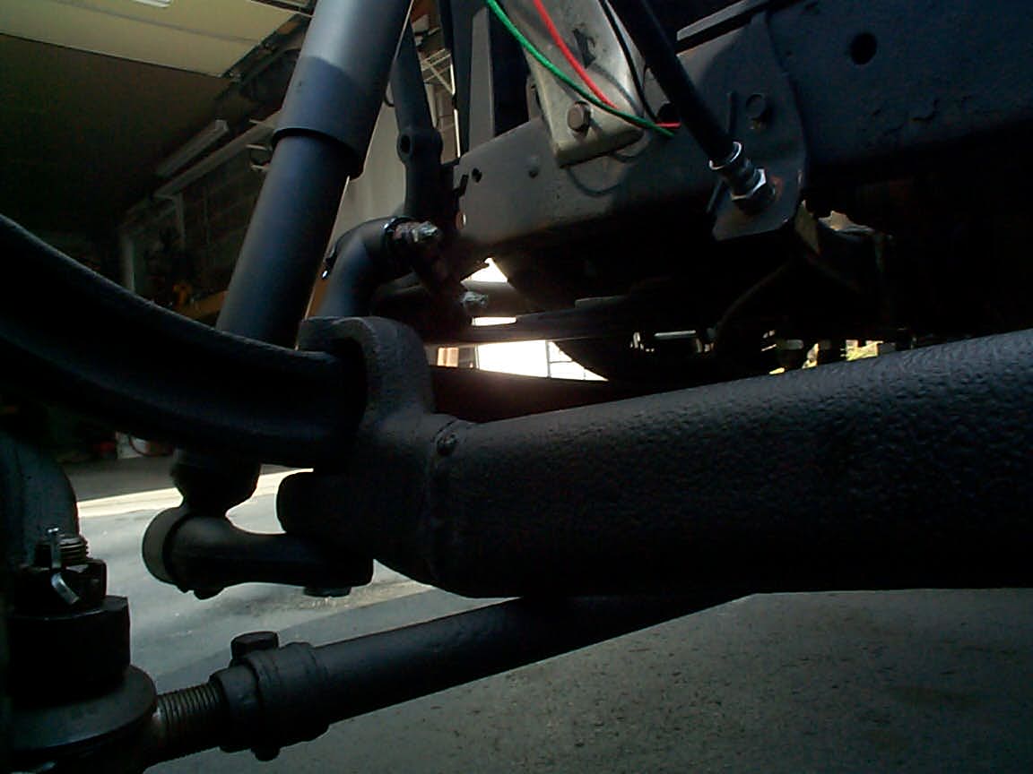

    Not stock, but here are some pictures of mine. Yes and mine are upside down also to clear my tie rod, which was not installed yet in the pictures.
    The first picture also shows the jig I used to get my angle right. Notice I changed my mind where I was going to do the cut.
