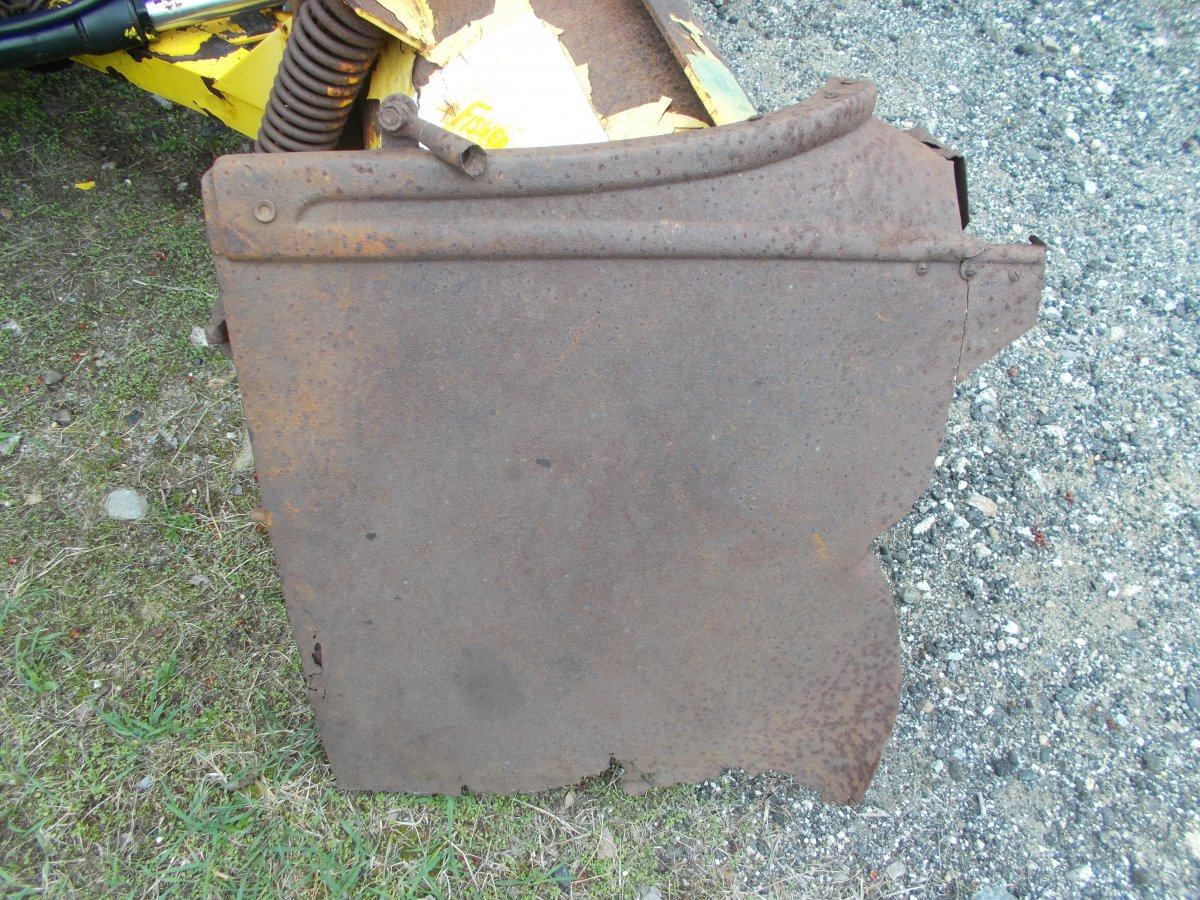

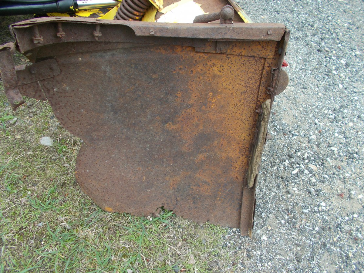

    I know you are down under, but if it helps I have the front half of a '28-'29 roadster quarter...
    free if you can swing the shipping... DSCN3069.JPG DSCN3071.JPG DSCN3070.JPG
