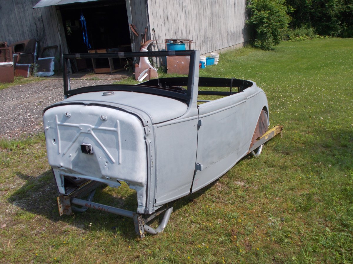

    I had a roadster cowl, a running ch***is, some random doors of off something, and sport coupe quarters, and I started piecing this one together. I had the roadster panel above the trunk lid so I knew what length it had to be, and I cut the quarters up accordingly, so the quarters would end up being roadster-length, based on the length of my randomly found doors.
    This is what it looked like when I sold it, still pretty rough but the idea was there. I think once you mock it up, you'll figure out where the cuts need to be made. I don't like the pie cutting idea, I think you just need to move the tops of the quarters in and extend the quarters equally.

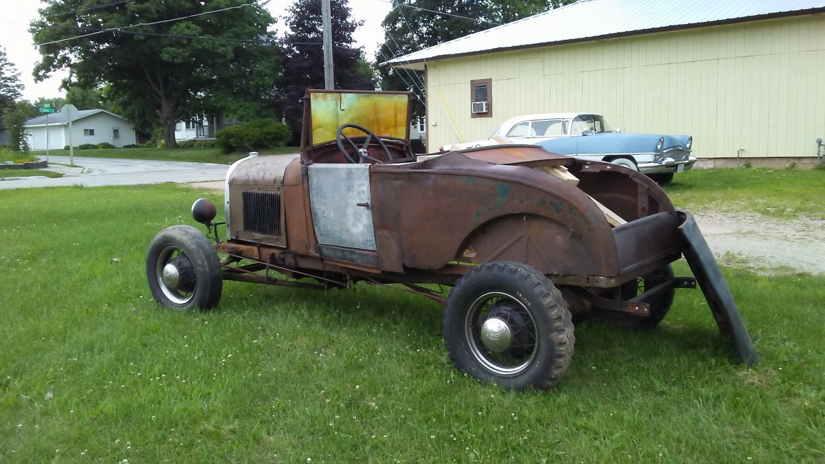

    I have a similar pile of s**** sheet metal so I understand the struggle. I know if you cruise the hamb it seems like lots of guys are doing this but in reality to almost everyone else besides you, me and @wheeldog57 @sloppy jalopies it is nothing but s**** and if you cobble it together it will look like just that to most buyers. You may or may not have noticed that beyond the length, height and lack of upper body bead there is one other often overlooked issue...the body line beads are different. The roadster body line bead is round the coupe/special/sport bead is flattened. ***umptions get made because they "look similar" and use the same trunk lid but other than the shape of the area where the trunk sits (on coupes it sits lower) they are a different animal. Here's my 2 cents using rdstr doors on a coupester is a waste theyre rare (if you have 'em sell 'em they're worth a good buck) the idea of adding length to the 1/4s is a good way to drive yourself nuts you'll still have the flattend bead and the lower trunk position to give it away. Use your coupe door outers and narrow the jambs to the thickness of a roadster door, cap them (don't forget the curve) and build new inners ( or set the old inner in the narrowed jambs) next and most important build a combing around the back of the seat area similar to the roadster that makes up the height between top of doors and quarters, use the rdstr cowl posts and hinges and coupe above (with added combing) and below trunk panels. A nice finishing touch would be to add the body bead at the bottom of the coupe doors & 1/4s like the rdstr at this point you'd trim any excess height from the bottom not by extremely invasive pie-cutting
    this is a '30-1 coupe *** with a '28-9 rdstr cowl it's a bit easier because they already have the bottom bead (but also over wheel wells) and round upper like 28-9 rdster

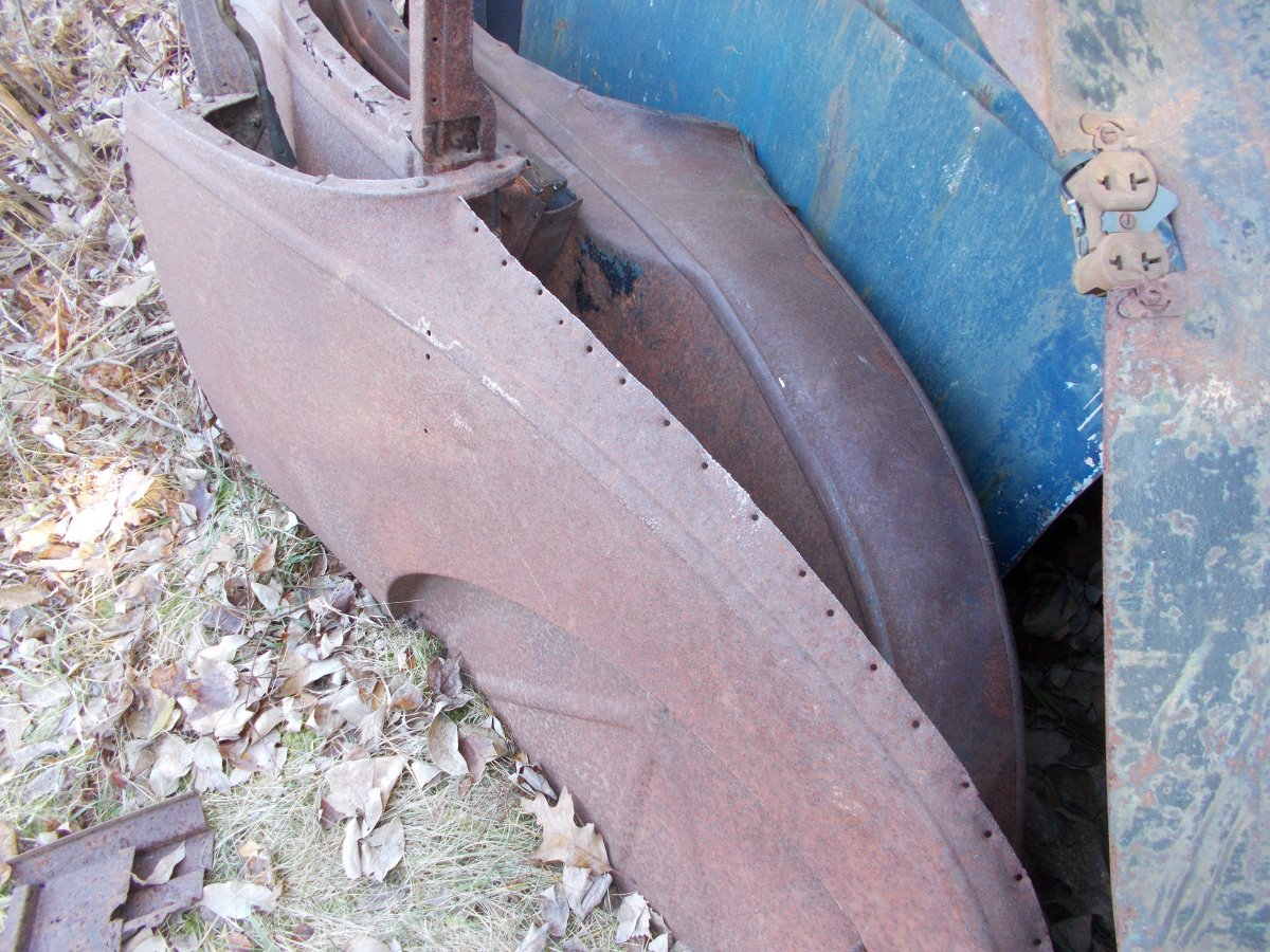

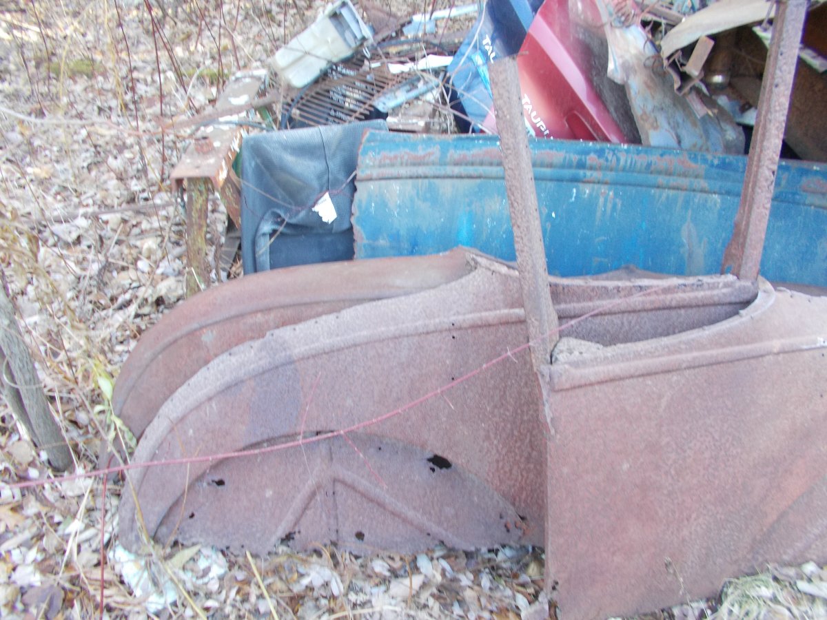

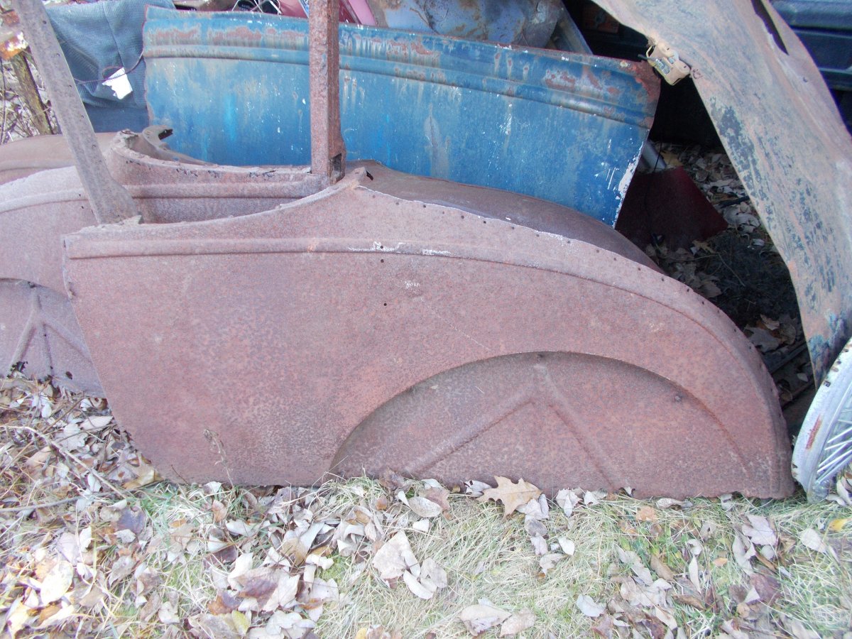

    Pretty much all that are left in the woods and fields... '28 -'29 sport coupe quarters...
    '30 tudor cowl, a '30 fordor & a '31 coupe door [exhaust pipe door tops] and '31 cabbie quarters... you can make them fit... speed week.JPG

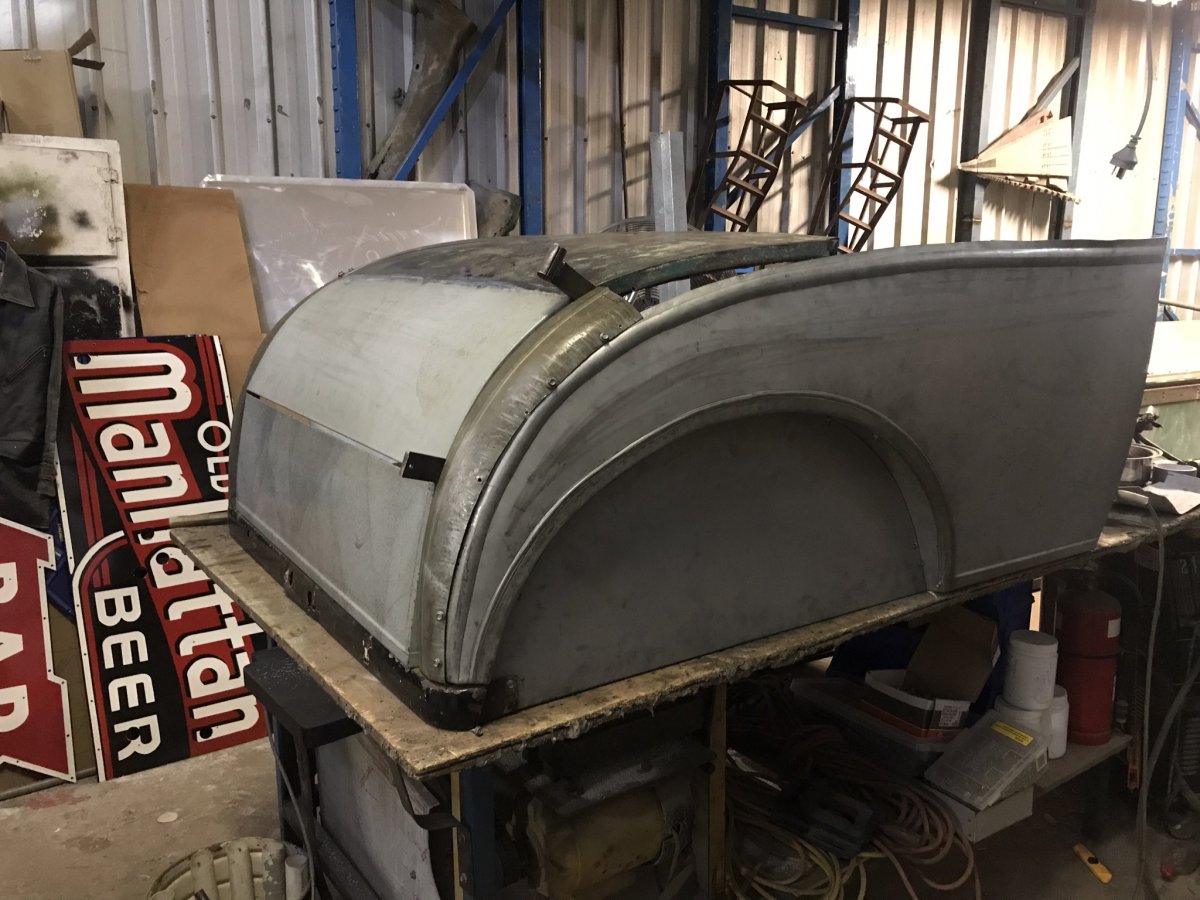

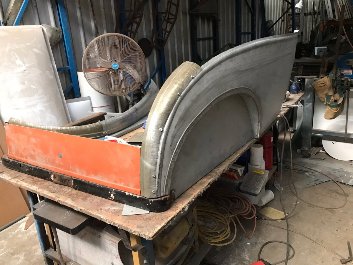

    Hey Guys. After careful consideration, I have decided to restart this project. This was what I started out with.
  29. chev34ute
    Joined: Nov 13, 2011
    Posts: 1,532
    chev34ute
  30. chev34ute
    Posts: 1,532
    chev34ute

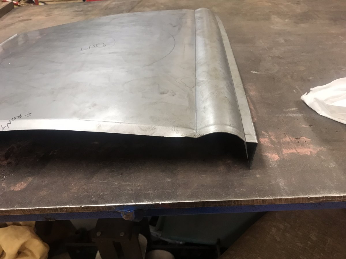

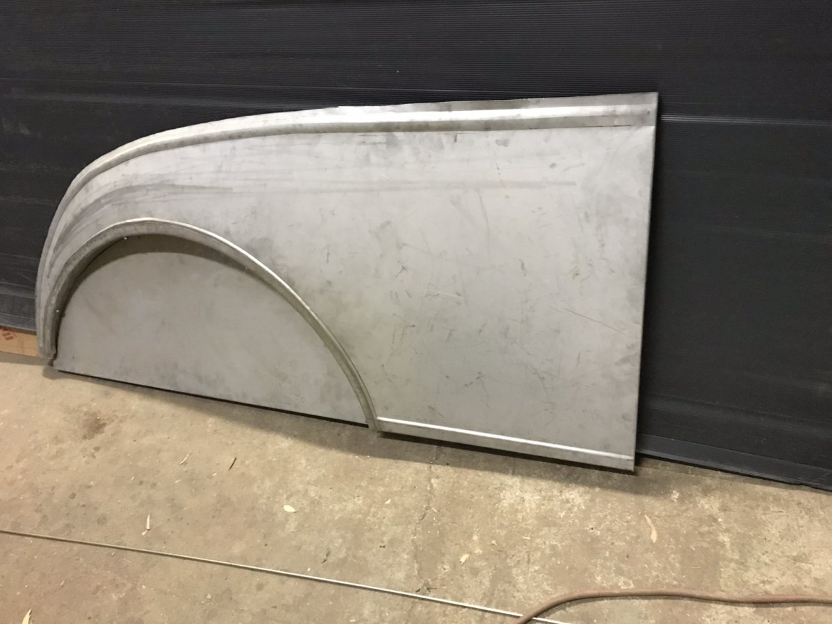

    It was basically junk, the doors were beyond repair and the cowl had major damage at the base. Last week I tore the cowl down and started repairs. At the start of the post I asked if I could modify the quarters to suit roadster doors, but since the Roadster door are stuffed, I have has a re think. I have decided to make the doors to suit the quarters.
    As the coupe quarters are taller than Roadster quarters, I have thought about mildly channelling the quarters to bring them into line with the beltline on the doors. I know I will have my fair share of detractors over the idea which is why it just an idea.
    Nevertheless it worth the thought as the wheel wells are rotted out at the base anyway. This time I thought I would try it out with a couple of models. Both are 1:25 Scale. The Revell 1930 Coupe and the AMT 28 Roadster.
