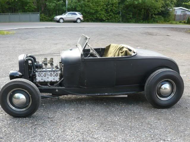

    user1796_pic92188_1247636217.jpg Here is another NO-pinch.
    lothiandon1940 likes this.

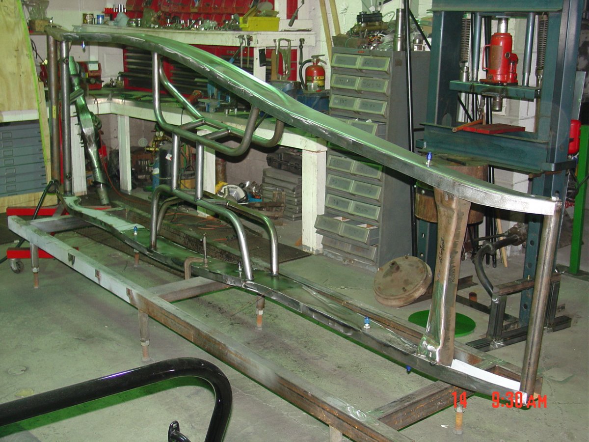

    DSC00822.JPG I actually swell them out a little in the body area and pinch a little in front so the frame follows the body, I am able to get all 4 cowl bolts into the frame. I'm welding this one as we speak, it is a Tudor so I didn't have to mess with the rear pinch. You can see it isn't much of a pinch and plenty of pedal room.
    Now, I just gotta find that guy that gave me the plans sideways and have a word with him!
