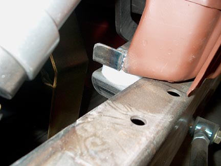

    The pic below shows how the 31 cowl/hood welting area lines up with the (stock width in this area) 32 frame.
    Once the hood sides go on, they trend narrower to meet up with the grille shell anyway so I don't see much of a problem.
    Keep in mind that the A frames (28-31) are all the same.
    What may help you is having a 30-31 owner with the engine out shoot a measurement across the bottom of the cowl/hood welt area just above the frame so you could compare that with your 29 measurement.
