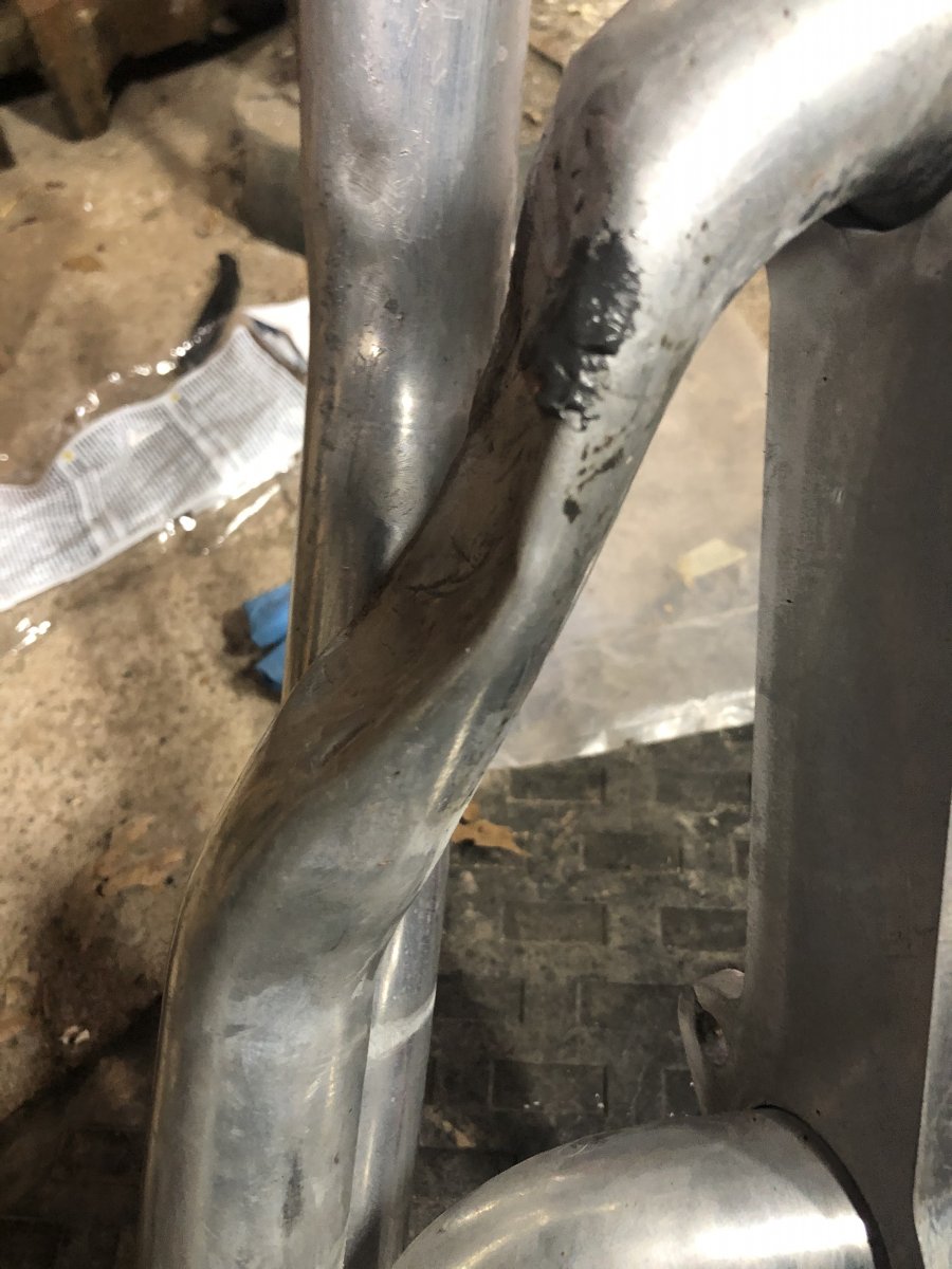

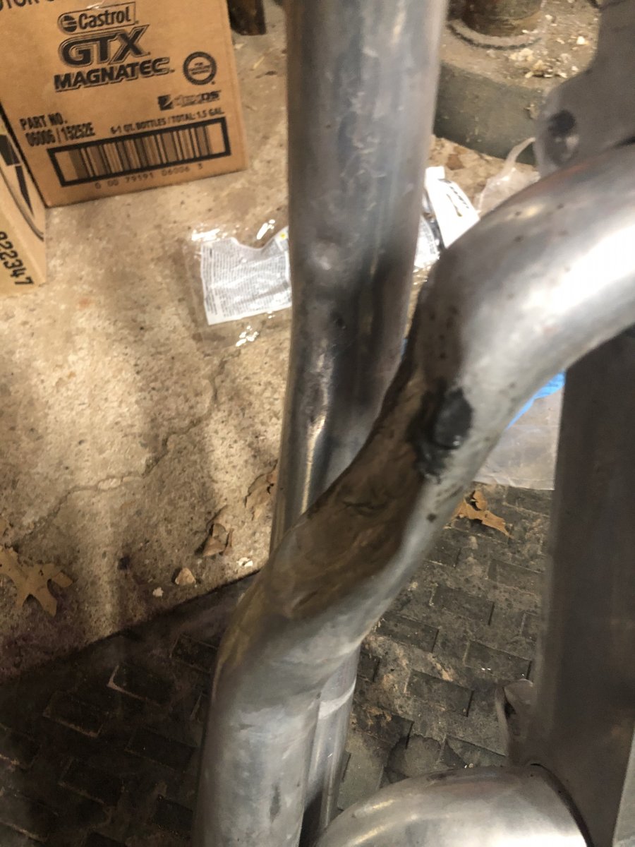

  16. Montechris
    Joined: Nov 15, 2004
    Posts: 529
    Montechris
    Here is how bad they are bashed to fit (and it still does not really fit)
    I think these are too smashed to run but what do you think?
    roadkill beat that header but they didn’t beat it this bad where a single tube is significantly blocked.
    I got these used so a return is not possible.
    Chris
  17. Bandit Billy
    Joined: Sep 16, 2014
    Posts: 16,101
    Bandit Billy
    That's the center tube? It is already doing the job of two cylinders due to the Siamese exhaust ports, I wouldn't run it.
  18. Montechris
    Posts: 529
    Montechris
    Yes, and that’s a good point I didn’t consider.
    not sure how Sanderson is getting 550$ for these things... the only thought i have is that maybe you could run a taller motor mount to get the engine up.
    Chris
  19. BJR
    Joined: Mar 11, 2005
    Posts: 11,343
    BJR
    I wouldn't run them smashed like that.
  20. If I was in this situation, and didn't want to run the header like that, I would buy a couple of mandrel bends, or in a pinch, go to an exhaust spe******t with a bender, and bend a tighter angle starting closer to the header flange.
    Doing some judicial cutting and welding, (torch, TIG, or MIG), and you could easily overcome the problem with the bends. If you have ever looked at hugger headers, they are bent very aggressively right off the flange for maximum frame clearance.
    I have had to make a modification like that several times, and on my BB powered 55, the modification looks like it came that way from the manufacturer.
    Isn't that hotrodding? A succession of problems looking for an out of the box solution?
    Bob

  22. Toast! :(
  23. CNC-Dude
    Joined: Nov 23, 2007
    Posts: 1,043
    CNC-Dude
    Did you confirm it was the right header part number shipped to you that you ordered? Since you had to cave it in so much and it still needs more clearancing.....
  24. Montechris
    Posts: 529
    Montechris
    I’m going to see what Sanderson has to say.
    I’m the meantime I’m going to put these on the shelf until I have some time to fix them and run exhaust manifolds. Guess I won’t get up to 103 HP like I was hoping :).
