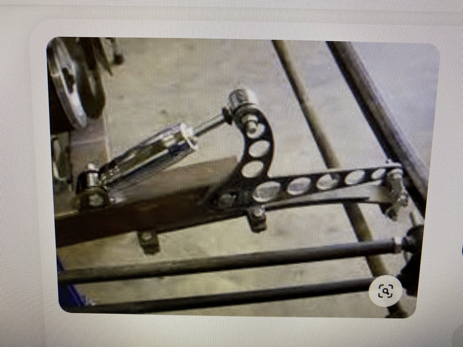

  27. 3w Hank
    Joined: Jan 29, 2022
    Posts: 1,099
    3w Hank
    Here is a application of modern shock that might can be used.
    Maybe for a pinched in frame and CC distance of the std ball for shocks and the width of the grille get to wide angle.
    -Just look over ideas for fun.
