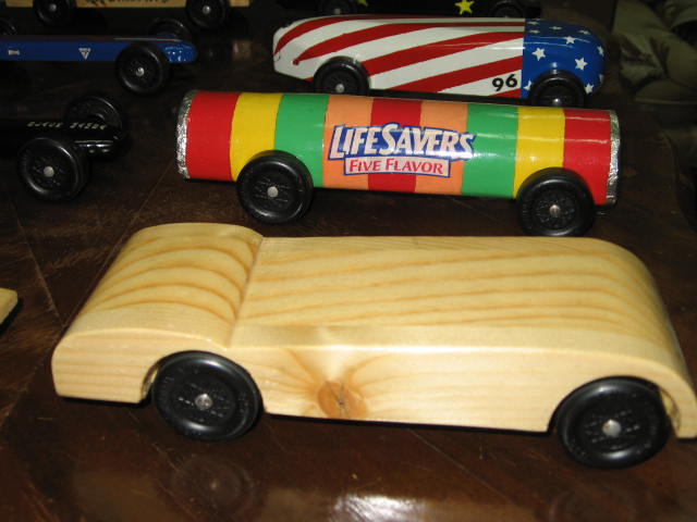

    Back when I, I mean my son, was building pinewood cars, I, I mean he, would chuck the axles in a lathe and polish them with oiled 600 grit wetordry. I, I mean he, would also undercut the head of the axle to remove the two stamping lines that are left when the head of the axle is formed. I, I mean he, would also turn down the head diameter a bit to make them round. I, I mean he, would also do the three wheel trick. I, I mean he, would also place the weight to the front of the rear axle.
    Some of the dads, I mean kids, would turn the wheels down to narrow the contact patch. In spite of this being against the rules in the pack, they let these cars run anyway. We, I mean my son, always finished in the top three in the four years he competed.
    Pics of some of the cars:
