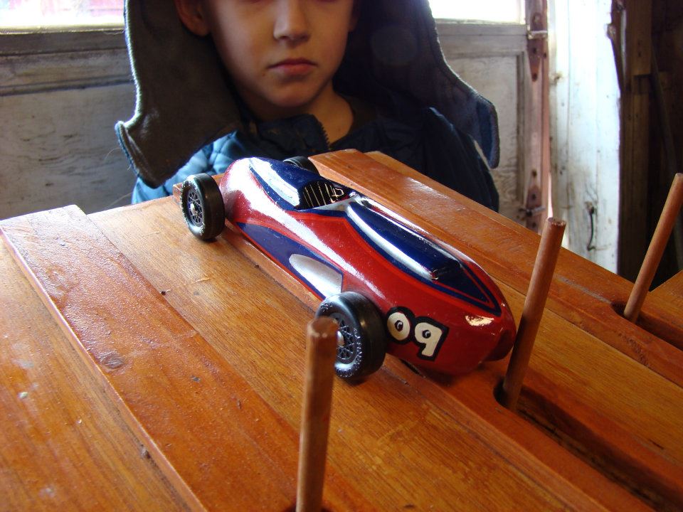

  15. I never won anything with my cars (not a single damned race!) but they looked pretty neat. Had one that was shaped like a salt flats streamliner. I guess we really just didn't consider turning the axles on a lathe or using anything that techy to win a boy scout's contest.....I sure as hell didn't know how to use a lathe when I was 10....jus sayin....
    We used shotgun shot for weights. We just drilled into the bottom with a 1" hole saw and mixed up some 2 part epoxy and mixed the shot into it. Then just poured the mix into the holes and smoothed it out. We were able to weigh the shot pretty easily before we mixed it so we could get right on the limit.

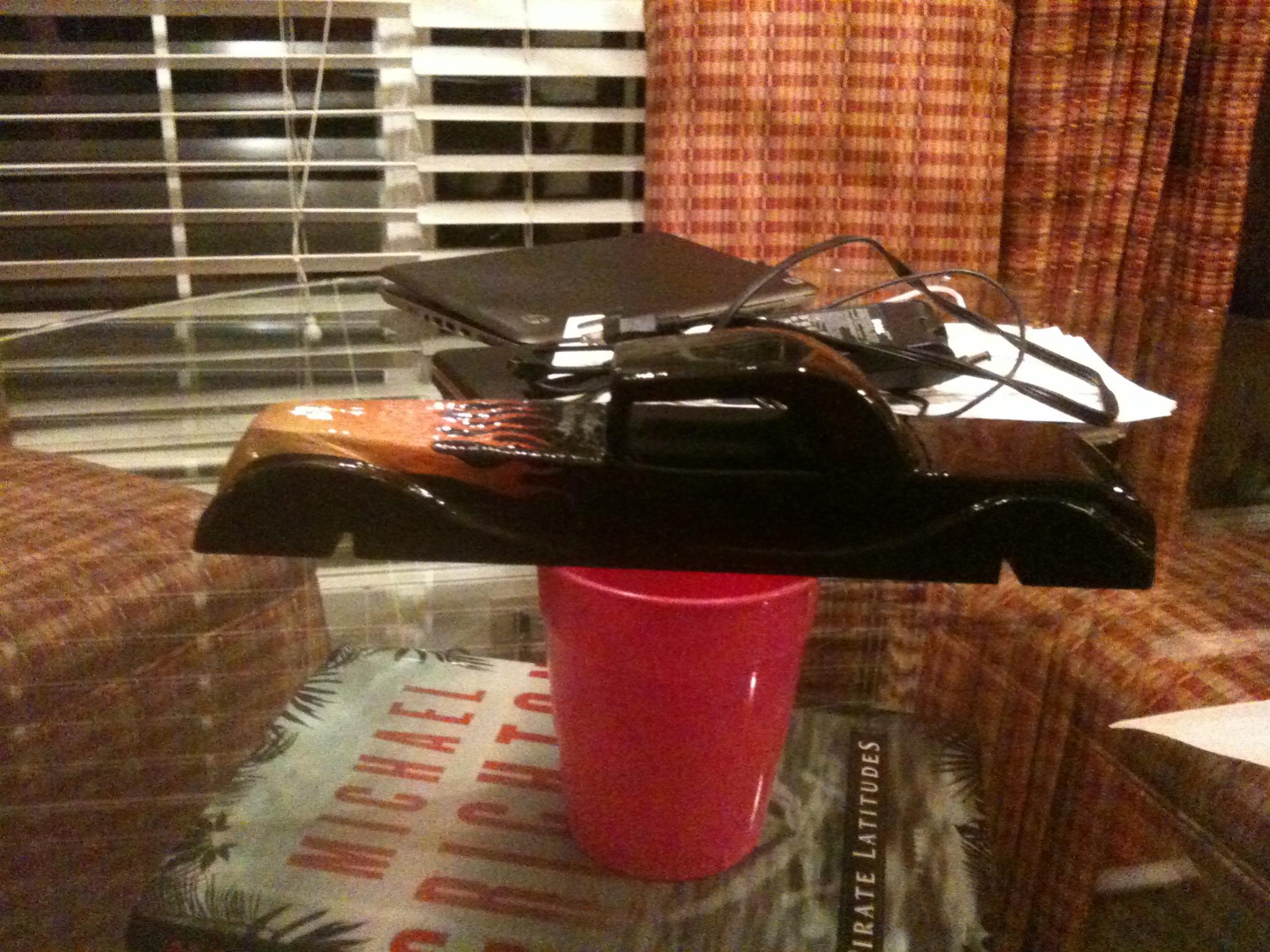

    Here are a couple of cars that my kids made many years ago. I asked them if they really wanted to win and they told me "no, we just want them to look cool" They put a ton of work into them and I did not help them. When they had a question though I was there. And it was a great father/son project. No, they did not win, but they enjoyed building the cars and it taught them how to use a bunch of different tools.
