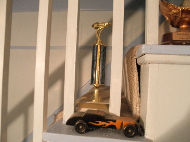

    My Son who is now in his 40s, still has the car that we built when he was a Cub Scout. I cut the block in half longways and hollowed out the inside. We glued it back together and shaped it with a wood rasp into a Indy car shape. I cut the axle grooves on the bottom so they weredeeper on one side than the other, this allows it to rest with only two wheels touching at a time. The axle pins were put in a lathe and the flashing cleaned off where the ends are stamped and micro polished where the wheels ride. The wheels were also chucked up and a slight taper cut across the surface where anly a very narrow patch actually touches the track.
    After it was ***embled and painted we weighed it on a postal scale and cut small pieces of solder until it weighed exactly 5 ounces then melted the solder into a ball and glued it into the nose inside the hollow body.
    The car won was won all of the local Scout and Church contests and was retired undefeated.
