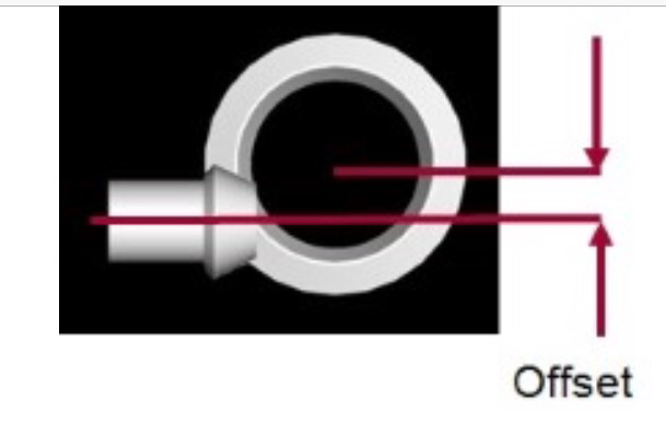

  21. Rat_Fink
    Joined: Nov 16, 2007
    Posts: 89
    Rat_Fink
    This is the offset that I'm looking for.
    I want the offset for:
    Early v8 rear end
    Model a ford rear end
    Ford 9 inch rear end
  22. theHIGHLANDER

    The 9" info is about "Britanica" sized on the www. I know enough about gears to be dangerous, but in my days at GM "Chevy Gear and Axle" that dimension was what we checked as "V & H", vertical and horizontal dimensions. Usually checked if a gear cutter crashed and had a limit of .002 which could probably be lapped out if it was off by the max. I was in "soft roll", or gears before heat treat. Those more involved, feel free to correct my fuzzy memory , but I would call that dimension vertical centerline rather than offset.

    I'm not asking about v and h. V and h are the movement of the pattern and I want the offset for the center position of the pinion to the center position of the ring gear

    The Ford V8 and Model A are 0.00"

    Ford specs were tighter than that...call it 0.000!
    Depth of pinion into its supports is another issue requiring lots of work on modern rears...Ford designed the banjo for quick assembly and true interchangeability; after the pair of gears were matched and run in on the whattyacallit machine, pinion was machined to sit at proper depth controlled only by very close limits on banjo and bearing dimensions. Nothing to adjust, just screwittogether. (your mileage will vary with modern reproduction gears, which will need careful work to get all together)
    9" has very radial offset on pinion designed to get '50's cars closer to the ground...at the cost of power lost.

  26. don't you call it a "hypoid" gear when the pinion is lower than the center line of the ring gear? That was done so they could get lower floors in the cars. and becouse that made more sliding action on the teeth as they meshed they had to make the hypoid gear oil to use in them. the old style "Ford " gears were just bevel gears. correct me if I'm wrong.

    A 9" is 2-1/2", as near as I can measure.

    Early v8 rear end: 0.000", pinion centered in chassis.
    Model a ford rear end: 0.000", pinion centered in chassis.
    Ford 9 inch rear end: -2.250", pinion offset 0.940" to the passenger side.
