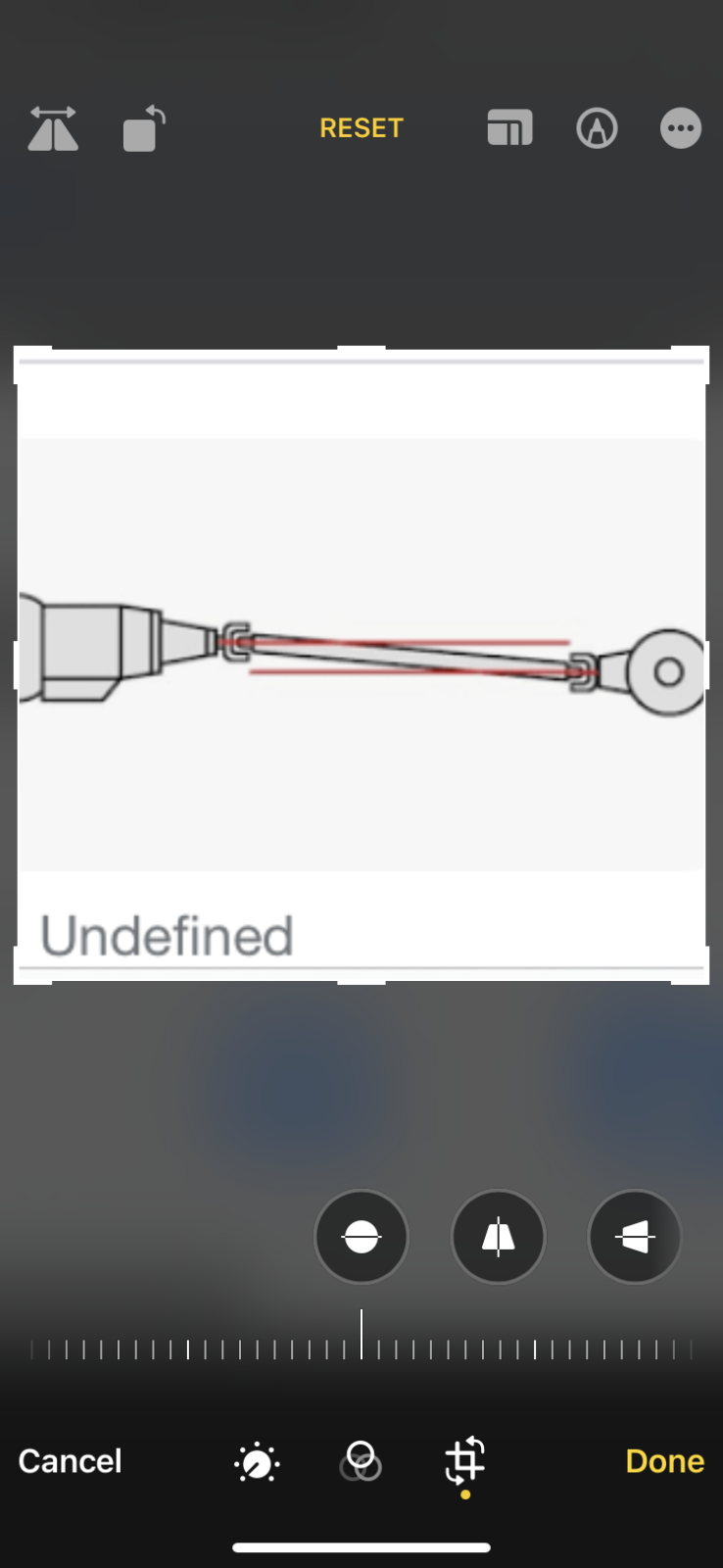

    This totally goes against any of the hundreds of knowledgeable explanations I have ever seen on this topic. A pinion line parallel to a 4 degree down engine/transmission line would normally be referred to as 4 degrees UP.
  4. So what direction is the drive shaft going then?
    What direction is the flow of power and motion?
    Where is the descriptor of direction ( up, down, positive, negative, to the left or to the right) changed, and why? There must be one somewhere an exact point for the three terms , up, down and parallel to be mixed and come fit that drawing.
    Super impose ONE simple XY graph over that picture you posted.
    Better yet, sit across from someone and tell them how to draw the picture.
    So starting on the left draw a line sloped down 2” long, then draw a line 4” long sloped down, then a line 1” long sloped up. See what you get.
  5. You see here the shafts are parallel and graphically displayed correctly but some could say the “orientation” of visual representation is confusing because of the protractor mounting.
    Some could say the graphic visual shows it’s 92°, some would say 88° some say it’s 2°
    The key things here are the shafts ARE PARALLEL and they are also GRAPHICALLY IN THE SAME QUADRANT.
    The graph is technically showing 88 degrees.
    You need to be smart enough to realize the artist hung the protractor/angle finder on a 90* square. 88° - 90° is negative 2°
    This next one is dedicated to MAX effort cars that spend their existence at WOT.
    you see how both are displayed the same direction, left to righ, both are negative.
    See the use of descriptive language to describe the drive shaft ? Beginning with Left to right orientation,,, you read a direction ( level up down) towards the rear.
    Here’s the place where things get screwy.
    Obviously the person started with the engine on his left side.
    Somewhere along the way the things got turned around. What missing is the frame of reference and the Slop direction.
    shown as parallel-
    engine down to the rear - pinion down to the rear
    Engine down to the rear and pinion up TOWARDS THE FRONT.
    The direction change is because the person most likely started with the engine on his left & held the angle finder and walked around to the pinion to the other side of the car and now with the engine on his right and pinion now on his left and called the pinion’s orientation as up.
    A set of angles is ALWAYS stated as from going left to right.
    Set up some CAD work and draw what you want, say parallel shafts with a sloped drive shaft then measure what you drew.
    Play the draw what I say game and see what this brings. Talk to a 5th grader or architect, engineer - “ 3° down sloped drive shaft down and 3°up”
    Then try it like this,,, 3° down, sloped drive shaft down - now pick your pencil up move it an inch to the right and down about 1/4”. Restart the line sloped UP back towards the LEFT to be parallel with the first line.
    Or perhaps try this- “3° down, sloped drive shaft down, and 3° down parallel with the first line.
    Again the correct way to describe this and to draw this is left to right. If you want BOTH the pinion to be parallel with the engine and call it’s orientation as UP because you’ve turned yourself around thus switching the pinion from your left to your right , knowing you’re now describing it in a correct but changed orientation of left to right perspective beginning with the pinion.
    You describe it anyway you feel good about it. We can hold to centuries old standards of practice of description, of orientation, except for driveline angles and pinion orientation. Call it up if you want, but at least know it’s up to you because whoever you learned it from instinctually originated left to right but wasn’t smart enough to know they turned themselves and the protractor around.
    Things get different when setting up a lowered vehicle. That down first then turn yourself around now it’s up **** don’t work so good.

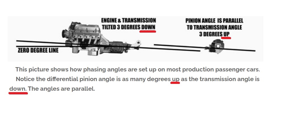

    Notice that it says "points up or down when viewed from the transmission toward the rear of the vehicle".
    Also notice that they are talking about the "driveline slope", and not the driveshaft.
    Let's use the picture below.
    You are in front of the engine and you are looking backwards along the driveline toward the rear of the vehicle.
    The transmission output shaft points down (out of the trans towards the rear).
    The differential pinion shaft points up (out of the centre section towards the front).
    Therefore, in the pic, trans is down 3* and pinion is up 3*.

    It gets confusing, doesn't it? That is what I have been trying to say all along. People use different terms for the same thing and if you are not aware of what they mean the calculations can be incorrect. I will try to explain as simply as possible (and 31Vicky with a hemi will let me know if I get it wrong).
    Let's use the following diagram. I only chose it because it clearly shows the slopes of the components. Ignore the numbers.
    The proper way to describe the slopes is going from the front to the rear (trans to the differential).
    In the diagram, you would say:
    Transmission output shaft slopes down (negative slope)
    Coupling shaft (1st shaft) slopes down (negative slope)
    Driveshaft (2nd shaft) slopes down (negative slope)
    Pinion shaft slopes down (negative slope)
    As you can see in the diagram, all the components are sloping down when viewed from the front towards the rear.
    Sometimes components can slope the other way (upwards towards the rear). It would then be called a positive slope for that component.
    Now, we will move on to the bit that catches a lot of people out.
    Some people will use the terms "tail up" or "tail down" to describe the transmission angle. Just as it sounds, the tail is the rear of the transmission. This doesn't usually cause problems because it works the same way as the slope. If the transmission was said to be "tail down", it would be like the diagram shows, so the slope is down. Hard to get mixed up as both descriptions say "down".
    The differential is sometimes described as "nose up" or "nose down". The word "nose" is used to describe the actual pinion flange on the front side of the centre section. This is where we need to be very careful.
    The diff in the diagram above would be "nose up", but using the proper terminology it slopes down towards the rear (negative slope). The two different ways used to describe the pinion conflict. "Nose up" = "slopes down".
    So you can see that it is very important to understand which method is being used to describe the pinion.
    Using slope (from front to rear) is the proper way, but some people will always still use the nose term.
    That is what I have been saying throughout this debate. It is more important to be aware of both of the ways used to talk about pinion angle than to argue which one is "correct". If you can identify exactly what is being described, your calculations will work.......... My pinion angle rule number 1: Know the exact term being used !!! .....:D
    @Budget36 , let me know if this makes sense to you. I hope it does.

    In my ‘32 Dodge PU I set the transmission down 3, pinion up 3, but the driveshaft is only going to be about 18 inches long.
    I think my Google geometry showed I’d have like 9 or 10 degree operating angles. I’m not comfortable with that. So time to make some adjustments;)

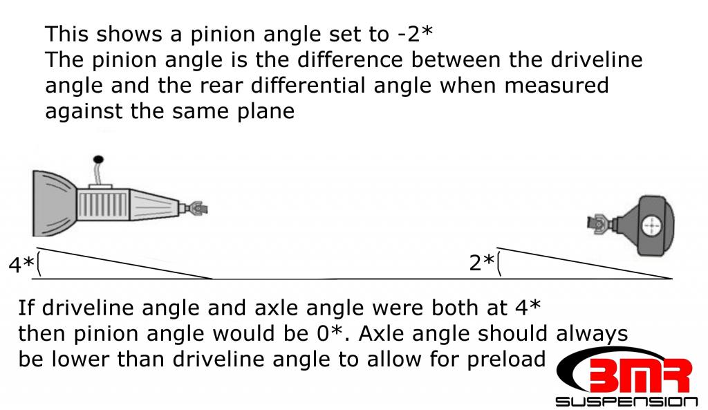

  26. “ The fact is that those terms are used by some, and that can be why many people get mixed up about this subject. “
    Yes it’s a clear an obvious fact.
    It only happens because people want to dabble around with rule 4.
    No switchie guarantee no confusie
    twenty8 likes this.
