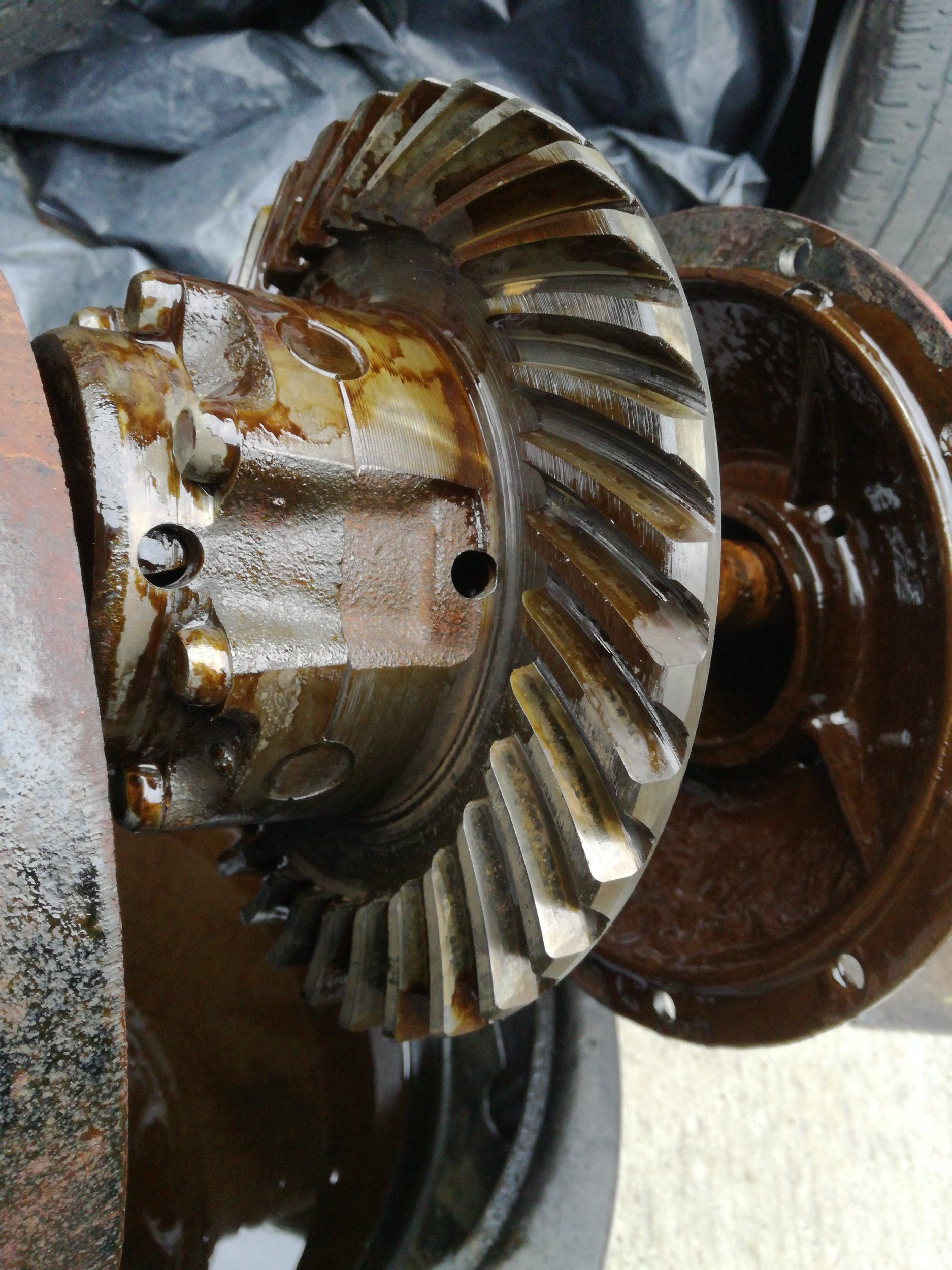

    I dismantled the rear axle ( 1948 banjo) and noticed surface damage on the pinion teeth, plus one place with corrosion. it does not seem to be deeply corroded, but the surface is no longer as smooth as it should be. In your opinion, is this part suitable for use or should I buy a new one? I must mention that before I took the rear axle apart, everything was running smoothly without any jams.Ring gear looks very good.
    It looks like it was working with too little oil.What do you think, gentlemen

    I would use it. That is, in something that required nothing stronger than a Banjo Rear

    Under the hood there will be a V8 24stud 221cui, supercharged with Frenzel . I drive calmly and I don't plan on burning tires or racing. Gear ratio 3.78

    I'd use it too.
    Deuces, Stock Racer, Sharpone and 4 others like this.
  5. Use a Scotchbrite pad in a 90 degree sander,,,,hit the teeth in a polishing fashion .
    Those will clean right up .
    Actually,,,,they look really good,,,,it will work almost like new .
    Of course,,,,,a thorough cleaning of all the parts goes with that too .
    Tommy

    Yea. I would clean it all up as stated and run it.

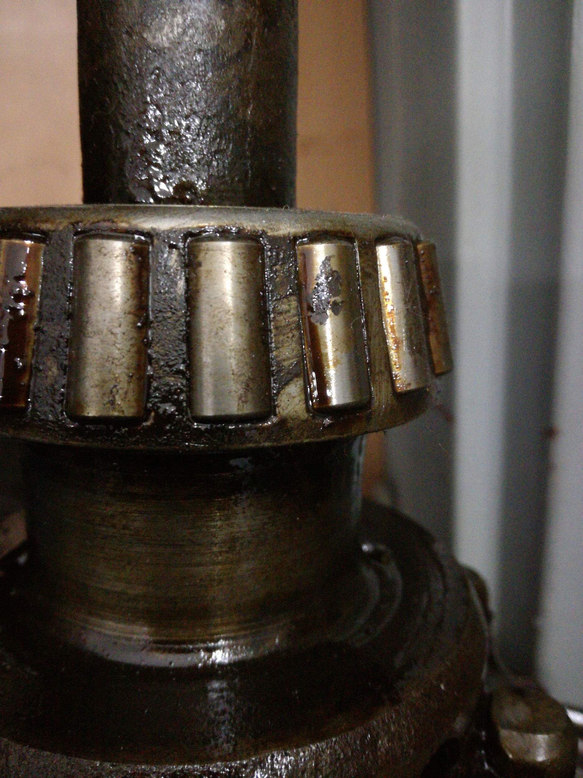

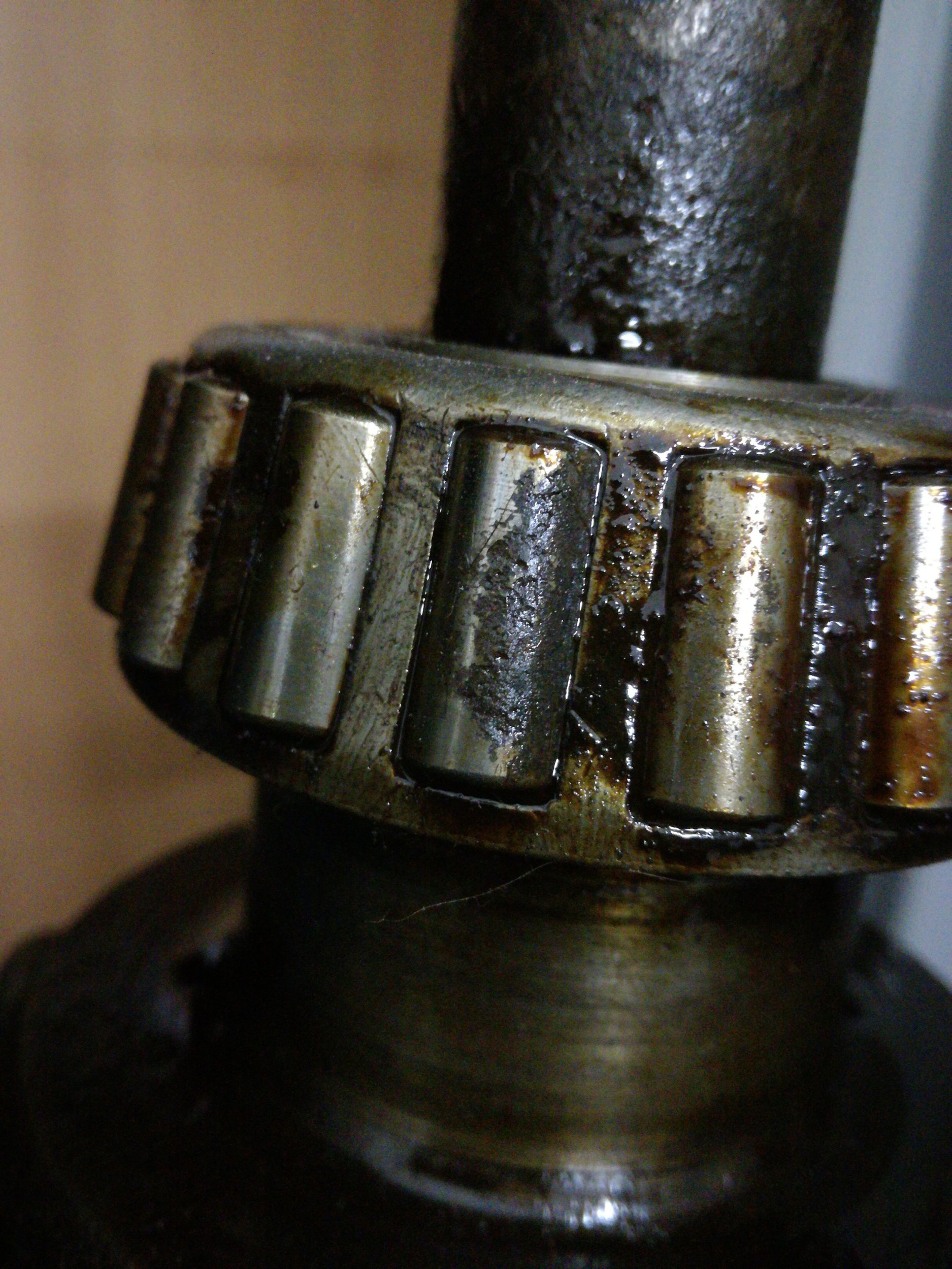

    Thanks guys. I will buy new bearings and will use this ring and pinion set.Bearings looking like that:
    Unfortunately, there was some moisture inside and parts were damaged by corrosion. The bearings are generally in excellent condition and if it weren't for these minor damages, you could easily leave them as they are and drive them.

    Bearings are different….rust pits (some call patina) on ring and pinions just carry more oil!:rolleyes:.

    I don't feel good with those rust spots on the pinion but maybe I'm to precize...?

    I´d put in new bearings, polish the pinion teeth a bit and run it. You should see the gears I´ve been running in my 55 Chevy 3 speed OD trans for over 65k miles now without any troubles.

    What does the bearing surface look like at the back end, under the roller bearing? I find this to be a weak link in the banjo's. That bear goes out, then it will spin in the case and wreck that too

    It look very good. One small rust spot but outside of the bearing track.

    Clean the bearings really good and post pics of the cage & roller as well as outer race. You might be ok, that's ***uming they are original Timkens. Can't tell if that one roller is spalled or not...
    If water did get in and any of the races or rollers are rusty, replace them with usa made Timken, not the China made Timkens.

    I have a transmission with straight cut gears, a couple look like your pinion. I burnished with a wire brush and plan on running with the slight damage. I wonder if I could shot peen the tooth surfaces if that would help?
    I would put new bearings in and run it if it was mine.

  18. I'd polish the pinion teeth, put new quality bearings/races in it and when you ***embly it, setup the pinion preload and then the backlash as it should be - and you should be fine.

    I believe I see some spalling on the gear teeth where chunks of metal have been removed. If I tore a rear end apart and found gears in this condition; it would be getting new gears. I like to do a job once and not worry about "iffy" parts.
    Could you run these gears a long time? I'd give it a definite maybe, but I wouldn't try.

    I don't see the thinking behind all that is involved in going through a axle and putting a gear set back that is already coming apart. But that is just me.

    You're good. And like the guys said, clean it up a bit. Die grinder, sanding disc, file, whatever you have. New bearings for sure
