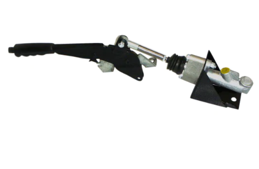

    Depending on what you are using it for, there's also hydraulic locks for the existing brakes, both electric and manual. I have an electric lock on my daily, dashboard switch. I use it when I open my gate, which is on a slant.

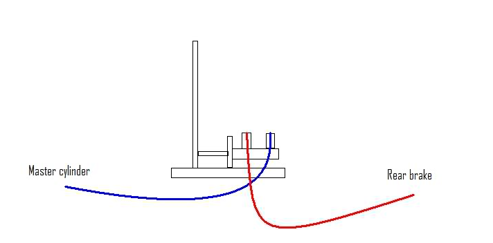

    Why don't you forget this idea ^^^ [re-engineering the driveline] and simply install a Hydraulic handbrake.
    Compe***ion Rally cars have been doing this for Decades
    They call it a "Fly-off handbrake" [The only difference is they don't have a ratchet mechanism]
    It comes in handy when performing the "Scandinavian Flick" into corners.
    You need a remote reservoir type master cylinder plumbed inline into the rear brake circuit .
    The outlet port goes to the brakes.
    The reservoir port goes to the M/C side.
    When the Park brake is not in use, the M/C is flow though.
    When you pull the park brake the M/C blocks off the reservoir port.
    A Hydraulic handbrake can hold a car for months without issues
    This is very common in NZ where Hydraulic surge brakes are used on trailers [boat] and they all have a handbrake lever.
    Note: I've also seen them plumbed into the front brake circuit as well which makes it useful for doing or controlling burnouts /skids .
    Front or Rear handbrakes are just as efficient as parkbrakes
    jaw22w likes this.

    That's interesting. I always see the drifters on TV using the rear brake with the lever. Didn't know how it was plumbed. So is the remote MC something special to allow the flow through or would any MC work? The only downside I see is if you have a leak in the rear system you lose both braking and parking brake. I think I will stick with a mechanical system. I'm not going to be performing any "Scandinavian Flicks" with my Model T. I would wind up on my head.
    2OLD2FAST likes this.
  26. Mimilan
    Joined: Jun 13, 2019
    Posts: 1,255
    Mimilan
    The M/C you need is a normal Single piston remote reservoir type.
    And Ironically it can be any bore size as it doesn't affect normal Front/Rear brake bias.
    The important thing needed is a return spring so the M/C can fully retract to allow normal braking.
    If you had a leak, The Handbrake lever travel would give you an early warning whereas sometimes you can leave a car parked for a while and don't notice a leak until you move the vehicle.
    The wheel cylinders /calipers also seal better with a bit of pressure on them. So if you were to have a leak, the probability is more likely to be the front circuit.
    On hydraulic surge brake trailers we pack a bit of "rubber grease" behind the rubber boot because the trailer is left outside exposed to the weather for months [they don't fail]
