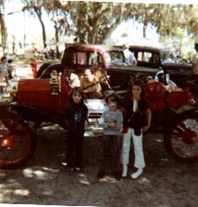

    hotrod1940
    I have a few shots, but I wasn't smart enough to zero in on the striping. Neumanns Rolls, this was a 1912, a Metz Roadster, Bill Woolridge's 32, Lou Campbells T speedster.
    Sorry about the quality.
  28. I used to do exactly the same thing.I was more interested in a pic of the car than what I had painted on it.I didn't even start taking pictures of my work until about 10 years ago.
  29. hotrod1940
    Joined: Aug 2, 2005
    Posts: 4,064
    hotrod1940
    That may be the best tip we could offer to young stripers, take pictures of your work, you will be glad later.
    Plus it will show how you progress.
