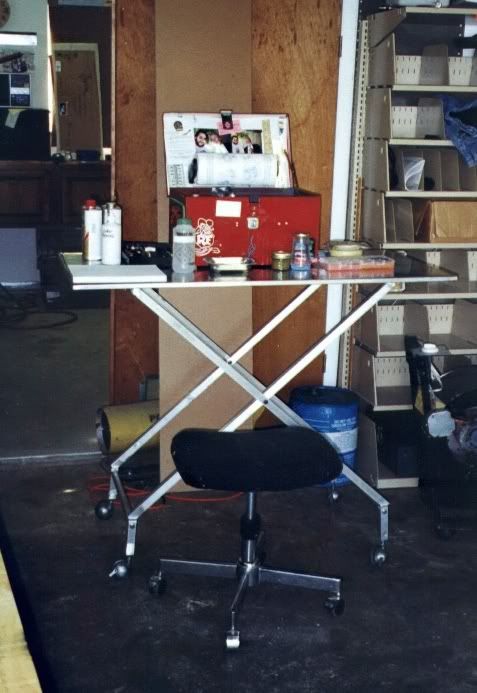

    As for my travel kit, I usually travel with my big folding table. It’s a 2’x4’ plywood top with a galvanized cover – won’t rust. The frame is 1” aluminum square bar stock. I traded that frame for a striping job. On the table, I have my paint box that holds about 35 4 oz. bottles that I store upside down. This makes it easier to see the colors and they don’t dry out as fast. The red box in the photo has been replaced with a newer blue box. The blue box has trays in the lid like a tackle box. In those trays are all my tools. On the tabletop, I keep a little stainless steel dish for cleaning fluid, my brush box and all other supplies that get used most, i.e. paper towels and such. I got the SS dish a long time ago and really like it. It won’t rust and is the perfect size for the brushes.
    The brush box it a little plastic parts tray with a lid. The bottom is lined with foam that’s saturated with oil. This box holds all my swords and quills.
    On the tray on the bottom of the cart is all my other supplies and a trash can. When I first showed up at striping events with all this, I caught a lot of grief for being like a pack rat. But when those guys needed something, they knew who to ask!
    I used to use MS for all cleaning and thinning. I’m now using 1Shot’s stuff. It took me a while to get used to it all but it’s all good now.
