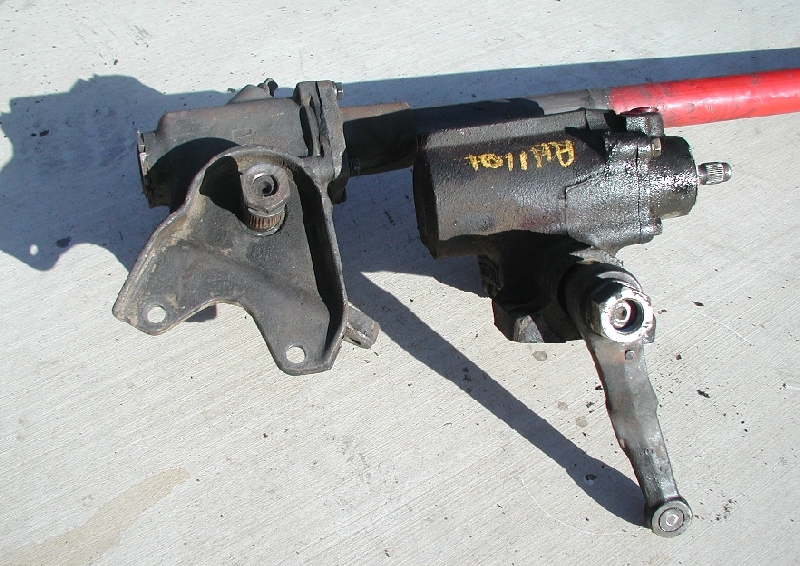

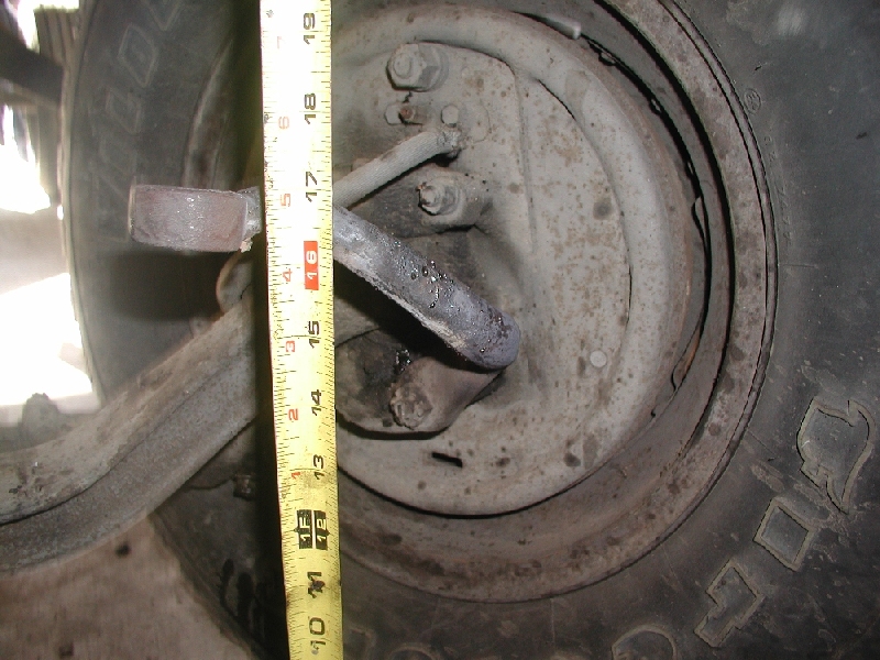

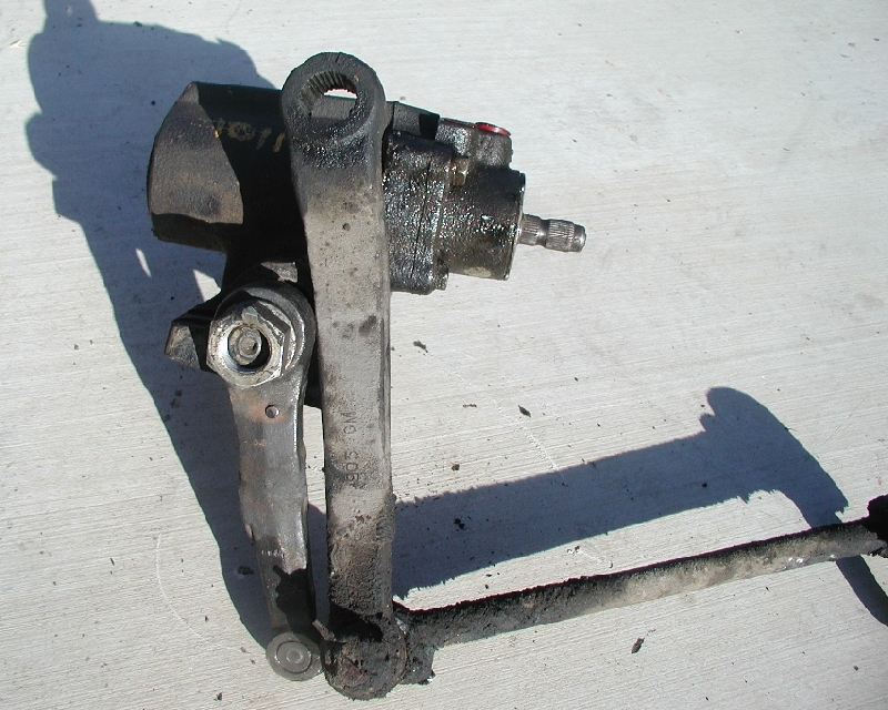

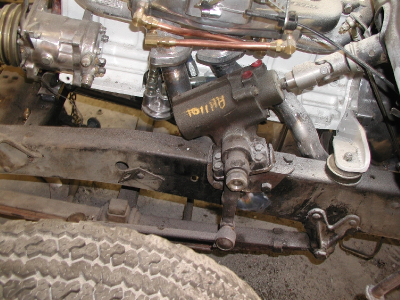

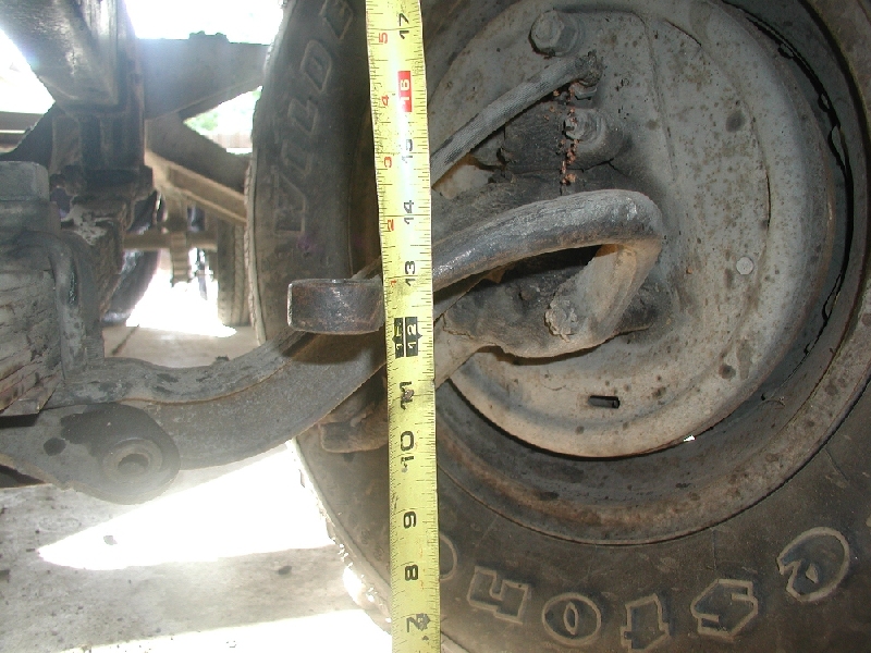

    Joined: May 6, 2006
    Posts: 3,193
    willys36
    I put a Toyota PS gear in my '53 Chevy pickup. I heated and bent both the pittman arm and the spindle arm. No problems. Just let the thing cool slowly, don't quench it.
    Here is why the spindle arm had to be raised. Toyota pitman arm is way shorter.
    Stock shape.
    New shape after heat and bend.
    Straightened Toyota pitman arm. I cut off the ball, drilled and reamed it for tapered end of conventional rod end. I bought a tapered reamer I think from Speedway, have used it several times over the years on such crazy projects.
    Couple shots of the Toyota gear bracket I made. Similar size and shape as the stock '53.
