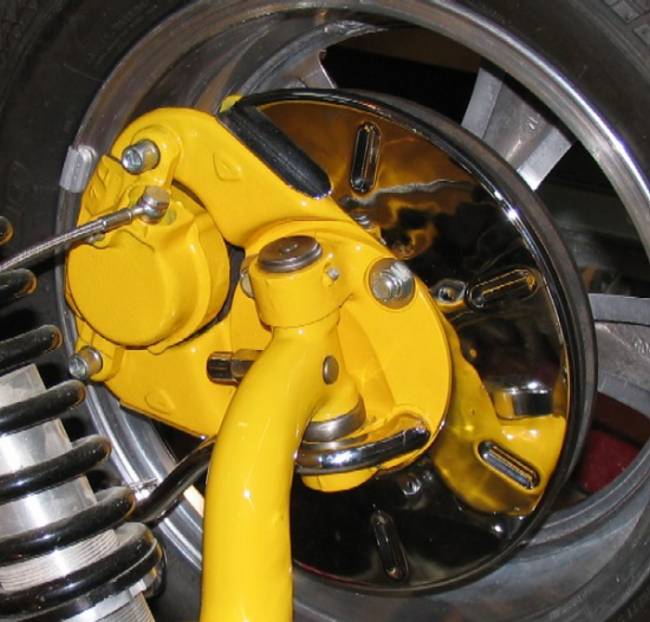

  5. With a 4" Pitman on a Vega box you may run out of travel before the wheels get turned as far as they should.
    That said, and as you noted the Vega Pitman is 6" eye to eye.
    I have an aftermarket Pitman on a 32 that's been bent for clearance and has an eye to eye distance of 5".
    The car turns as sharp as it should and the spindles hit the steering stop nuts in either direction.
    The Vega box has internal steering stops, but you definitely should not use them due to the potential for damaging the box.
    The chrome acorn like nut on the kingpin lock bolt in the pic is the steering stop bolt.
    It can be a bit of a juggling act to get it all sorted out, but it's well worth the trouble.
