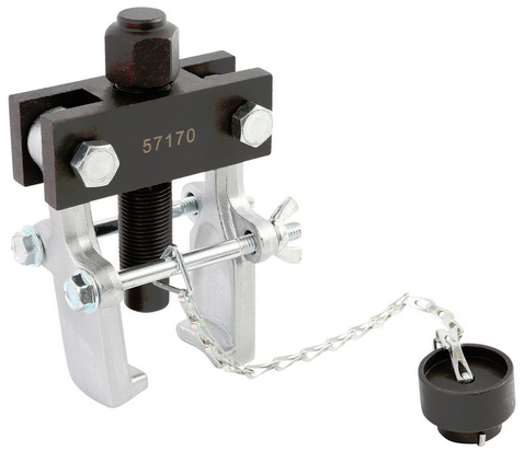

  7. Here's what I'm using. I don't see it being a problem, as long as the wing nuts are threaded on more than I had them. I also have one like in post #4.

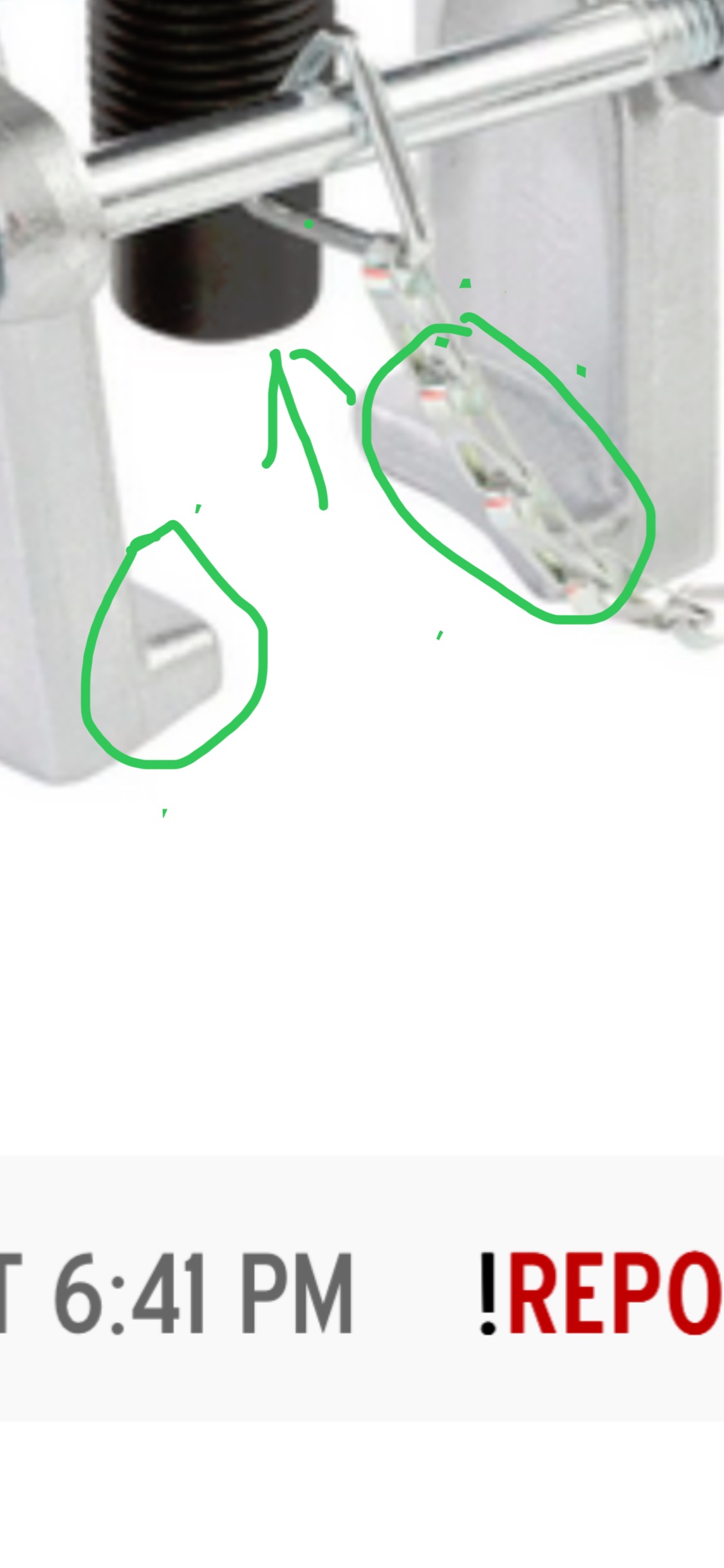

  22. Johnny Gee
    Joined: Dec 3, 2009
    Posts: 14,451
    Johnny Gee
    from Downey, Ca
    Budget36 likes this.
  23. Budget36
    Joined: Nov 29, 2014
    Posts: 15,386
    Budget36

    The absolute best pitman arm puller is the cup style. They don't use separate arms with hooks that can spread the more pressure you put on the T screw to pull an arm. Of course they cost a lot more, but I've never found a pitman arm they wont pull the first try. About $90-$200 depending on where you buy one. This one is on Amazon for $89.
