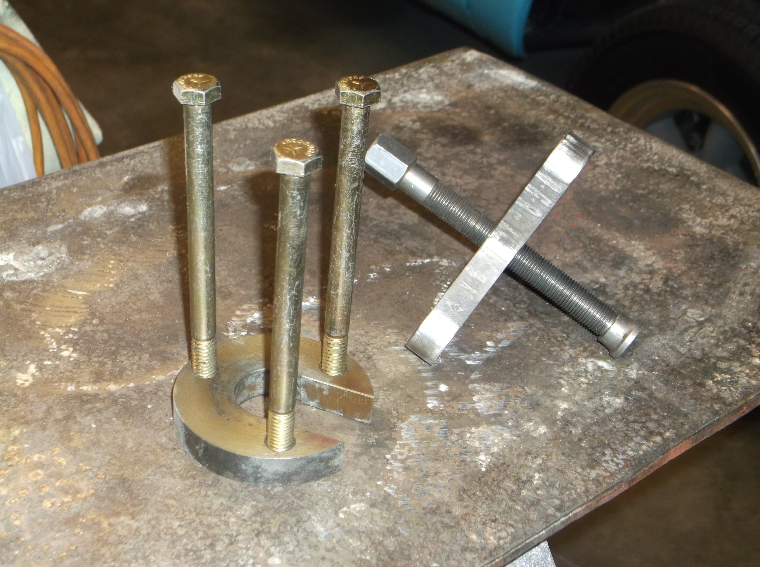

  3. Well, I went with another puller and turned the front wheels so that tool was gripping right where it needs to. Then I cranked (using a cheater bar). What sounded like progress was actually the box pulling off of the frame rail some because at least one of the threads unraveled. I remember that the threads felt iffy when I tightened (overtightened?) them.

    That looks like it wouldn't work. Don't you have a 5lb. hammer and pickle fork? Or just smack the side of the mounting boss with said hammer, they'll usually drop right off.

    I made this "C" washer to use with my damper puller (also made by me) to pull pitman arms on Vega boxes. It has worked good so far. Maybe I haven't had a real stubborn one yet, though.
    Gary
    rusty valley likes this.

    Thats thinking outside the box,nice work.
