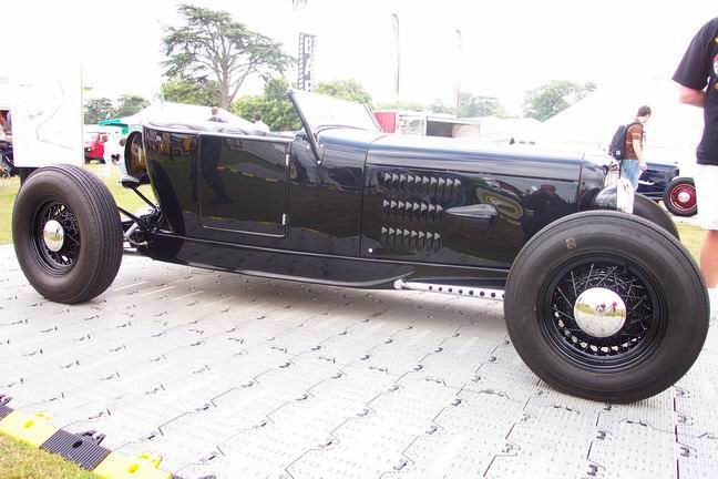

  4. A Boner
    Joined: Dec 25, 2004
    Posts: 8,162
    A Boner
    Can't go wrong if you build one like this one. Not the best pic, wish I had some better pic's and some info on it. Maybe someone will know more about it.

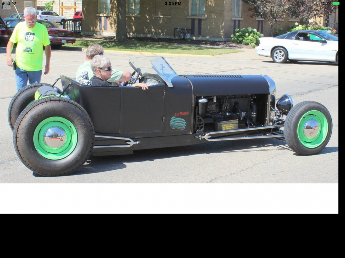

  5. A Boner
    Posts: 8,162
    A Boner
    image.png Only other pic I have.

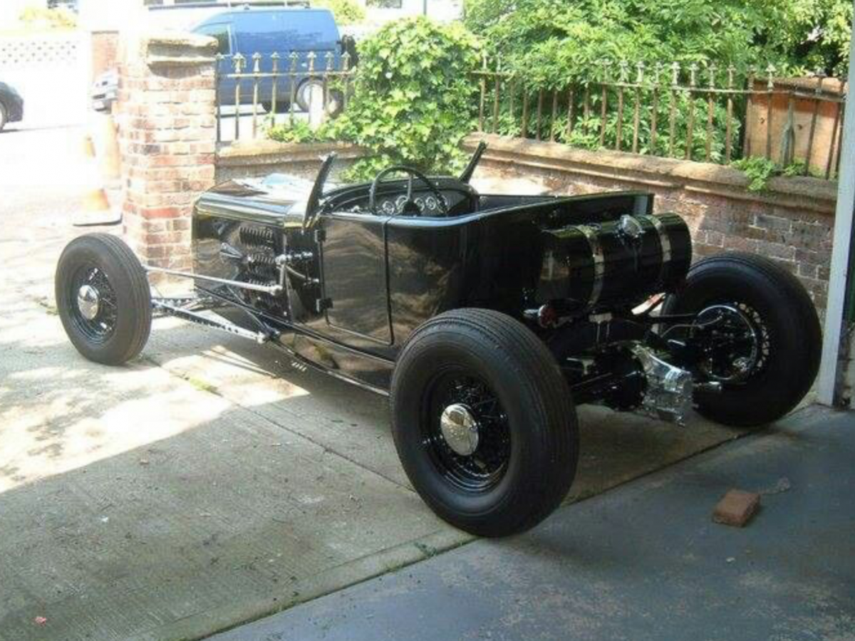

  6. dakotajayne
    Joined: Jun 8, 2008
    Posts: 143
    dakotajayne
    from 3c1
    The Deuce rails will work fine. My rails came from Lions and are approximately the same depth as the 32's. Hard to see in the pics but you can grasp the proportions

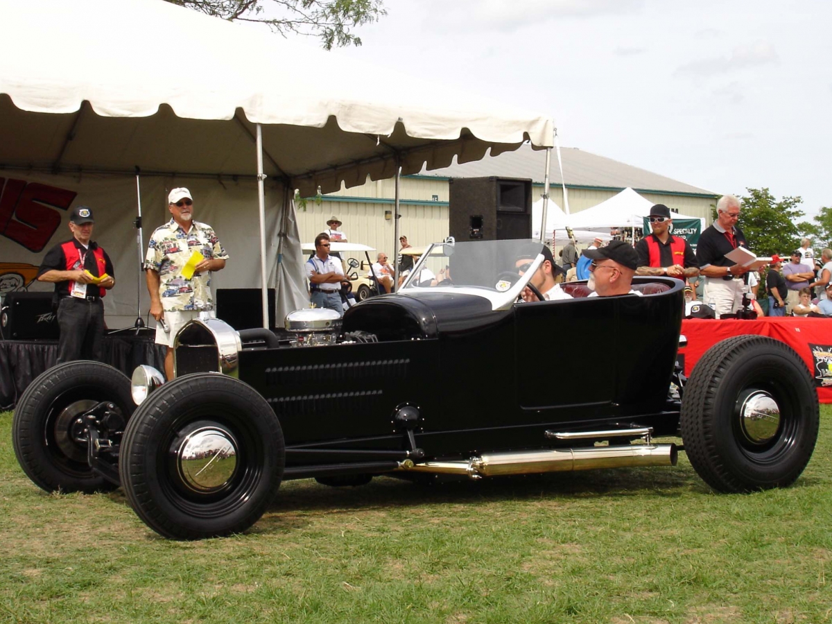

  7. atch
    Joined: Sep 3, 2002
    Posts: 6,415
    atch
    This, without the hood and with a painted 28/29 grill shell is pretty much my plan. Of course I can't imagine that I have enough talent (or time left in this lifetime) to make it this nice.
    Are these 26/27 windshield posts that are leaned back?

  9. A Boner
    Posts: 8,162
    A Boner
    image.png The roller for this modified was built by Jim at Lions hot rod shop. The frame is 2x5 rec tube.
