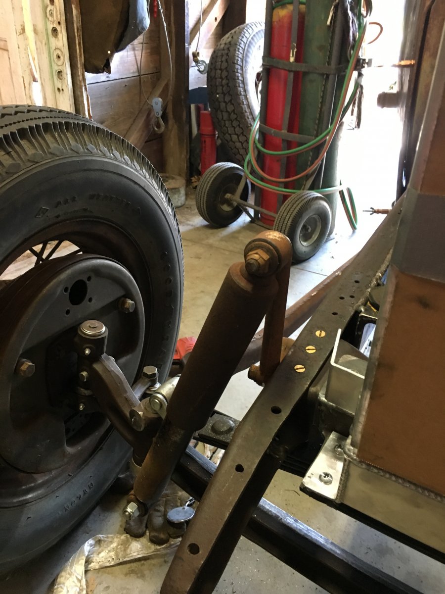

    IMG_0515.JPG I have a 47 front axle on my coupe right now. But it is not dropped. I was****uming I could drop one and bolt it right back into my Posi spring and 47 radius rods? Will that not work or be problematic? I have a Model A front Axle that I am not using. I am not really sure about doing it at all. I found another 47 front axle cheap and was thinking about having it dropped.

    It will move the steering link, or links closer to the radius arm.
    It may be necessary to heat and bend the steering arms. This is a common task, and well documented.

    Tires may hit the split bones and restrict steering to a much larger turning circle than you might like. This can even be a problem with earlier axles and split wishbones.

    Since the distance from the perch to the kingpin is so much shorter on a 47 than an A axle, you can't drop them as much. And, you have clearance problems between the tire and wishbone on hard turns.
    I'd recommend dropping the A axle, installing it in your car, and getting a shorter main leaf for your spring. All the other parts can be used with some slight adjustments here and there.

    Tires will hit the split bones. I put a bend in the mid 48's Bones on my T bucket to clear and I think that may have been part of the doesn't drive great at speed contributors.
    You may be able to move the back end of the bones inboard several inches with the dip in them to clear the rails but if it were me I'd ditch the late axle and swap everything over to a dropped early axle. You will have to change springs but will loose a lot of headaches in the process.
