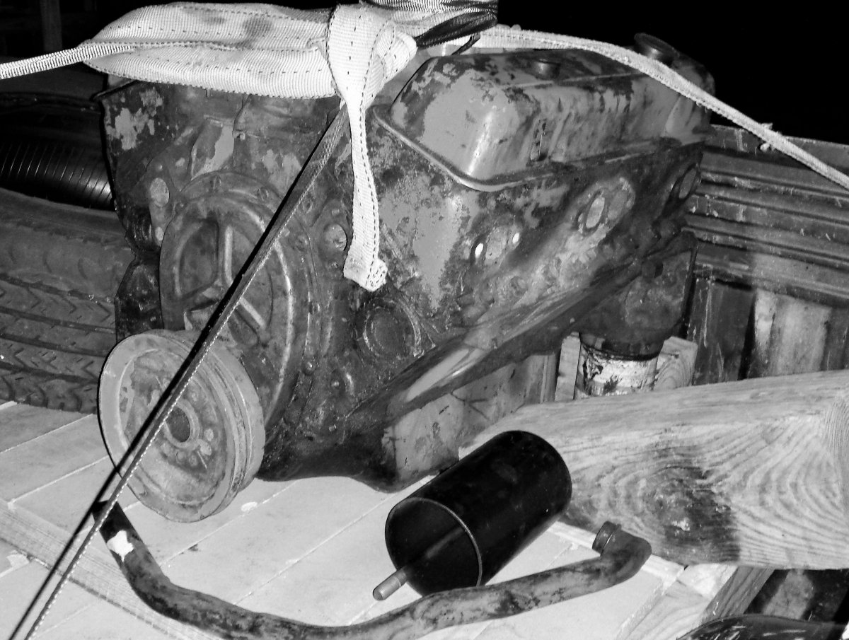

    scored this 265 off Craigslist with the plan to put in my 29 "pea green" tudor.
    casting translates to a 1955 or 56 car & truck 2-bolt, the canister oil filter and long crankcase breather tube make it a 1956.
    many thanks to my neighbor Tom, for the picking up and tearing apart.
    plan to drop off the block to get cleaned and inspected a local NAPA machine shop tomorrow to make sure its good before I get too excited and start buying other parts.
    I've done some research (all Google searches lead to HAMB) all thoughts and knowledge appreciated, I've got a few ideas I'm pondering going for 307 cubes
