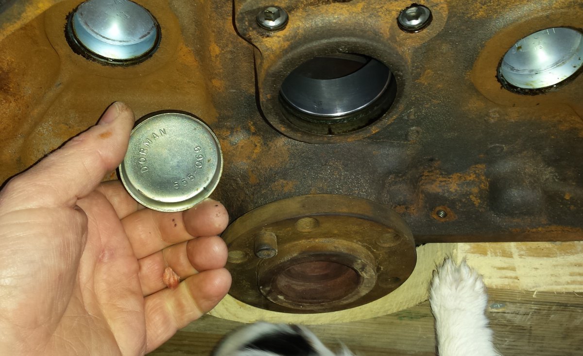

    so I noticed my block had wrong part number freeze plug, so I pulled out and checked bearing.... it's the wrong one for 265......... i'll post a pic when I get time to install correct bearing.
    EDIT; the correct rear bearing was installed. the 2 oil holes are at 12 o'clock and I didn't know

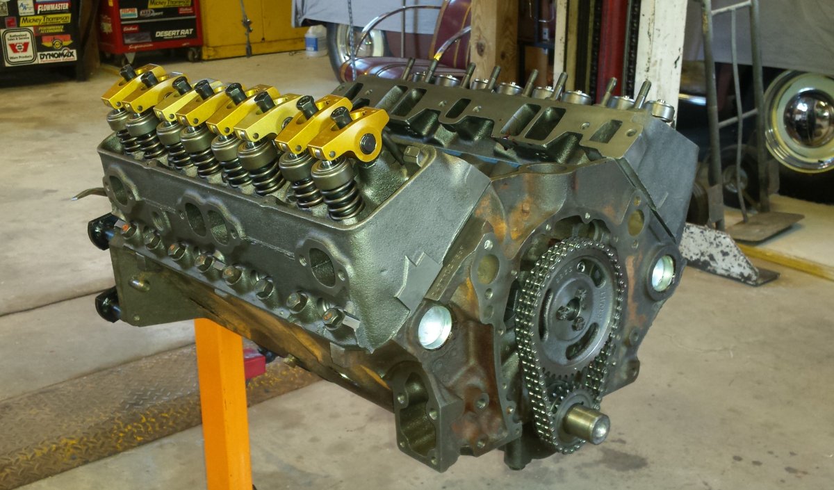

    installed camshaft, timing gears/chain, decided to go with these 305 head gaskets and torques heads, lifters and started with rocker.......
    volvobrynk and kidcampbell71 like this.

    I stayed with the timing gear and chain from Comp Cams..... Hope it don't stretch as Old Wolf describes.
    getting a few parts installed.... should had intake and carb ready next week that use for initial startup and 1st year shakedown.
    steinauge and volvobrynk like this.
