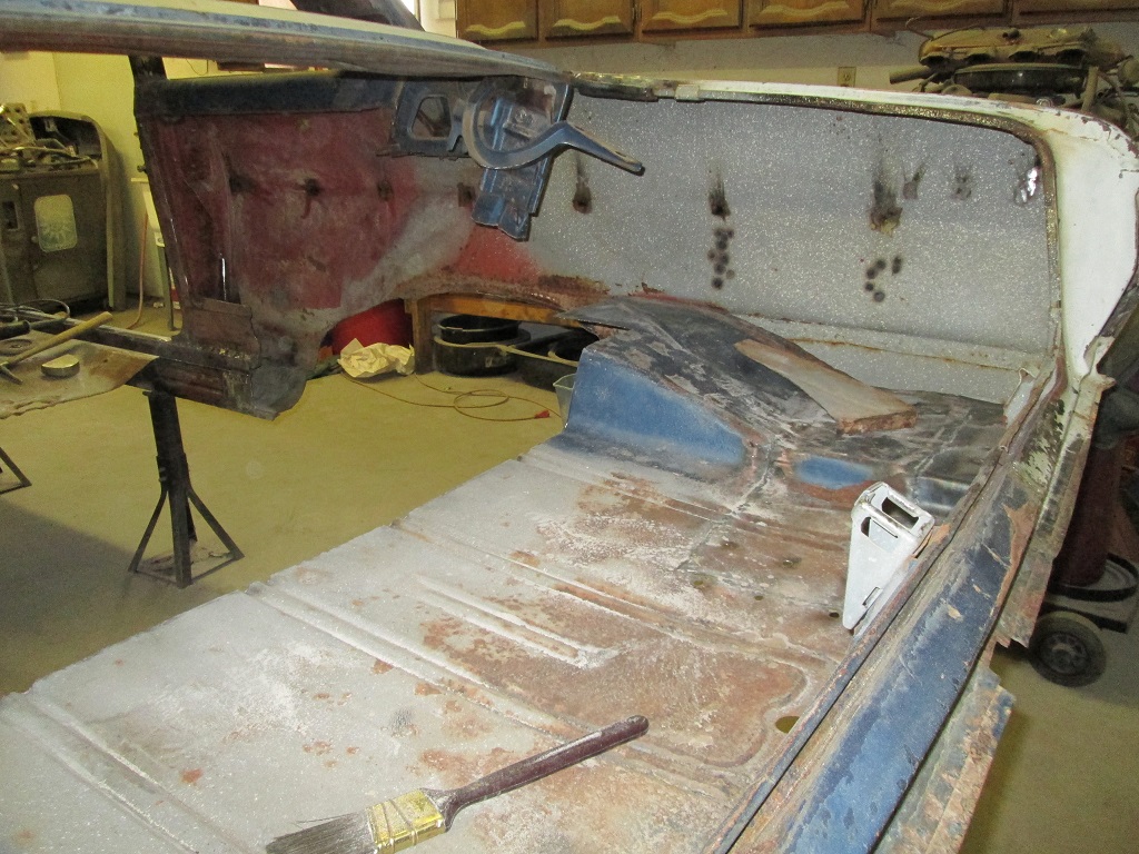

  18. squirrel
    Joined: Sep 23, 2004
    Posts: 59,199
    squirrel
    cleaning up the floor before installing it in it's new position. Nice original primer under the crud.
  19. Olderchild
    Joined: Nov 21, 2012
    Posts: 476
    Olderchild
    from Ohio
    Beautiful, if that was a Ohio car the picture would be of a shovel full of rust

  20. Boones
    Joined: Mar 4, 2001
    Posts: 9,691
    Boones
    from Kent, Wa
    1. Northwest HAMBers
    you moving the rear forwards?
    els likes this.

  22. squirrel
    Posts: 59,199
    squirrel
    Yessir.
    1Nimrod, chryslerfan55 and els like this.

  25. squirrel
    Posts: 59,199
    squirrel
    There are lots of ways to do this job, we're doing it kind of strangely to deal with the rust and collision damage on the car. It was destined for the scrap heap....in AZ, this car is a real piece of crap.
    Almost ready to put the floor back in. Got some bodywork done on the quarters, cleaned up the floor section, trimmed more excess stuff from around the trunk area.
    Also got some parts in the mail, including the roll cage and seats.
