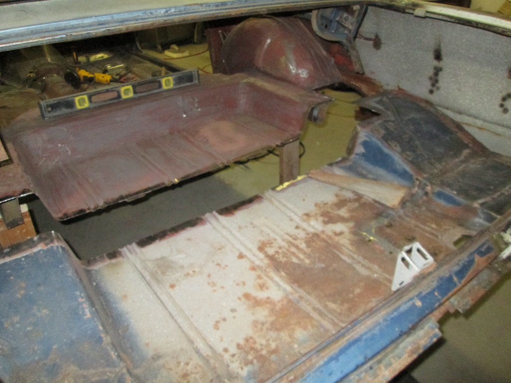

  16. squirrel
    Joined: Sep 23, 2004
    Posts: 60,031
    squirrel
    got the floor filled in the trunk, and also in the former rear footwell area, where it was kinda rusty.
    Work still in progress picture
    Looking at front wheels....found some new 15x5 aluminum slots for a reasonable price, but I'd sure like to find some old ones, 4 or 4.5" wide, for a half reasonable price.
    1Nimrod and els like this.
