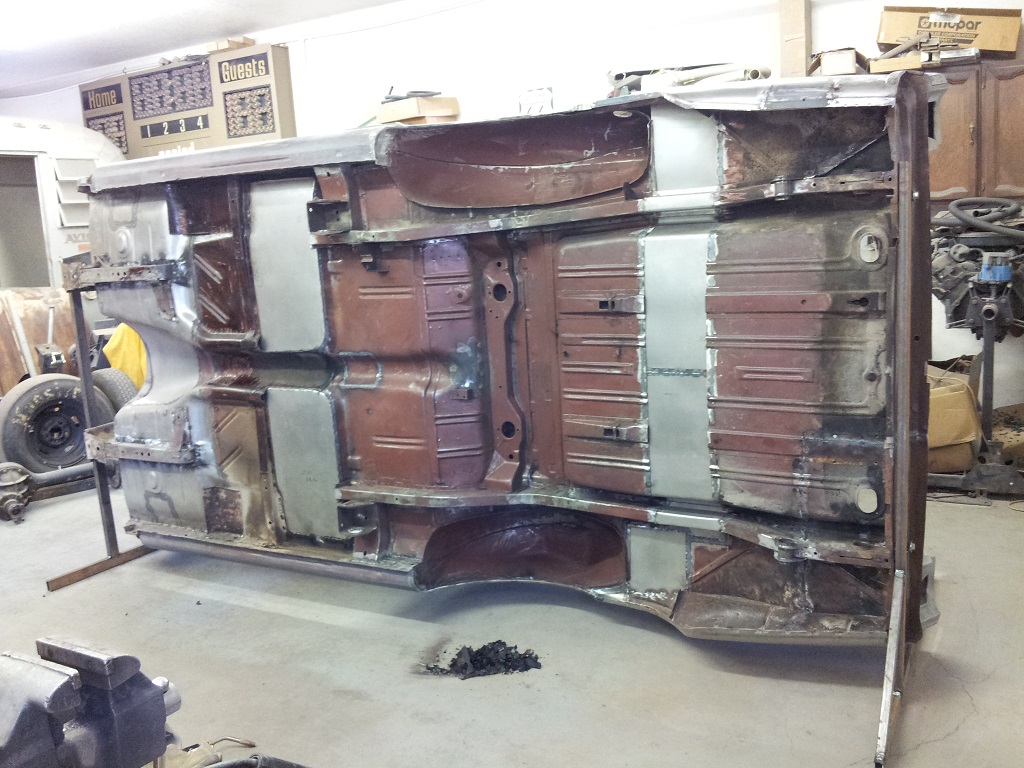

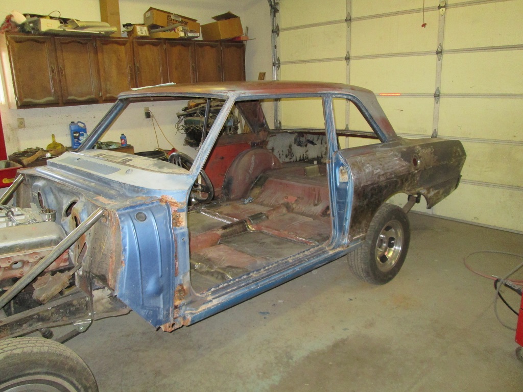

    A little more progress. Most of the paint is stripped of the car, most of the rust holes are fixed, roof has the bodywork done, quarters are mostly done, and I set it on it's side to work on the underside of the floor.
    1Nimrod and els like this.

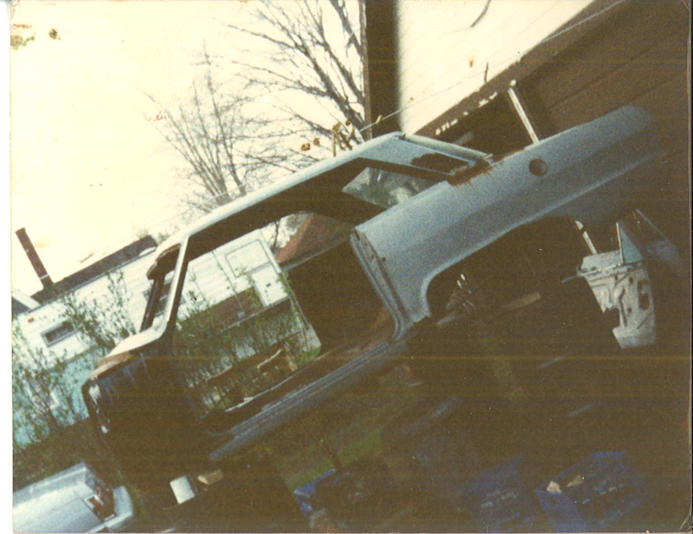

    Looking good Jim. Every time I come back for the updates I think of my first car. I was not even old enough to drive when I purchased my Chevy II and the thieves got it before I could do much to it. I lost all the pictures of mine when I was in the military but I found the only picture I have of it hanging on the wall in the garage last night.
    Keep up the good work and the hunt for fastest street car.

  27. I want to see more pictures of your rig you made to get the car on the side. That is an excellent idea, and I must steal it. :D

    The stand is just a few pieces of 1x2 tubing, welded to make a T at each end of the car. Tipping it up is a bit exciting if you're doing it by yourself...I suggest you get some beer buddies over for that. I used a hoist, chained to a spring hanger

  29. You rolled your gasser! Looking great!!:D
    els likes this.
  30. Looks like a vanishing rotisserie, great idea Jim!
