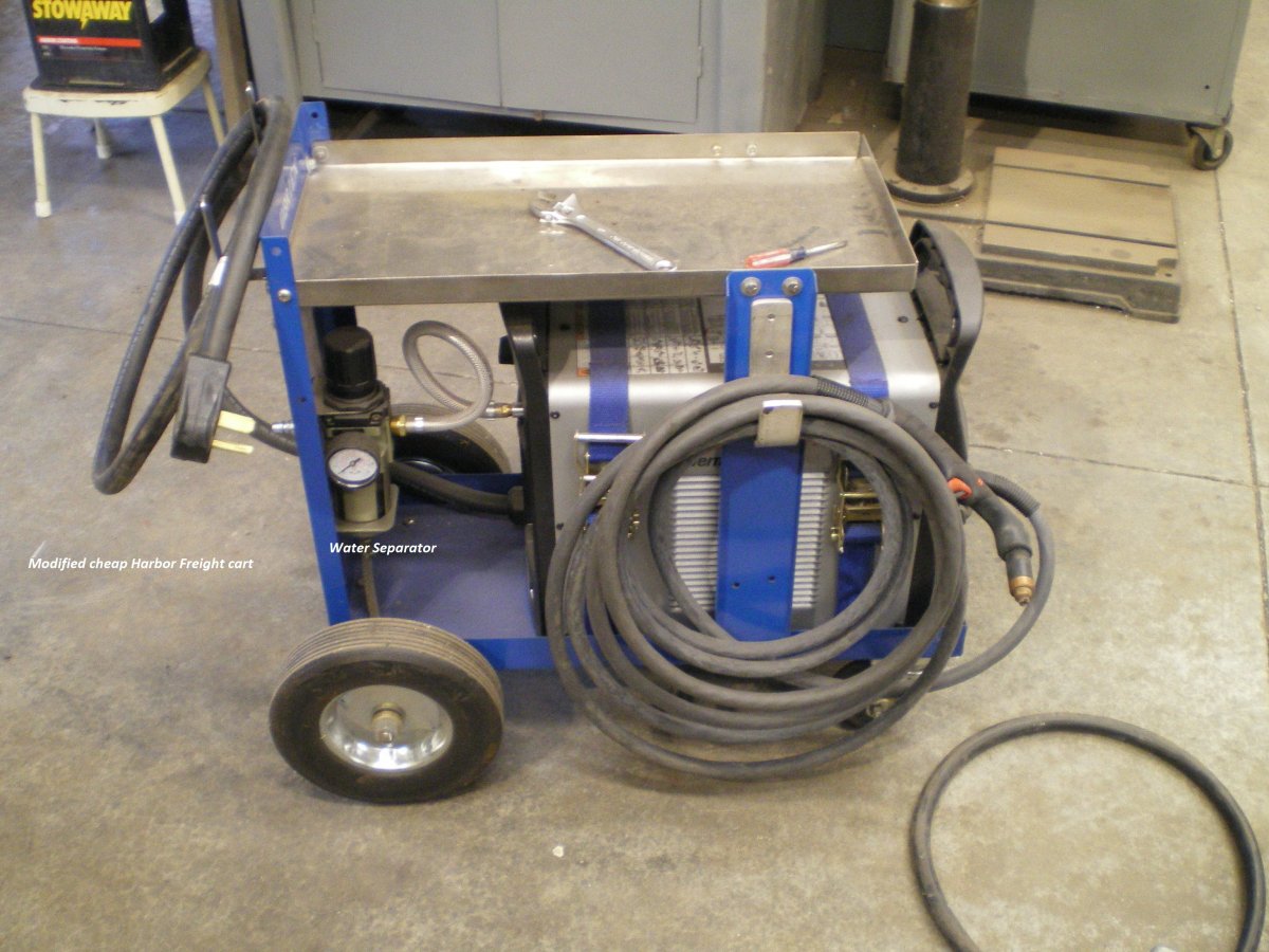

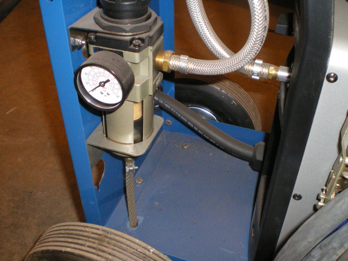

    Word to the wise: Moisture is your enemy with a plasma cutter and most air hoses have moisture....even if you have a water separator. Next time you hook up an air tool, notice the moisture that comes out while you fumble to make the connection. My suggestion is to put a dedicated (and cheap) HF water separator on the cart for your plasma cutter.

    yeah. The moisture in the line is a killer. We have a good plasma cutter at work. It worked great, until the repeated water in the lines caught up with it. Then, it was an expensive repair
  10. I have had my Cut50 for 2 years, and I have used a water separator with it from the start. I haven't had a lick of trouble with it.
    I bought it to replace a larger three phase Linde machine, capable of cutting up to 1 inch and have no regrets. I had no need for the larger machine. To keep the air dry, the Linde machine was designed to be used with nitrogen bottles. I used it with the air separator and had no problems.
    So yes, dry air is the secret to long life of a plasma cutter.
