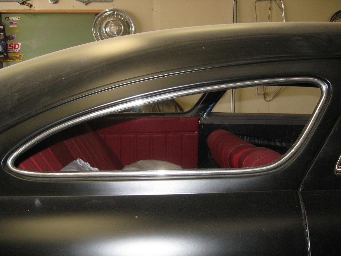

  2. I saw some on a chopped Shoebox at a local car show a few weeks ago. The only reason I noticed it is because I was looking directly at it to see what they had done to get the window trim back on...lol
    Walked by the car once and never had a clue. Let me see if I can find a pic....
  3. Crap, thought I had a close up of the trim. Here's the best one I got...

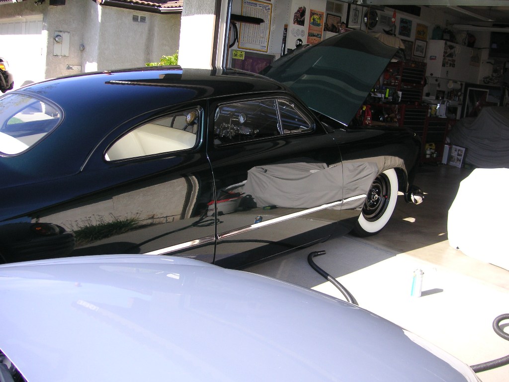

    Not a great photo but the black is acceptable
