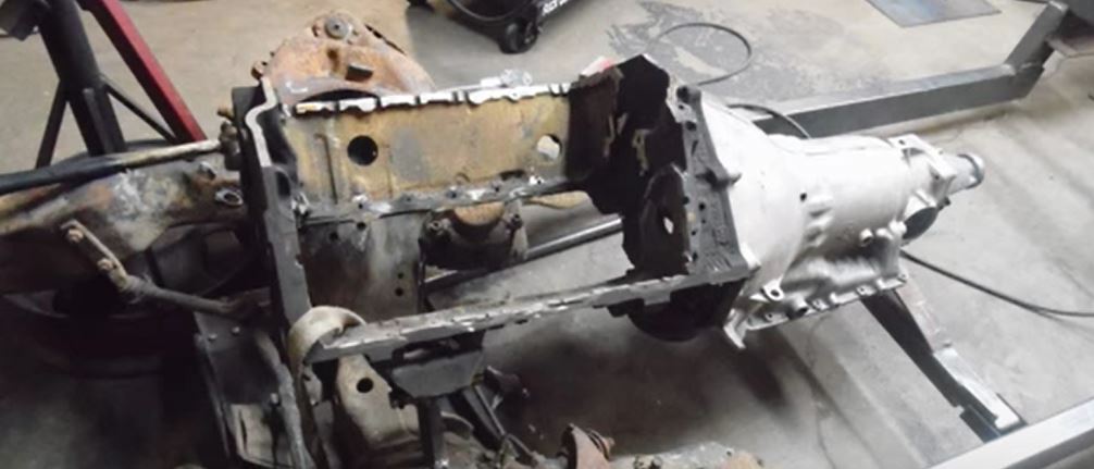

    I have a sliced up (6 cyl) block. It has the main caps and motor mount bosses. I use it A LOT.
    For oil pan and lube system mock up.
    For motor mounts in ch***is.
    For driveline alignment with the frame and rear end. frame buildup 16.jpg frame buildup 19.jpg oil pan fixture03.jpg oil pan fixture04.jpg

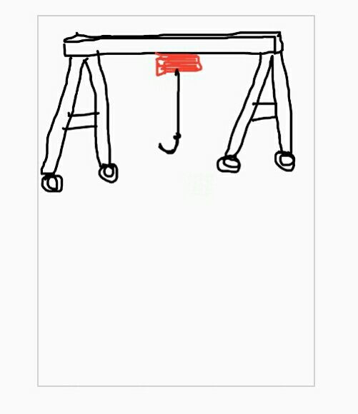

    Why not easily fabricate something like this (I used a drawing app...but you get the idea). Some 4"X4"s, couple of 2"X4"s, top could be a couple 2"X8"s together...whatever you have. Just an "A" frame like a large saw horse on casters, maybe 8ft tall. Use HF electric winch or come-a-long.[​IMG]
