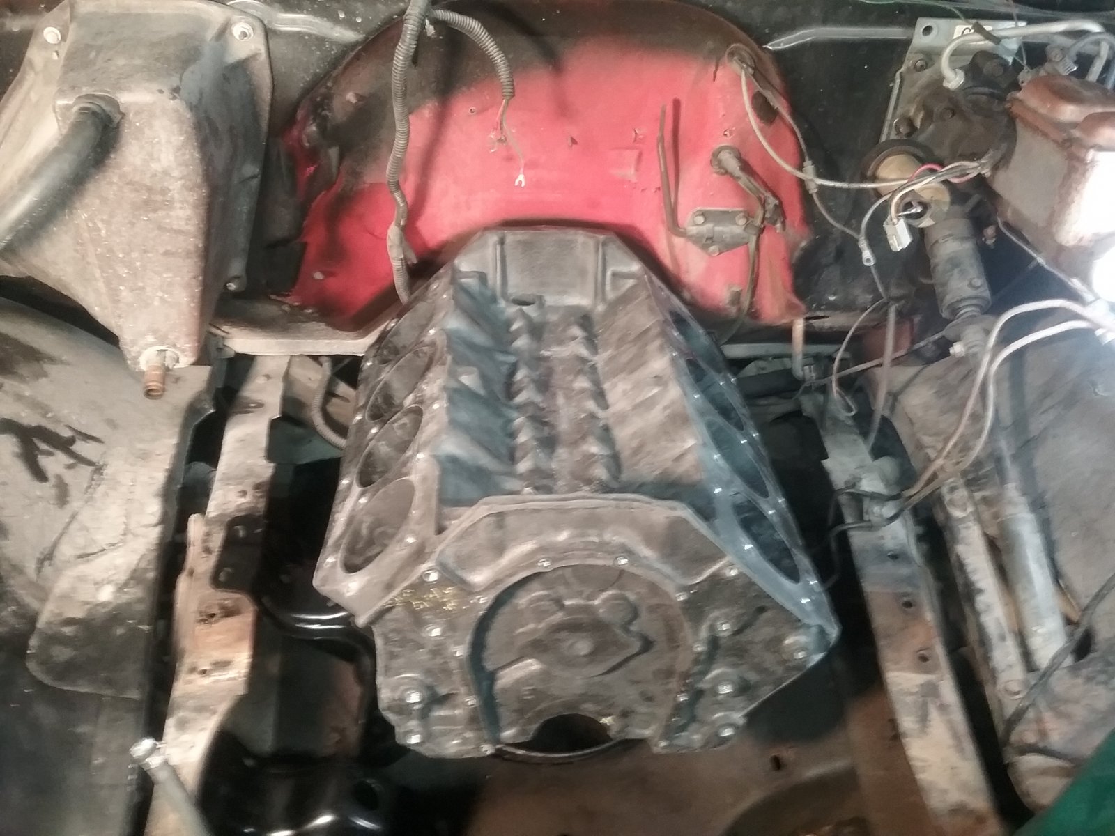

    I was thinking something along the lines of a 3-D printer to make these dummy blocks/transmissions; they don't even have to be true-to-shape/size, but it's the mounting surfaces are what's really important. Probably cost prohibitive however. When I see a display in a store/shop that is using one of these dummy blocks, I'd like "repossess" one.

    I am redoing a model A, it had a SBC,going from a automatic to a stick.Put in pedals from a noted builder,put in a plastic SBC I borrowed from a buddy that he had used many times,made sure everything cleared.Had the frame and everything powder coated. I started to ***embled the engine I am going to use, and the clutch pedal hit the brodix heads. My buddy was able to bend the clutch pedal to clear them.

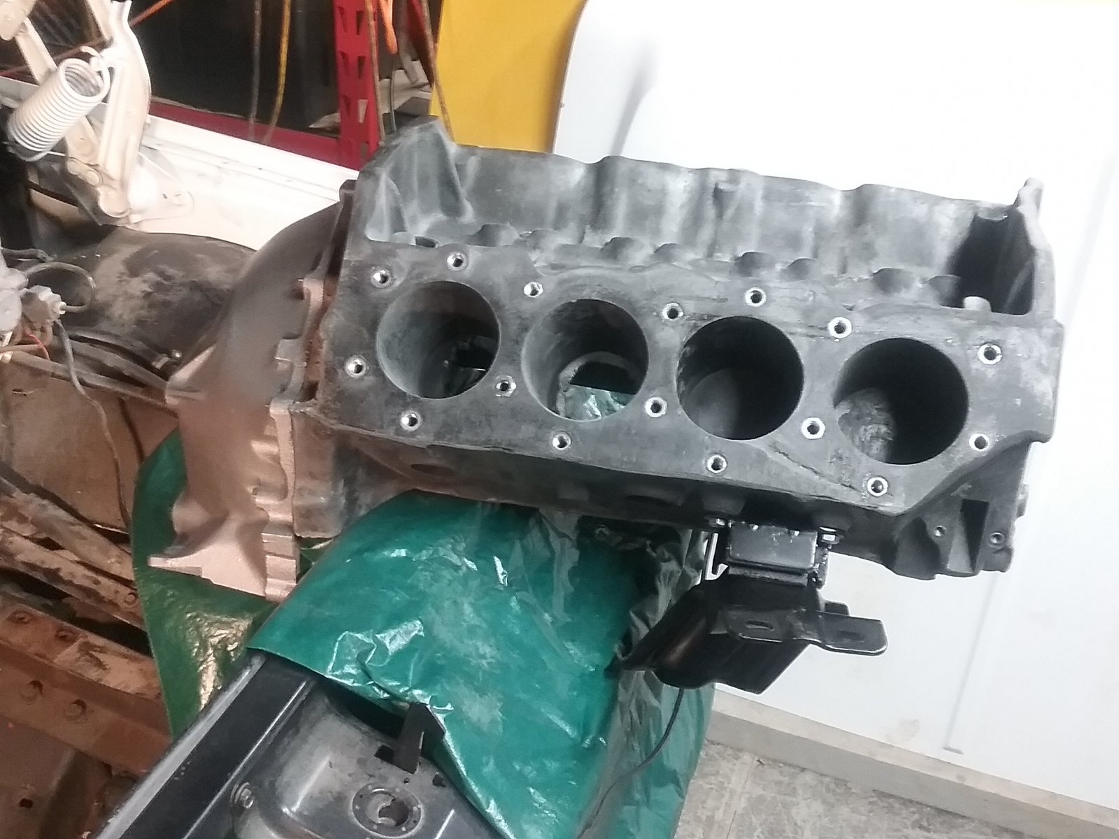

    I have 2x SBC, BBC removable heads. If you value your time $/hr..., small shop.. space claim, it pays for it self many times. My truck swap has found clearance issues, remove heads, metal shape, reinstall. Not banging my head on a cherry picker boom.

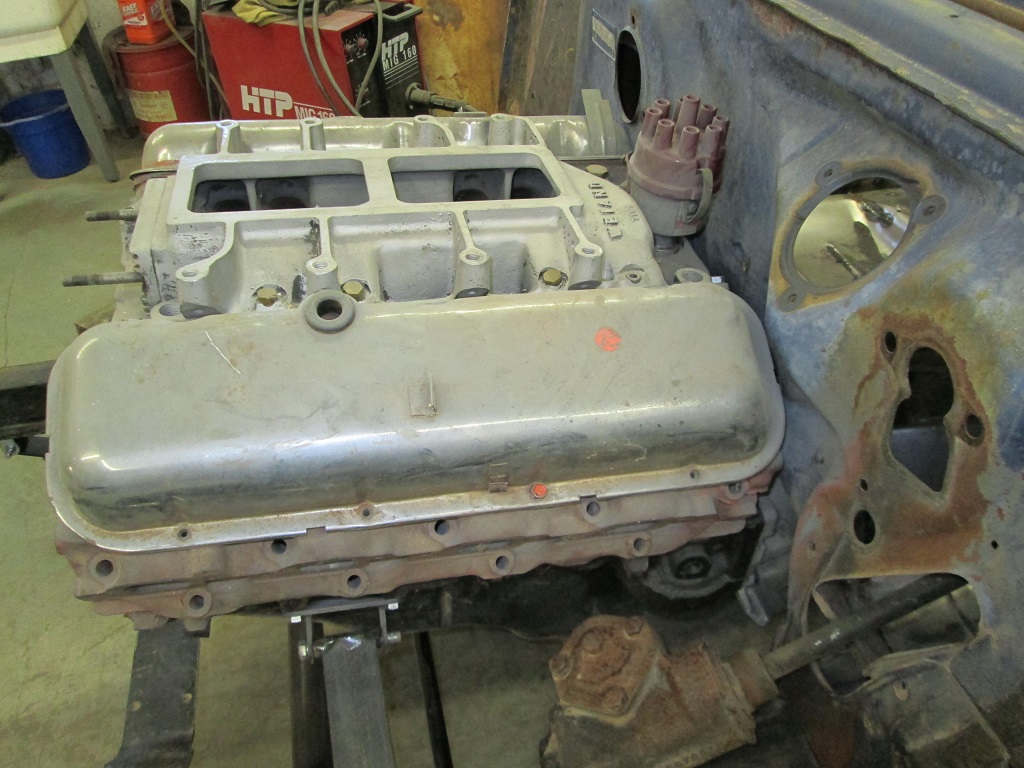

    I'd feel a bit nervous getting an engine to fit this tight with something that was not made on the same engine line as the real engine was.... :)
    (this thing had to fit extra tight to the firewall, for a few reasons)

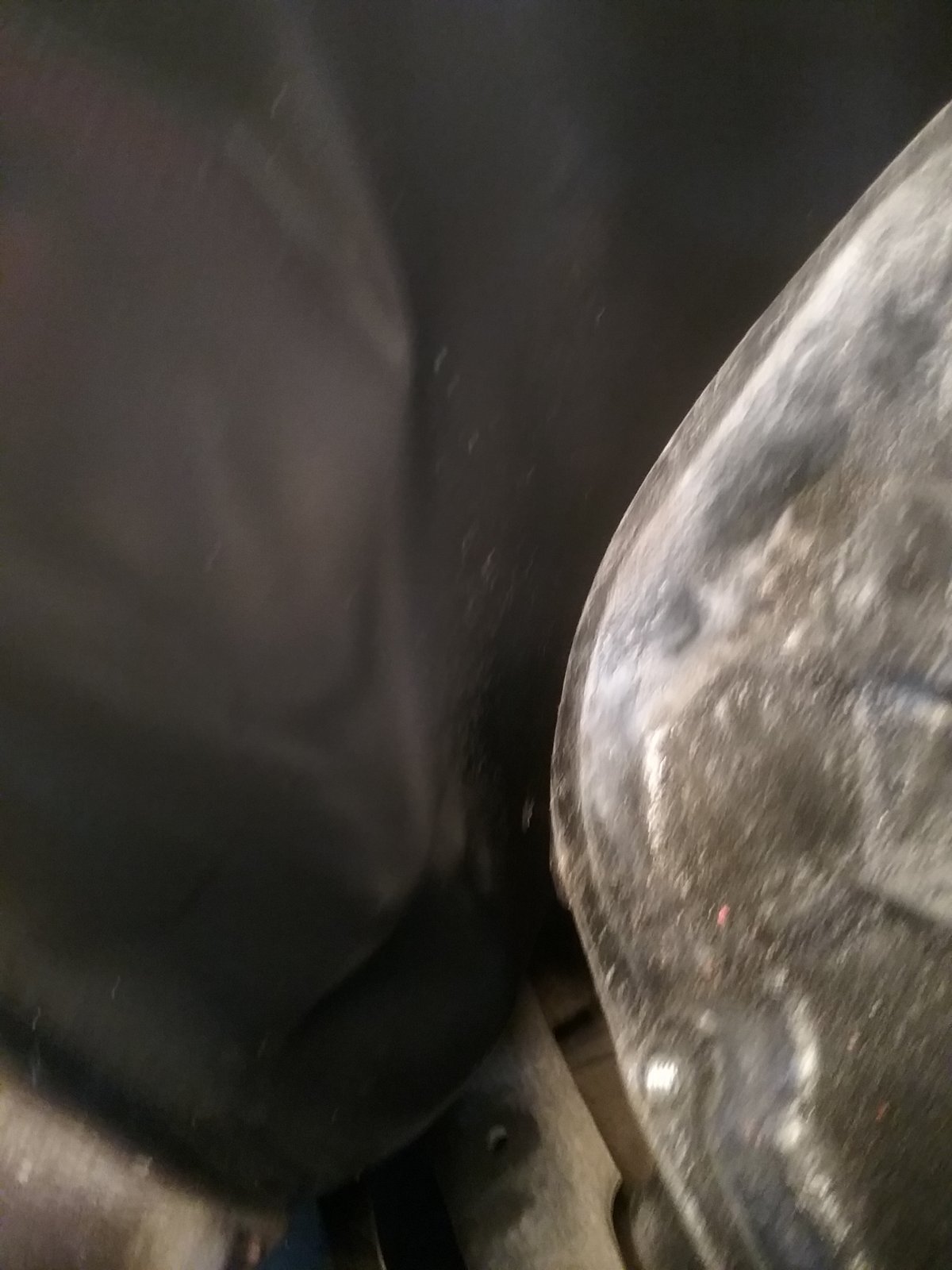

    My Truck project it super tight, I am working the firewall lightly stretching with ball pein to get clearances, little room for error. I also have to trim top side of frame C channel for ex manifolds.

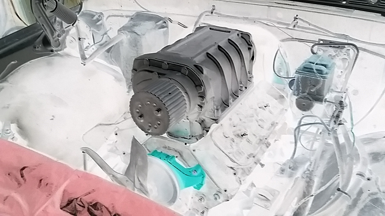

    Picked up the Plastic 6-71 blower at a swap meet..... few years back, be nice if they made Hilborn top.

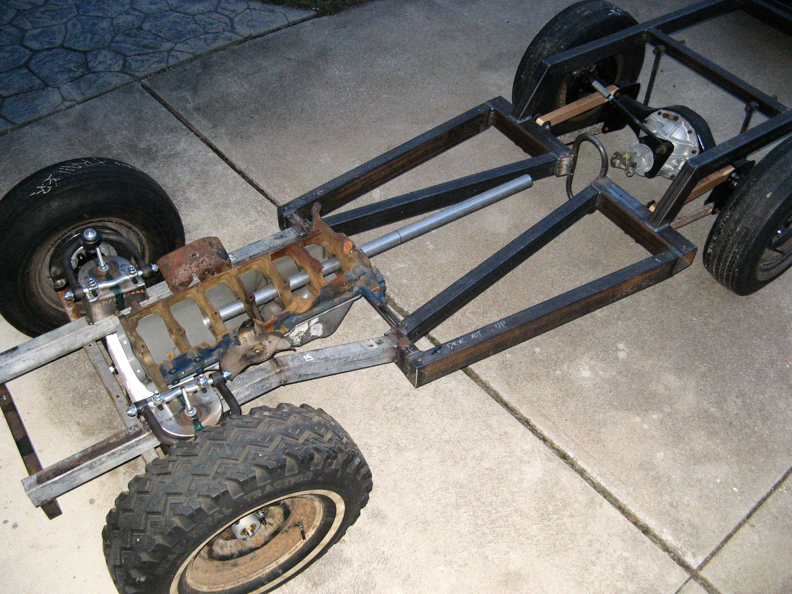

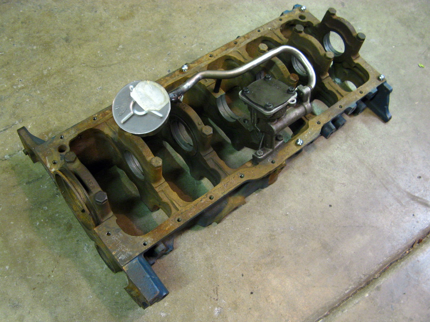

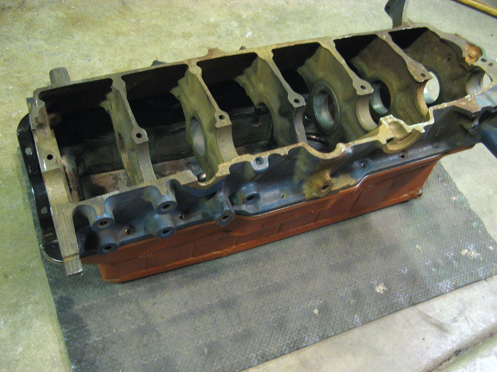

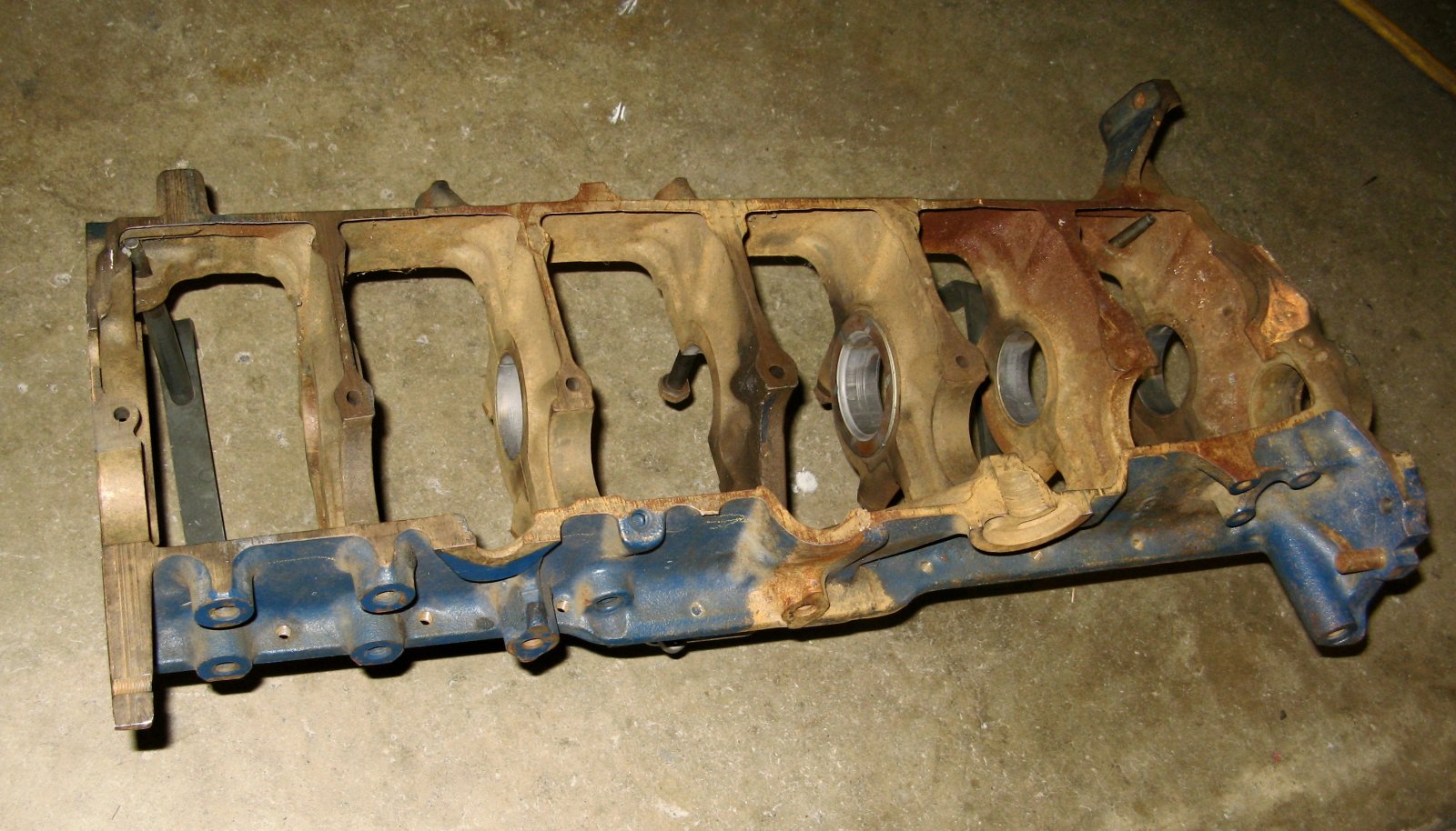

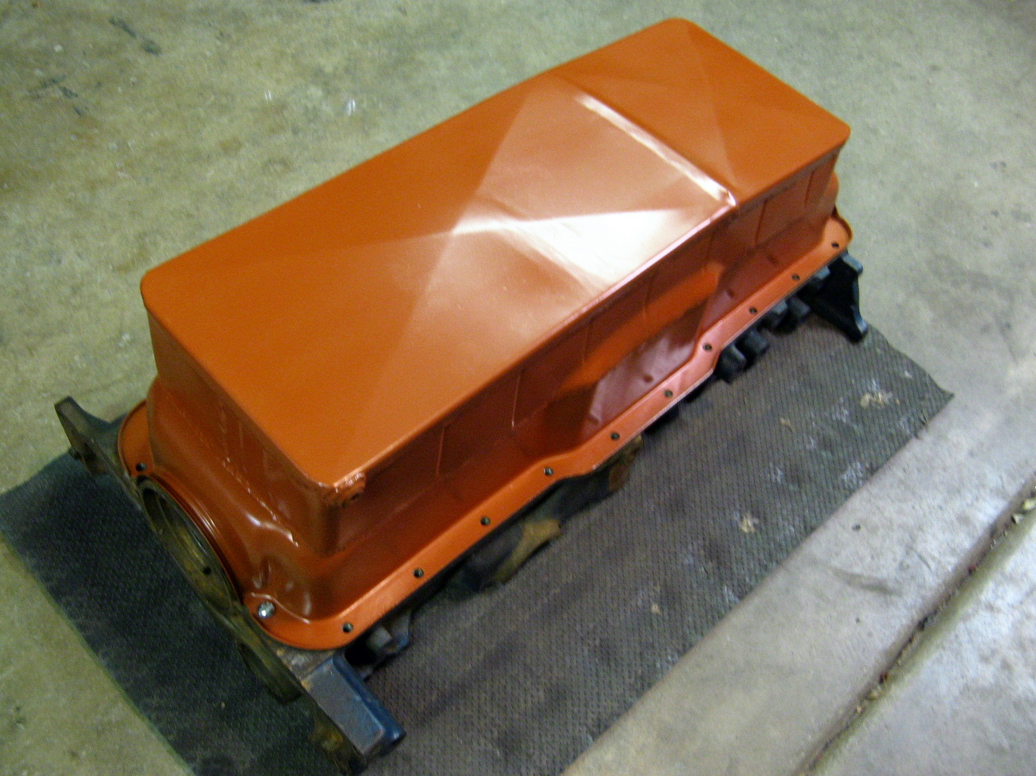

    I just whacked the bottom 3" off my six banger block. Contains motor mount bosses and main journals. In addition to fitting blocks in frames it is useful for building oil pans, oil pickups, windage trays, etc.
    oil pan fixture01.jpg oil pan fixture02.jpg oil pan fixture03.jpg oil pan fixture04.jpg frame buildup 19.jpg

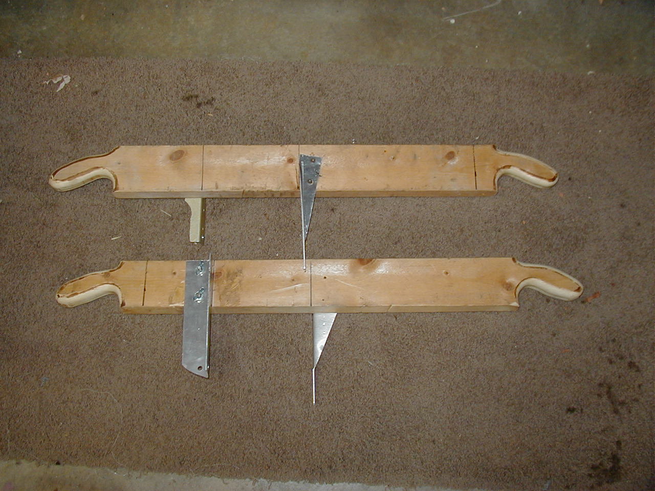

    Or...
    make a pair of lift handles and get your better half to lift it with you. Note how I biased the lifting arms so one person does the bulk of the heavy lifting.
    She never noticed she was doing most of the work LOL.

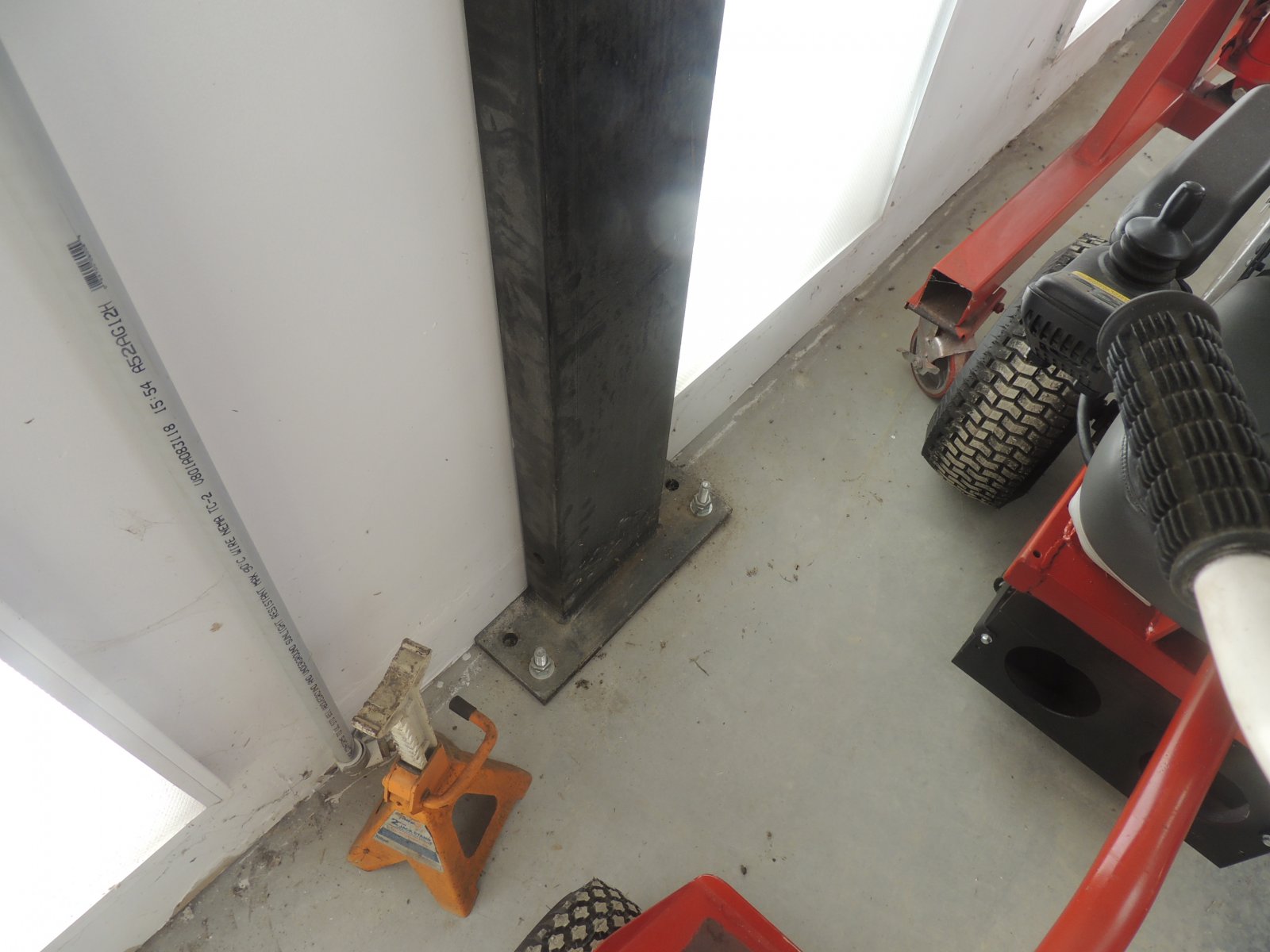

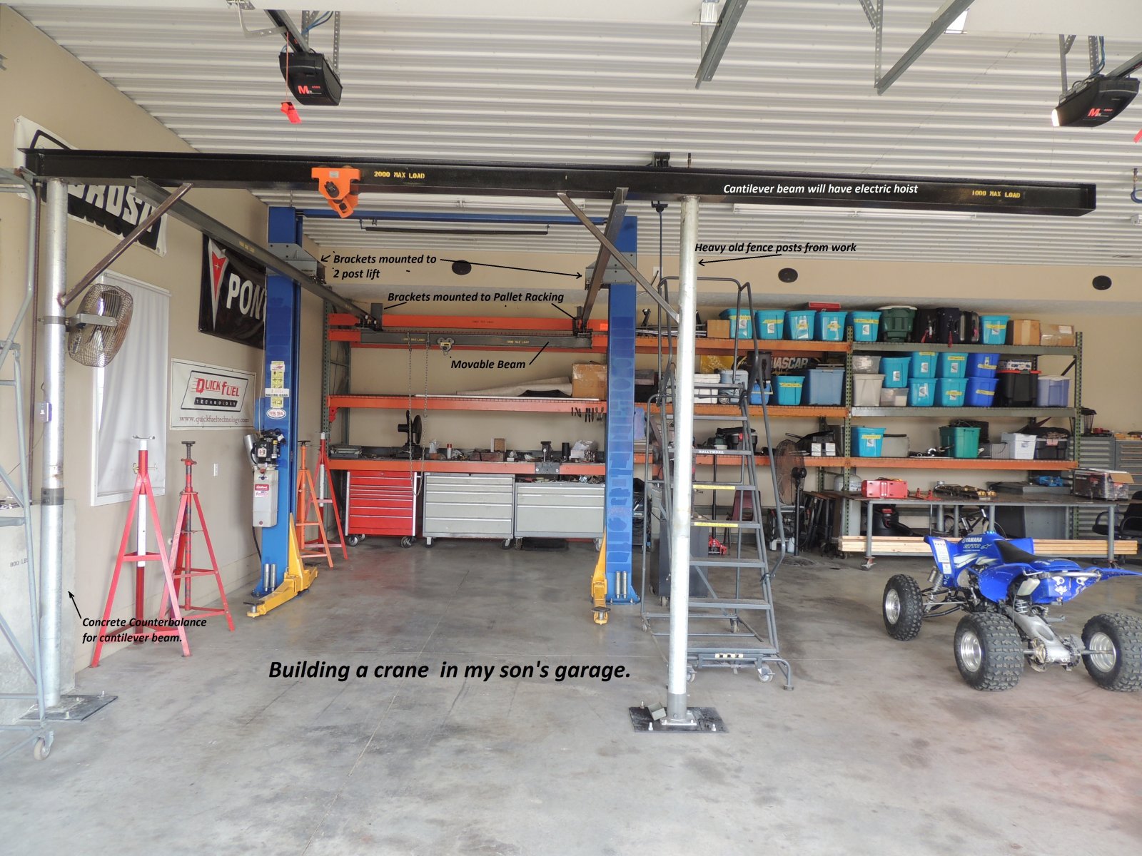

    The thing is, a simple 1 beam overhead crane takes up almost no floor space. Depending on the size of the building, and how far you have to run the overhead beam, you can get by very easily and reasonably cheaply. I LOVE overhead cranes. I use mine constantly. I know what the OP means about his back, and thats the beauty of a crane. While a plastic engine block will serve ONE purpose, a crane is constantly shows its value.......especially when it comes to lifting or having to bend to work. I have a roll around steel table that I use much more than stationary work benches. When I work on virtually anything, I raise it with the crane and sit it on the table. Modified a tubing bender last week by adding some more mounting brackets. The thing probably weighs 500+ lbs. I just hoisted it up and sat it on the table. Much easier. Engines are a breeze as well as rear ends and transmissions......even bodies and beds. Its a multi-use tool. They are easy to build although it takes a little planning to get the beam in place. What I'm trying to say to the OP is that old backs never get any better, and neither do knees. A simple crane makes all kinds of things easier .....
    I'm telling everyone that taking the time to find used beams on Craigslist or Facebook and cobbling up a crane will be one of the most useful tools in your workshop. The roll around table takes up some space but I'm telling you that having something to sit virtually any project on so you are working at waist level is great. A plastic engine block will cost as much as used I beams if you take your time finding some. Industrial auctions often yield beams cheaply too. Better to have a tool that gets used for many things than 1 thing.......and you lose almost no space.
    Note: These are all cranes that I erected at my house except the one at my son's house. I have two larger ones that aren't shown because I wanted to stick with simplicity and low costs. $500 or less and some sweat equity should yield a single beam crane

    How did you put the top of the block back on when you were done?
