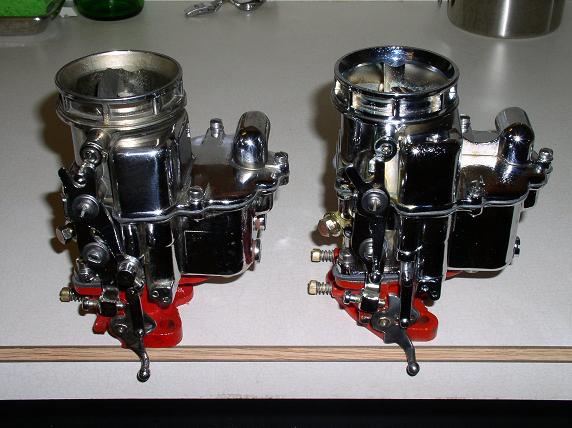

    "Will they leak after chroming? Yep...But they probably leak before chroming too!

    don't do it...they'll look like hell just like these that i'm gonna put on my flattie:D
