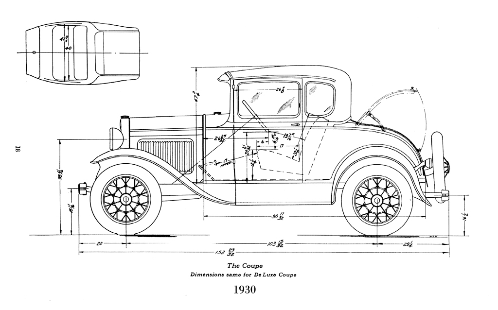

    Does anyone have a good diagram of the body with measurements??? I’ve looked all over this site and Google and can’t seem to find a good one.

    Had this one in my file fwiw

    I don't know what body you want measurements of or exactly what body measurement...there's a lot of both all over online.
    Like the one posted above there's a lot of them , here's some more examples, I believe some of the manuals or books on model a have body measurements and you can PDF down load them.....just a little bit more info needed .
    Took me 2 minutes to find these ,down load and post.

    Ya I’ve seen those online. I guess more of the horizontal measurements rather then up and down. If that makes sense. Lol

    I need more of a horizontal measurements. I thought I had a 1930. But now I think it’s earlier

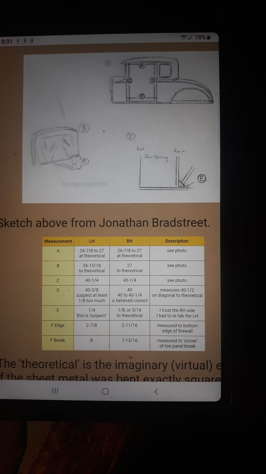

  8. rudestude
    Joined: Mar 23, 2016
    Posts: 3,048
    rudestude

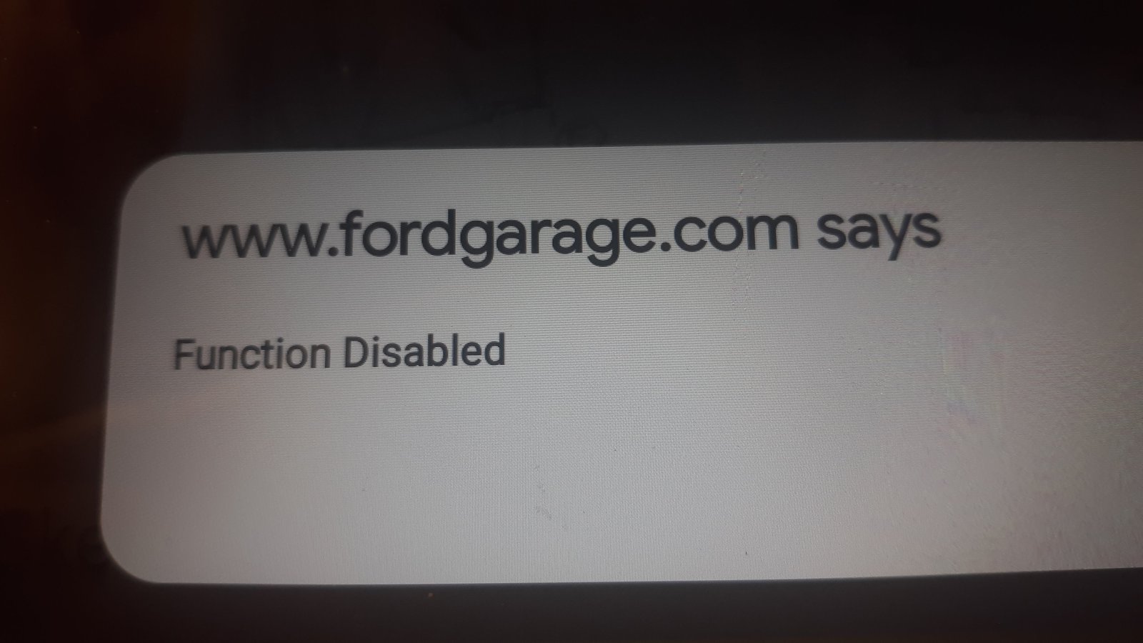

    Don't know if this will help.
    If you haven't been there already.
    Seem to have some good info and pictures of them actually taking measurements and the findings.
    They dont allow down loading apparently ...so I took pictures of there pictures. 20230129_203322.jpg 20230129_203132.jpg
