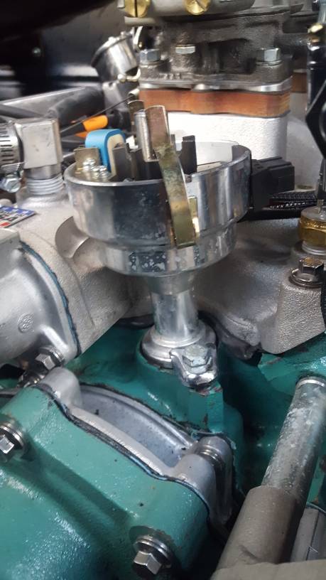

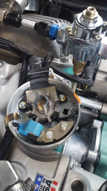

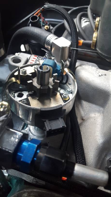

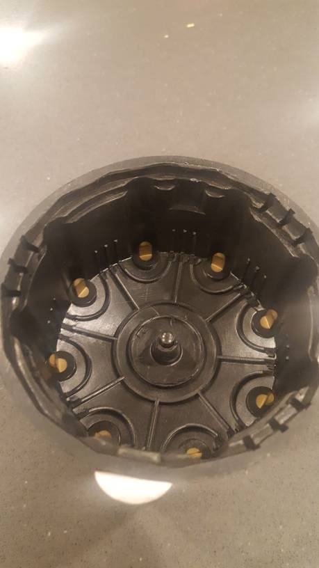

    This is in a 1974 Ford 302 engine. The distributor is an HEI with a clip-on style cap. I can find no markings, or any type of ideaing features. The magnetic pickup looks like an MSD for their Billet series but I cannot tell anything anywhere on this distributor as to what it is. The coil pin in my cap broke and I can't even find a replacement cap without knowing what the distributor is. Please help! 20180906_190957.jpeg 20180906_190950.jpeg 20180906_190859.jpeg 20180906_171158.jpeg

    post more pics of the cap itself, and the rotor.

    Looks a lot like a polished Ford Duraspark. What kind of trigger box runs it?
  4. gimpyshotrods
    Joined: May 20, 2009
    Posts: 24,391
    gimpyshotrods
    I am going to have to go with a 1974 Ford Duraspark. Look up any V8 ford from 1974.

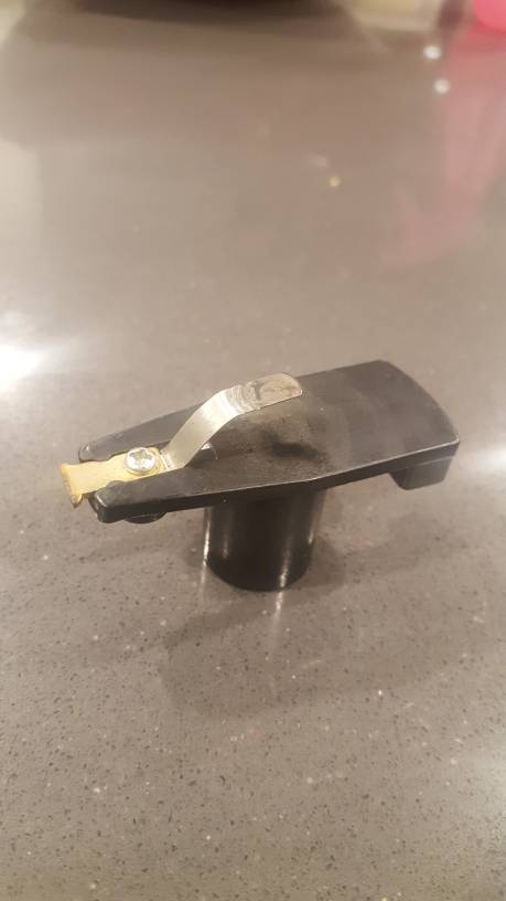

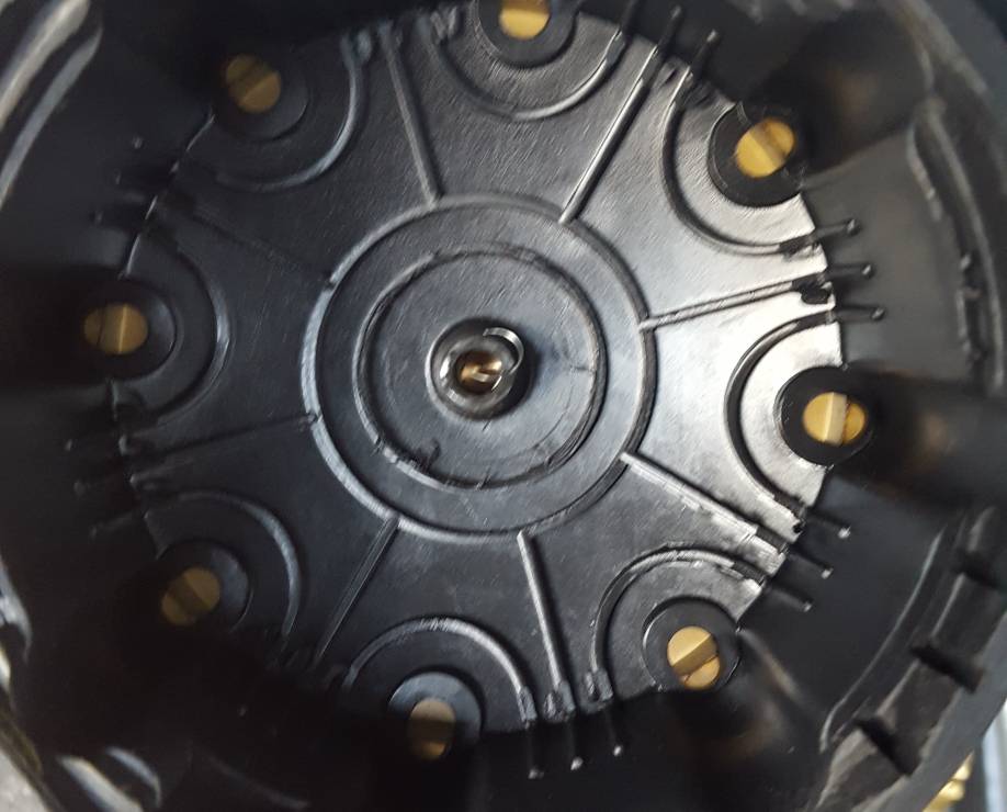

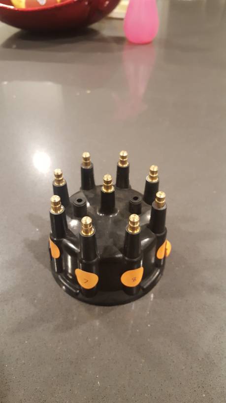

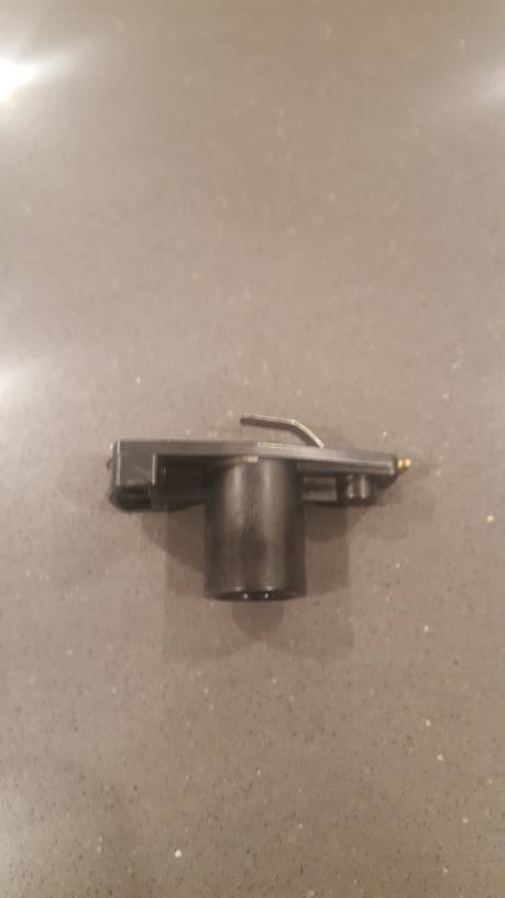

    This help? 20180906_205702.jpeg 20180906_205651.jpeg 20180906_205435.jpeg 20180906_205710.jpeg

    I don't think there is one.. its all HEI. But I fully admit I'm fairly distributor ignorant... I cant find any ID marks on any of the internal components - tho I think the magnetic pickup is an MSD.

    That rotor looks like cheap junk.... the centre carbon used to be attached to a spring, nearly any would interchange, but by the looks that stuff may not allow that.

    Looks like typical 60s 70s ford stuff with the exception of the later tower posts. Small base ford cap and rotor , but later hei style tower posts. I'm sure a standard ford clip on cap would work but you would have to change your dist wire ends..

    Now that I stare at it more, the two extra towers on the cap look like MSD-esque hold downs.
    Original MSD distributors had, in some cases, Duraspark triggers.
    You might have an early MSD unit.
    Still, I would see if a Druaspark one fits.

    Looks like a Chinese copy of a real distributor. See them a lot at swaps, plain white box, no brand.

    DING DING DING!!!!!!! We have a WINNER!!! You are correct. I just found this out this Am after contacting the guy i bought the car from. Ebay - $55.00.... :eek: i think its time to get a name brand!
  13. Mid '70s Ford Duraspark distributor with a MSD 6A box is my go-to Ford ignition. Looks just like the early point distributors (as well it should, as the basic casting is the same), lose the big cap and run the OEM Ford '57-73 type cap and rotor and you're period-correct. You can buy these pretty much anywhere.... but have proven to be nearly bulletproof.
    Pretty much all the aftermarket (both name brand and no-name) distributors use 'proprietary' caps/rotors that can be difficult to find as you now know. The single exception is the 'generic HEI' distributors being sold for non-GM applications but these look butt-ugly on a Ford motor...
