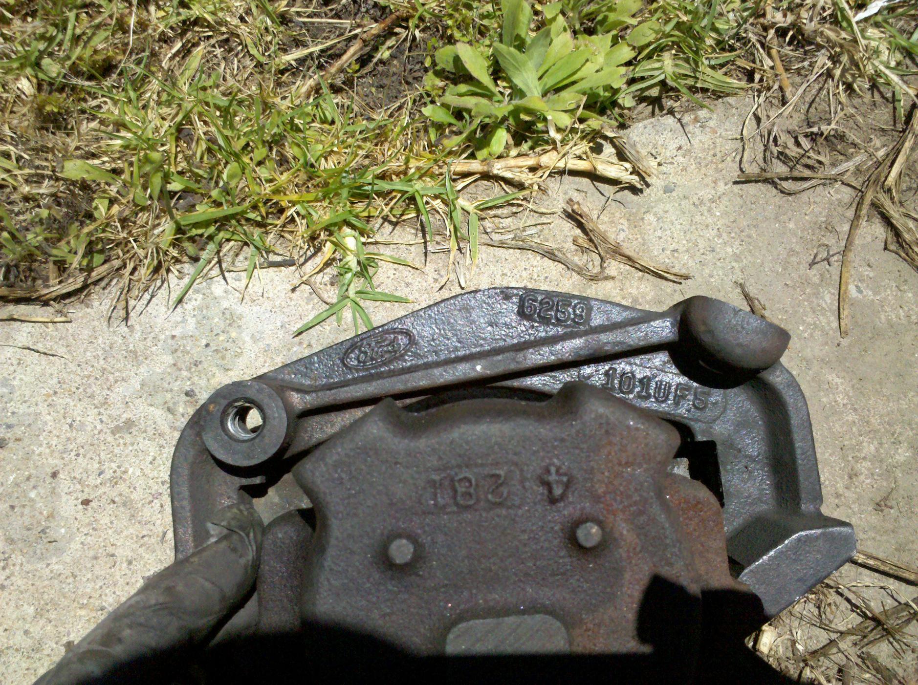

    Calipers off of my 54 Ford. Granada maybe or mustang...stamped with Ford 101UF5 Any ideas??

    Maybe Mustang 11/late Pinto Bobcat.............that's what the caliper mount looks like to me............what is the diameter of the rotor.....if it's about 9"......and especially if it's been redrilled for 5 bolt pattern, that would pretty much confirm it.......although 5 bolt 9" dia rotors are available so the re-drill thing isn't necessary to be present...the diameter will be the key.
    If the rotors are 10.75" or 11" or so, then likely granada, mustang, torino. comet etc. A competent parts house should be able to identify them.........

  3. need more info--what kind of front suspension? Modified stock? Mustang 2 ?

    Definatly mustang II. Just tell your parts guy '78 mustang II with a 5.0. They'll be about $25 a piece but don't include that caliper bracket.
