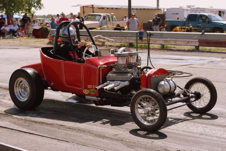

    Love all the info. I know what I'm doing is nothing new to you guys.
    I'm just wanting to do something different than I've done before.
    We have narrowed the rear 6" on each side. Going to tuck a 15" tire a little bit under the car and let the rest hang out.
    Do you think I could get away with a old style front engine dragster front end (no brakes) with the single leaf spring & some shocks/coil springs?

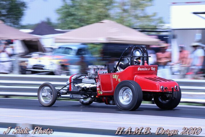

    Not to be picky or highjack the thread, but shouldn't BOTH rear wheels be on the pavement? I would think that this would cause a loss of traction.

    I think I saw this car at bowling green....... yep, and does it every time.....every time

    Haven't got any good times on this car. Been having motor problems since the start. But runs straight and true at 120. Id feel comfortable at 140-150 in it. Just start out slow and work you way up to full power. Till you get use to the car. It is a odd feeling when the front end comes off the ground for the first time.

    Not to mention cause the car to turn while on one wheel-not a good thing.

    Yep. I believe this is the pass he kissed the wall because of the launch.

    15oz coupe.. Now that's what I'm thinking!!
