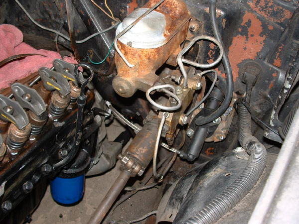

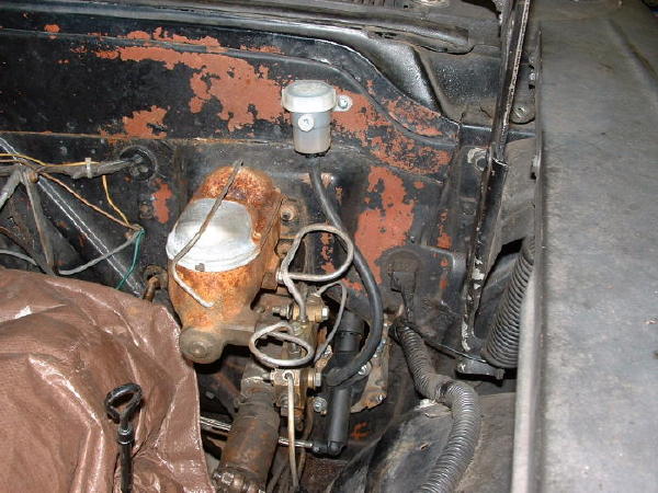

    183-700107 Camaro/Trans Am w/93-97 6-Speed w/Engines Manufactured Before 86 (2 Piece Rear Main Seal) Exc. 400/454, 153 Tooth, 35.5lbs, Steel- This is the Centerforce flywheel we used in my brothers 58 Chevy wagon.The trans we used is a T-56 from a 93 Z-28

    Yes.All stock Camaro parts,58 Chevy wagon.The only problem is that it makes the tires SMOKE:D .

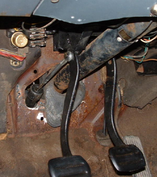

    Keisler is a good source www.keislerauto.com as mentioned above as well as www.ddperformance.com. I got my trans from them and was able to use all stock components behind a bbc. I ended up using a Lakewood scatter sheild and Ram flywheel but stock components will work. Even used the manual throwout bearing and still have the original pedals in the car. 1,800 rpm at 80mph is one way to get some gas mileage out of a bbc.
