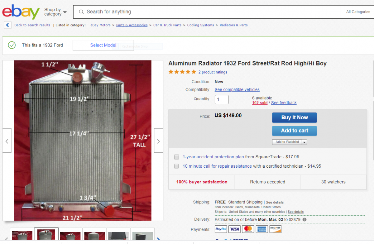

    BobPer
    I'm not affiliated with any advertisers, but this is basically what I used for a 350 Chevy engine in my 36 Dodge. Top center port and bottom right port for small block Chevy. Pay no attention to the 32 Ford application (it only translates to: they make a lot of them so they are cheap and not considered "custom"), JUST THE DIMENSIONS, just make your own brackets to marry the radiator into your grill shell if it will dimensionally fit, then cut off the brackets you don't use. If it fits it's cheap, if not, move on. Hope that helps.
