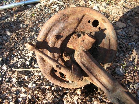

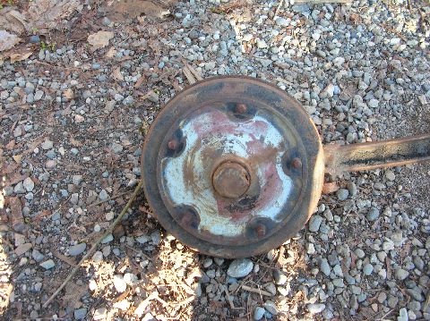

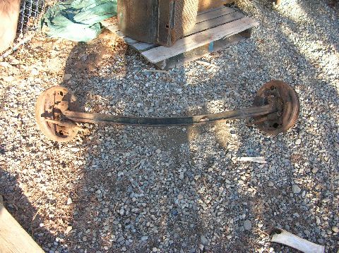

    Can someone id this front axle? I bought it at a swap meet awhile back for $20. it has a wide 5 bolt pattern and looks like it had juiced brakes. All the brake internals are missing though :confused:
    Can I use these backing plates to put juice brakes on a front beam for my 28 model A pickup?
    I'm on the hunt for a cheaper brake option for my build up then buying a repo set.
    It either this or possibly swapping some 49 chevy brakes onto a ford beam.
    Thanks
    Chris

    Model a axle... with 37-8 drums. the backing plates look like mechanical brakes though.
    You'd have to switch the backing plate spindle and drum/hub to get juice brakes...

    I have a 30 model A axle complete but looks totaly different backing plate wise and has spots on the kingpins for the linkage...thats why I thought these might be for juiced brakes.

    Looks To Me Like You Have Found An Aftermarket Juice Brake Conversion.
    The Backing Plates & Drums Look Like '36 Ford Parts, Back In The Day You Could Buy A Conversion Kit To Modifiy Your Mechanical Brake Backing Plates To Run A Juice Wheel Cylinder.
    My Buddy Just Scored A Set Of 4 Off An Old Hot Rodded '34 Ford.... Stock Backing Plates With A Conversion Kit.
    Kinda Cool Cus The Earlier Brakes Pulled The Wheel Under The Fender About An Inch Or So More Than The '39 & Later Brakes.
    Cool Find If You Run Fenders Or Are Going For A Period Perfect Early Lakes Car.
