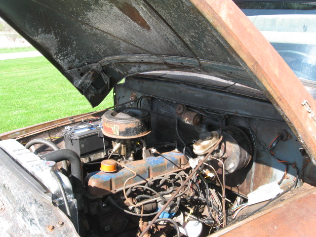

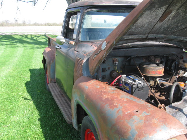

    Well, not a rod but here's a pic of mine- just a work truck.... IMG_2401.JPG IMG_2401.JPG IMG_2402.JPG
