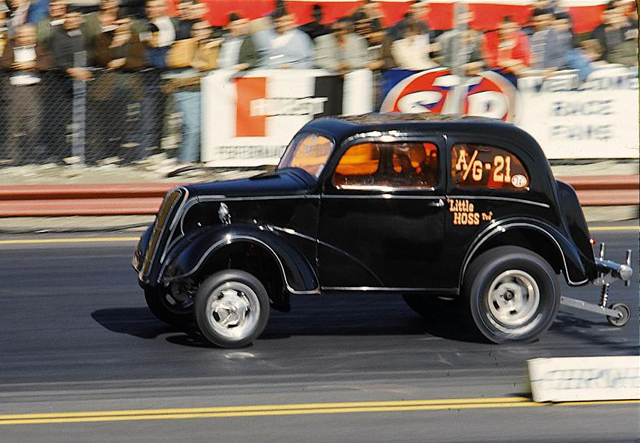

    I had plexigl*** windows in my 1937 Chevy in the 1960's....Just in the side and back windows...They even rolled up and down....They were tinted blue... high school car 37 Chevy.jpg

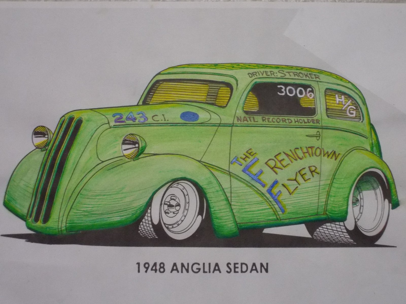

    A better material for current traditional style builds would be to use polycarbonate material such as Lexan. Plexigl*** is brittle and has a tendency to fade over time and become even more brittle. It scratches easily.
    Lexan is easy to drill, bend and keep clean. I plan to use yellow tinted Lexan on my Anglia build to simulate the plexigl*** look.
    Notice, in the old photos of examples that will get posted here, how many show how blurry the view is out of aged plexigl***.
