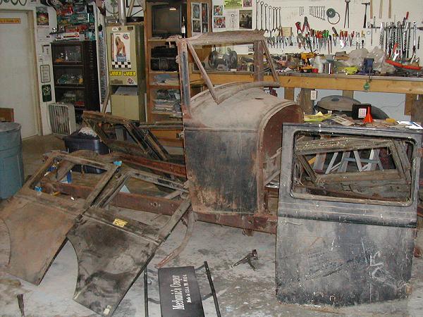

    Not really, but I decided that I would "come out" with my new "top secret" project, the "back door buddy" or more likely, the "Lunar Lander" I was gonna keep it on the DL but I get tired of hearing people bitch and moan about not being able to do this or find that. There seems to be a lot of new folks around here that did not see the build up of my first "all done by me" project that I ever attempted, the "spacetruck", so maybe I can give someone some motivation to get off their ass and get something built this winter.
    Since the spacetruck still needs interior, and I am saving up for it, I decided that I would try to see if I could build something out of a bunch of nothing for fairly cheap. I plan on using some store bought stuff like an axle setup from Speedway and I am sure some other components as I go along.
    Here is what I am starting with. I bought a 4 door model A frame, cowl, and doors off of a buddy of mine for 200 bucks. The cowl wasn't as nice as I had remembered, and the doors all turned out to be BACK DOORS as we uncovered the pile. Oh well, I am a trooper and will carry on.

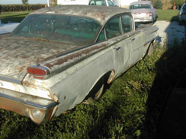

    The two full size doors are some chevy sedan doors that I had lying around that I found somewhere. I am just hacking them up for skins to fix what is missing or rusted out on what I have. My home slice yngrodder gave me a pair of slant windshield doors with the tops cut off that I will also use. The plan is to make a roadster pickup out of all of this junk. The doors will be welded shut, more of a tub actually, and it will be "Sycamore Low" out of respect for my Dawg Drew up north.
    Now the clincher, I acquired a suitable donor for the bed that was square like a model A but still had some character, a 59 Ols for 200 bucks. Man, what a pile of shit this thing is!

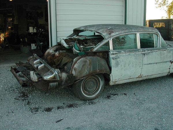

    I have already sacrificed this pig and there ain't much left. Here is day one.

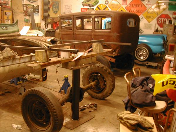

    I have got everything into the garagenow and will begin getting it all stuck together. Some of you may notice that I now have a bar in my garage if you look behind this pile of junk. I plan on using it quite a bit this winter and taking my own sweet time on this project.
    So the run down, 34 Olds grille 60 bucks (I know I paid too much but it was there) Model a cab, 59 Olds rear, and it will most likely have a 54 Olds dash. So far I am into this project for a whopping 500 dollars.

    Here is all that is left of the Olds. Check out that vintage air unit. I figured I had better take advantage of the mobile dumpster while I had it and get rid of some of the iron I no longer need.

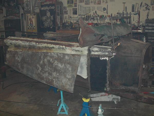

    I am stuck at work right now with not much to do so I thought I would show last night's "Progress".
    I was feeling froggy last night and a couple of buds were over so I thought I would do some hacking on my new project. Bass did a nifty illustration of it that I hope I can adhere to. I realized after cutting and moving parts aroung last night that the rear section has a lot more "taper" in it than I thought. I hope I can pull it off, otherwise I'll just have to turn it into a couch or something.
    I began by finding the center of the decklid and marking a line down the middle of the rear clip. I then did a guestimate of how much I was going to narrow the rear (24 inches at least) so I marked two lines 12 inches from the center on both sides. This will give me somewhere to measure from later if I change my mind as well.
  8. Plowboy
    Joined: Nov 8, 2002
    Posts: 4,281
    Plowboy
    I just wanted to get the loose quarters up there so I could see what I had to work with so I just did some really rough cuts between the scribed lines with a sawzall. I will make some clean cuts as soon as I figure out exactly how narrow I need to go.
    We threw the quarters up on the frame and braced them with a bunch of shit I had laying on the floor. I then took a big length of square tubing and ran it through the tailight hole all the way up to the cowl and I tacked it in place.

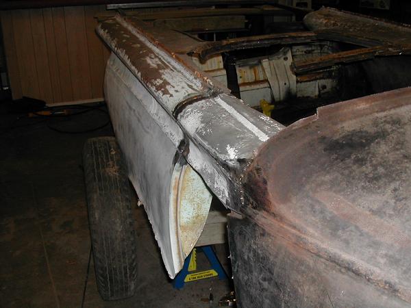

    I worked out in the garage from about 7 until 2 AM Saturday night. The body lines are going to need a little work to blend the Model A into the Olds Lines. This little 6 inch area is what I spend about 2 hours on slicing and hammering to get the contours to line up. I will reconstruct the body line down the side of the olds panels using some quarter inch rod and a little creative use of bondo.

    I spent a good portion of my Sunday afternoon cleaning out my pond. Then I went and did the other side of the cowl body line area. Cptstickfigure and Silent Lance Romance were there for moral support.
    The drivers side went a lot easier than the pass side for some reason. It just seemed to "flow" better. It actually only took about 30 minutes to do what took a couple hours on the other side. Maybe it was because I took it all back apart so I could take 6 more inches out of it because it looked too long! See, this shit doesn't always go easy, but I shall overcome. Then we went up to see my buddy Russ and drink some beer. I will make a new post on that subject.

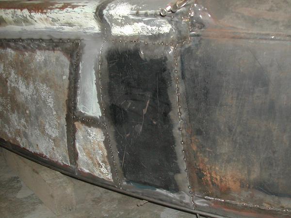

    I took some time out from being "king hoarder" and decided to work on the lunar lander friday night. I wanted to get the whole thing roughed in so I did. here is how I started the evening with the quarters tacked on. I took a cut off wheel and cut the leading edge and the panel underneath at the same time. This made a slit perfect for butt welding.
    there was a small chunk that I needed to fill in on the bottom so I cut that out of the skin of the decklid that I had narrowed. Here is my electric frankenstien. Those cheapie harbor frieght butt welding clamps are a good investment. I think they are like $4.99 for 8. They paid for themselves right here. You can see how the contour changes from top to bottom here.
    The finished product. I put it down on the floor for a visual of how it will look.
