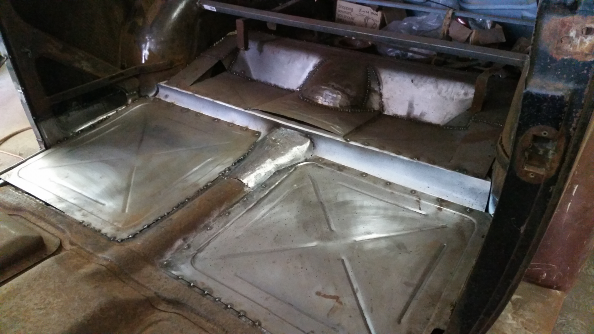

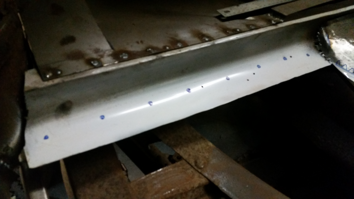

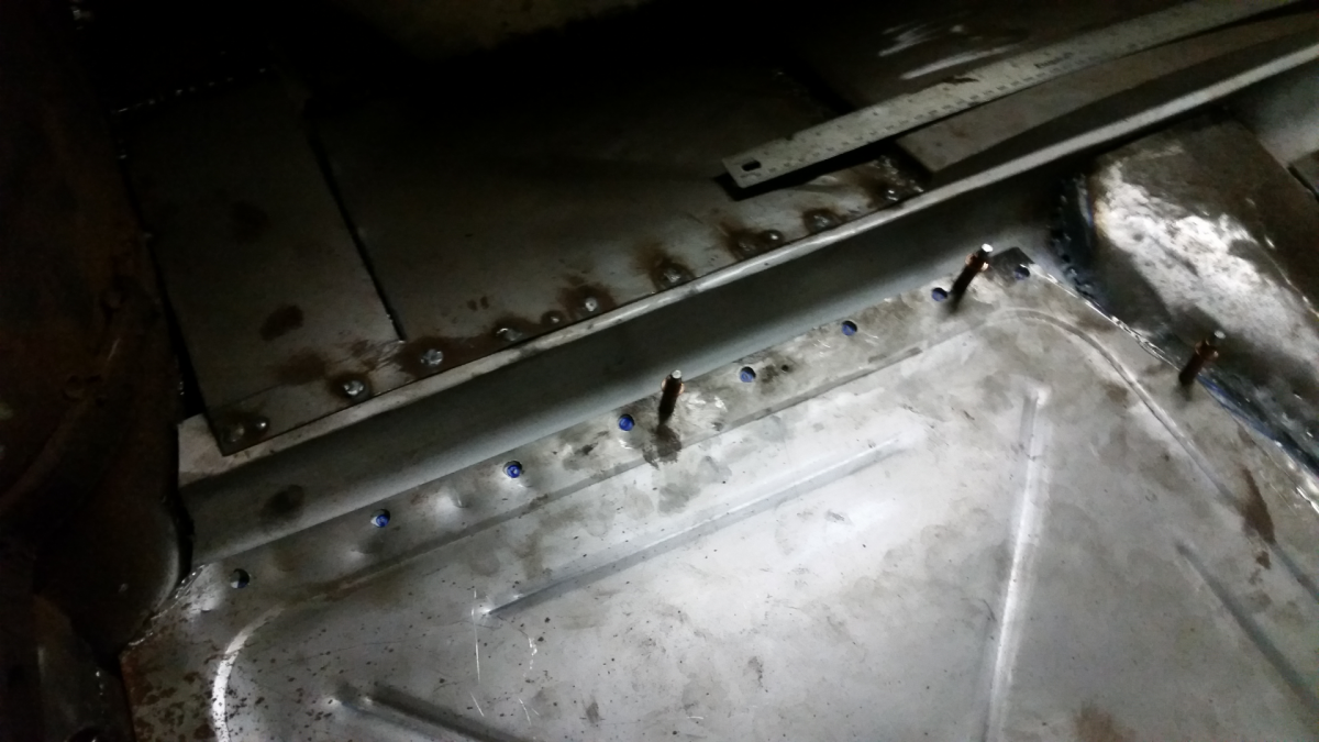

    If the area being underlapped/ plug welded to is already painted, what i do is drill the plug holes in the overlapping piece and get it lined up where its going to be welded to and mark off those spots and kiss those spots with a round die grinder bit to remove just the spot thats being welded to. Then when you line it back up, theres bare metal that can be plug welded to, kind of a poor man's spot weld. I havent really found a weld through primer that i like, so this is what i do instead. I scrounged up some old pictures from when i was doing a floor
