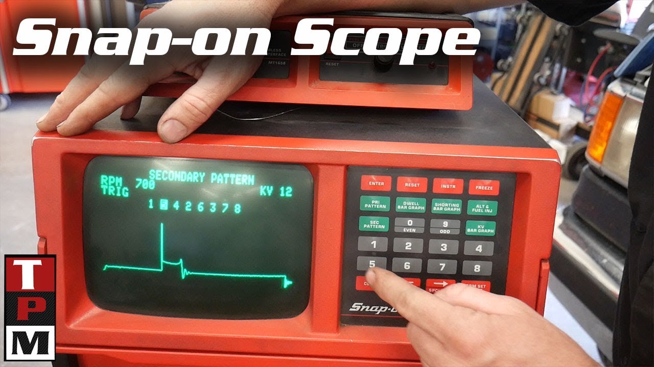

    I’ve got this guy and an old Allen tester with scope as well.
    the snap on one has all the connections for hei ignition and checking sensors etc.
    It does not get used much, but has helped us a few times with diagnosing strange issues .
    Picked up the Allen for under 100 bucks and the snap in scope for a bottle of crown royal !!
    old diagnostic tools are not worth much in the wrong hands
