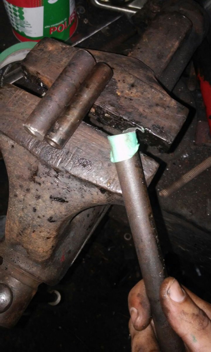

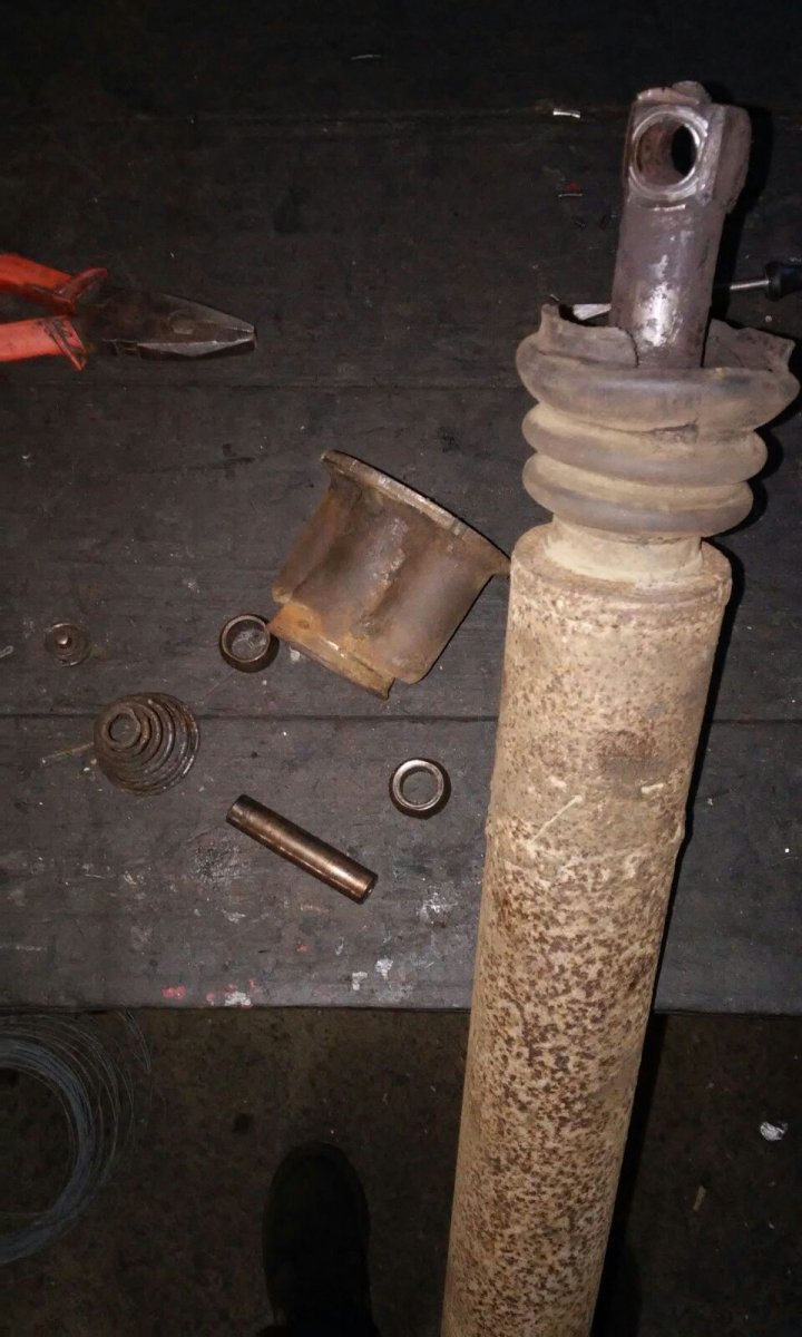

  4. Got some time to work, repaired the driveshaft, hopefully no more shaking haha... WhatsApp Image 2018-05-18 at 17.06.23.jpeg WhatsApp Image 2018-05-18 at 17.06.55.jpeg WhatsApp Image 2018-05-18 at 18.32.31.jpeg 20180518_180502.jpg WhatsApp Image 2018-05-18 at 19.01.44.jpeg

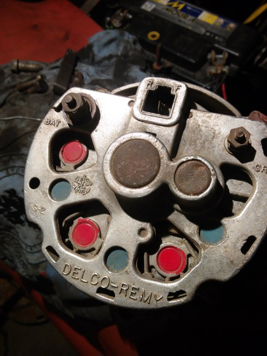

    Also I got an alternator, it's a delco remy, maybe someone knows were it comes from but I guess it will do the job. 20180518_191133.jpg 20180518_191146.jpg

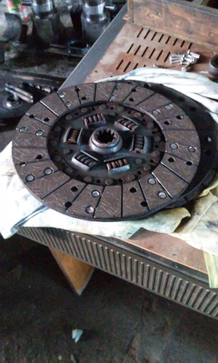

  5. I need help ! I was hoping to test the car in the streets but I'm having an issue with the clutch that I couldn't fix. The thing is that the gears grind and it's like having no clutch, tried turning the stud that goes to the fork, pedal got real heavy and still the same problem, if I put it in gear the car moves even though the clutch pedal is pressed. I took out the under cover that let's you see the clutch plate but I don't really understand how the "legs" (that's how we call it here haha) adjustment works. This are some photos of today 20180520_134722.jpg 20180520_185614.jpg
  6. Did you possibly put the clutch disc in backwards?
  7. I'm pretty sure I didn't, but maybe the new disc is thicker
  8. Finally took off the gearbox and the clutch plate, new disc was grinding the plate, I'm going to change the linings on the old one.

  11. Ready to install, new lining
