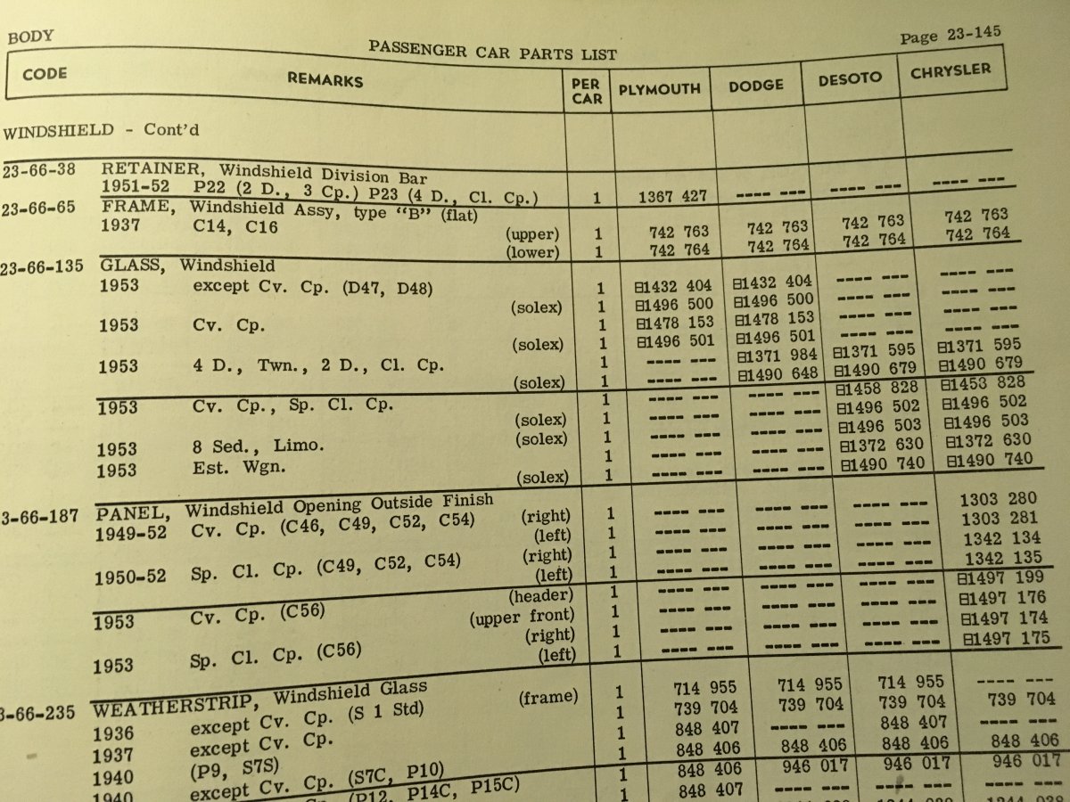

    Will a 53 Plymouth sedan front windshield fit a 53 Dodge sedan

    ‘Probably’.......but I do not know for sure at the moment. I do have a MOPAR parts book at home and will try to remember to look that up tonight and post what I find.....

    Here is a photo of the parts book....windshield group number 53-66-135
    Unfortunately, I find this confusing. What I do understand is that ‘53/‘54 Plymouth and Dodge convertibles (cv cp), 2 door hardtops and station wagons share the same basic body shells. The convertible models share the same w/s glass.
    Reading the parts listing, it appears that many other models of both Plymouth and Dodge share a a windshield part number....see the top 2 lines....I indicate the same part numbers under the headings in the columns for Ply/Dodge (line #1 is clear glass, line #2 is tinted).
    Lines 3 & 4 are convertible coupe, clear and tinted glass, part numbers. Lines 5 & 6 are exclusively for Dodge models.
    So, what it suggests to me is some models of Plymouth and Dodge, other than Conv Cpe, share the same glass part number BUT there are some Dodge models that are different than Plymouth.
    This is both frustrating and comforting to me. I have a ‘53 Dodge Diplomat Hardtop, which heretofore I thought used a convertible windshield. Not so, according to this parts listing. It appears to me the Hardtop is the same as sedan, pillar Coupe and wagon models. The ‘comfort’ is that I purchased a NOS windshield for a ‘53/‘54 without knowing for certain which model it fits. It seems that it will fit my Hardtop unless it happens to be a convertible glass, which I feel fairly certain it is not.
    Are we clear on this interchangeable question now?? :confused:
    :D Ray

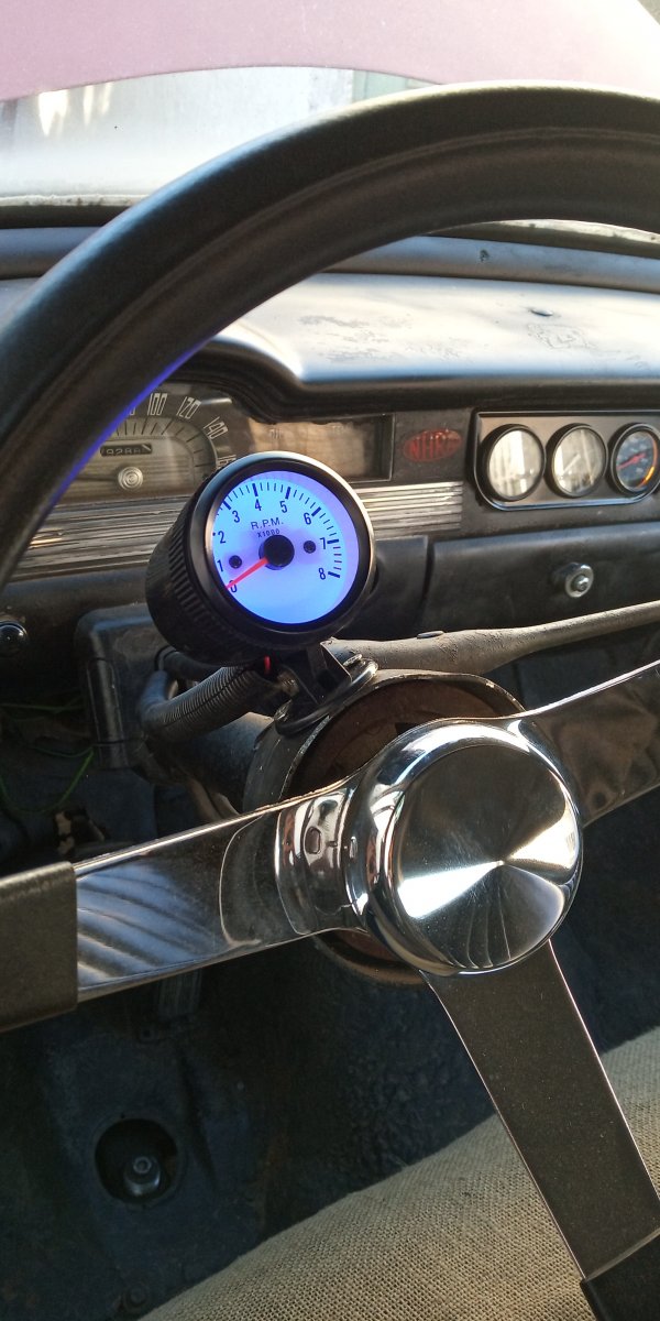

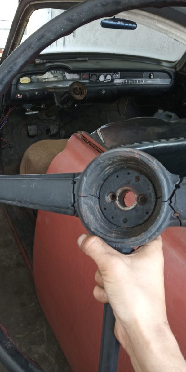

    1st, As the plymo is a wannabe hot rod I bought it a grant 832 steering wheel, now that I got it I realized that I need a wheel boss (the center with the spline), does it come out from the original steering I have or do I need a new one, do fords match?

    You need to buy a mounting kit for the Grant, they bolt onto a seperate hub. That hub goes onto your steering column shaft. The old Superior steering wheels were like that, a steering wheel and a seperate kit with hub and horn button, if I remember correctly. Your 2nd question I do not know.

  19. HUB is the word I needed to know haha ! I planned to modify a fitting hub to save some bucks, plus I didn't know which kit that grant offers is for my column :s .

    I am not certain which kit you need either, but you may be able to cut your steering wheel hub out, like you are thinking. You might be better off if you grab another old steering wheel, and cut that up instead of yours.
