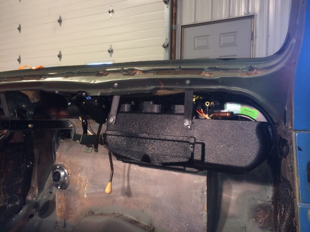

    A/C System:
    Next up was installed the heater/evaporator from Vintage Air. Had to notch the cowl on the passenger side to get the unit far enough to clear the wiper motor and cowl vent. Tight fit, but with a lot of jiggling you can clear the wiper motor, wiper linkage, and cowl vent. I cut off the cowl vent lever, tucked it in closer, and re-welded it to clear the evaporator.
    Looks pretty good with the dash on, everything seems to fit and clear OK. There is a small corner of the evaporator case visible under the far right of the passenger side. I might need to extend the dash down a bit to hide it.
  19. duke460
    Joined: Jan 7, 2009
    Posts: 192
    duke460
    from Wisconsin
    A/C Continued:
    I thought there was a lot of room but tried to get the 2 defroster hoses and 3 A/C hoses attached. Had to take everything apart and put the hoses on, then squeeze it back in. I cut vents in the dash outside corners, using the 40 Ford Ash Tray Vents. There won't be a speaker in the dash so built a hidden vent behind the speaker grill.
    Heater, A/C, Cowl Vent, lots of hoses and it all fit.

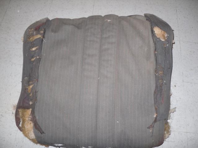

    Well it has been pretty cold here in Wisconsin so hard to work outside. Propane prices have over doubled and can't even get it to heat the garage.
    Decided to start sewing he seats. Seems that they picked up a few travelers, the mice made nests in the seat bottom spring pockets. Had quite a bit of target practice until I got them all.
    Normal horse hair and burlap construction over springs. Took it all apart, cleaned the rust off the springs and them painted them to keep rust from creeping through the fabric. Started off with dense 40# foam, them cotton 1 seat start (640x480).jpg
    4 cleaned and painted back SDC11226 (640x480).jpg batting to give it some of the old car "couch" feel.
